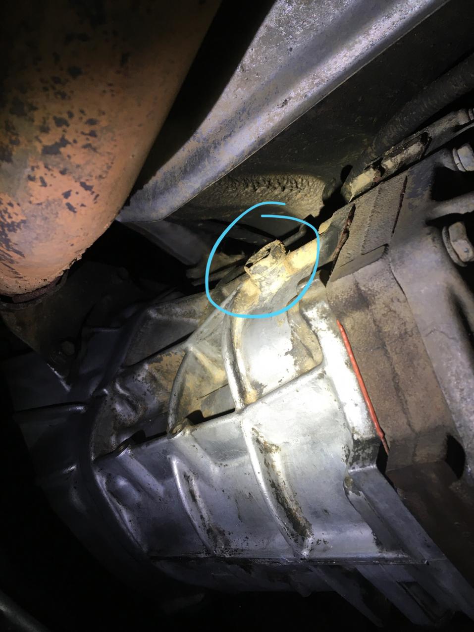

Hey I know this is unrelated to this specific thread but the site won't let me post yet because I don't have enough responses posted so - I haven't been able to check the transmission fluid on my 1995 4x4 manual 4runner with the 3L V6 because I don't know where the fill plug is or what it looks like. I haven't found anything on the internet about these transmissions; can anything tell me what this plug looks like and where it's located?
24mm on the driver's side. Not the hex key on the passenger side.
You likely have the R150F transmission unless someone changed it on you.
Toyota truck transmission identification – Core Shifters
