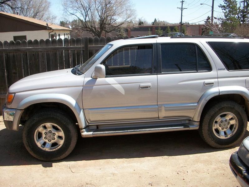

Please check a couple of posts above, I posted a pic of the rims... I don't think mine are split tri star... Is the one below the split tri star? Sorry I don't know the terminology... Being a noob and all...
That's my 4runner!! When it was stock!!
