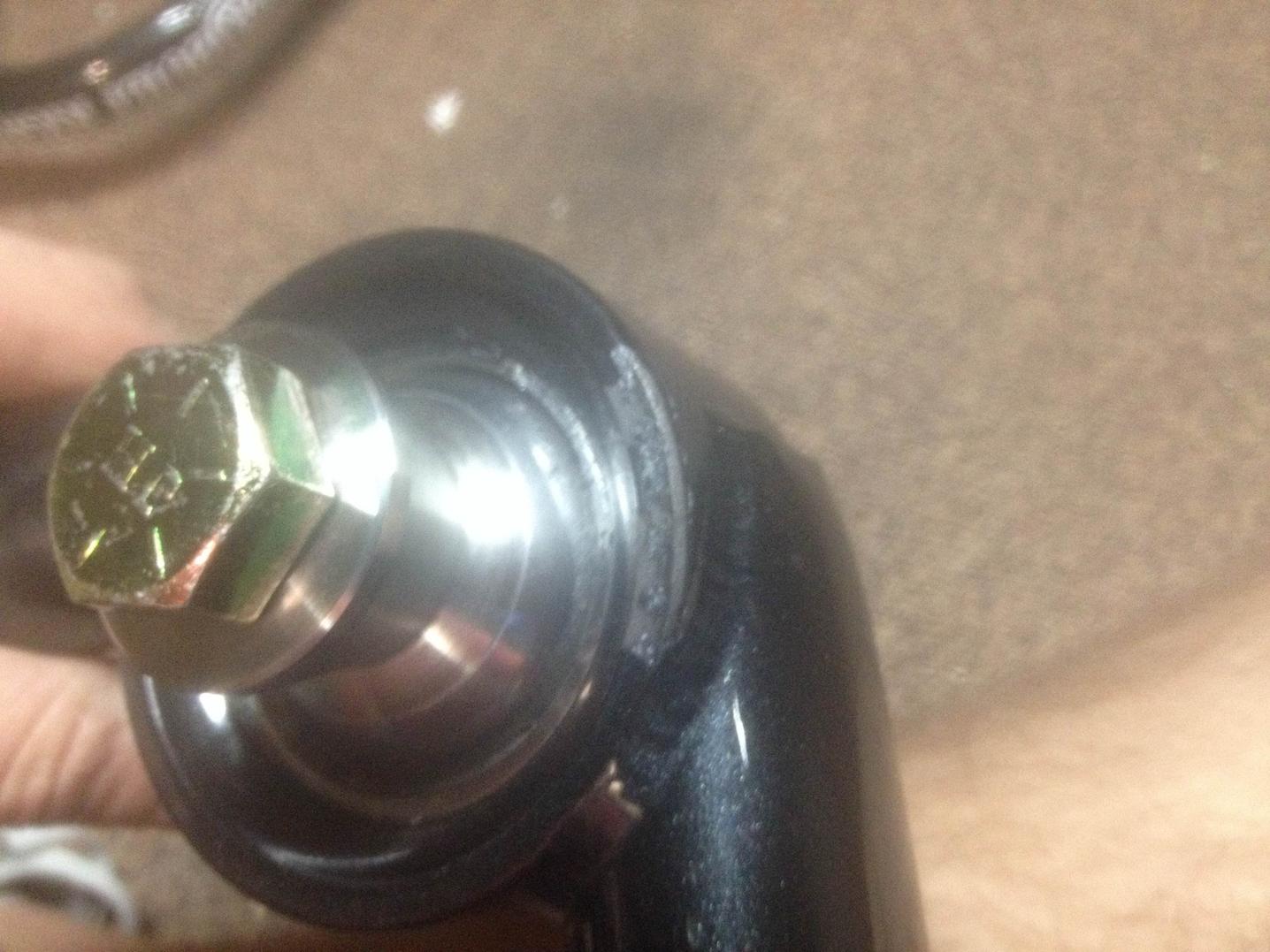

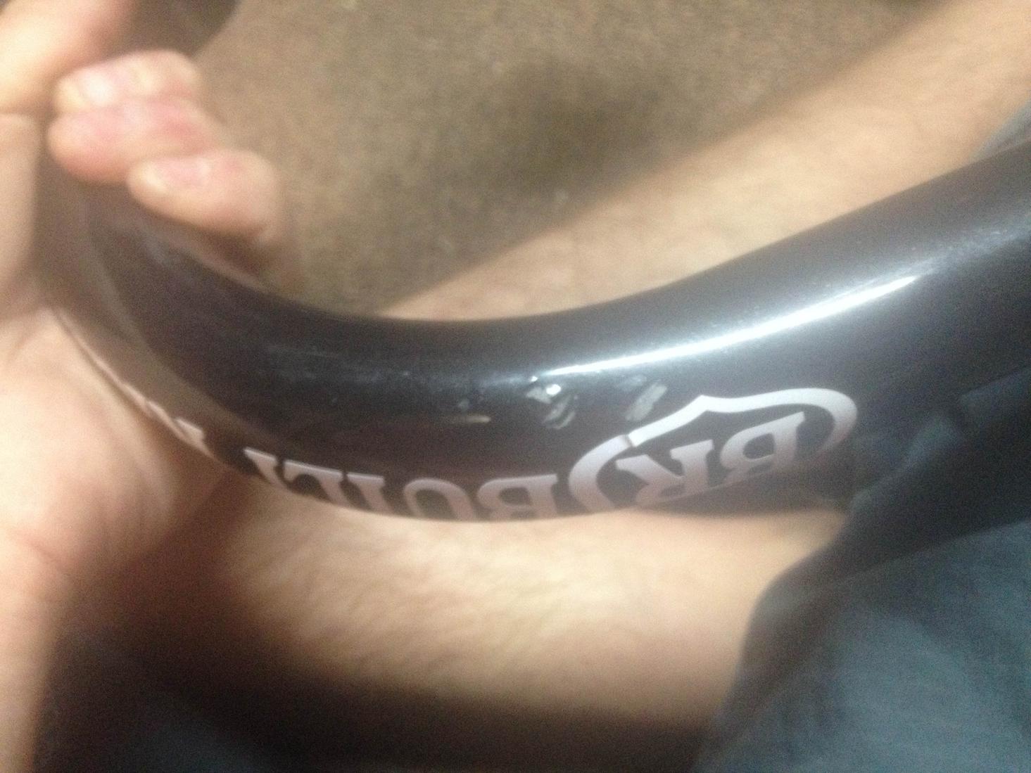

Mine are not real bad.

Is it visible from the street or not visible. that sucks though. whomever is doing the packaging needs to get it together.
Be sure to give them your feedback directly.

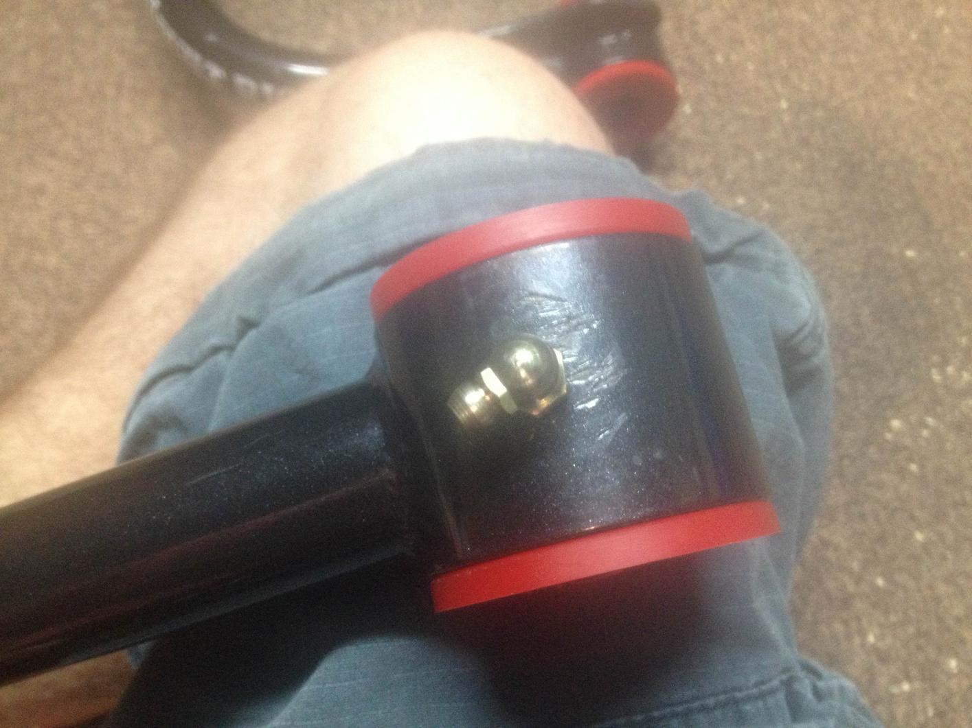

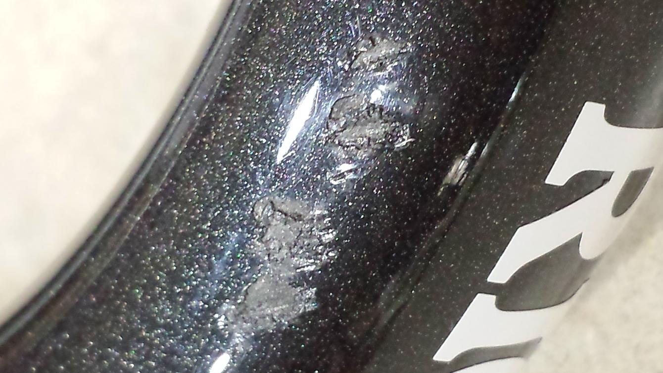

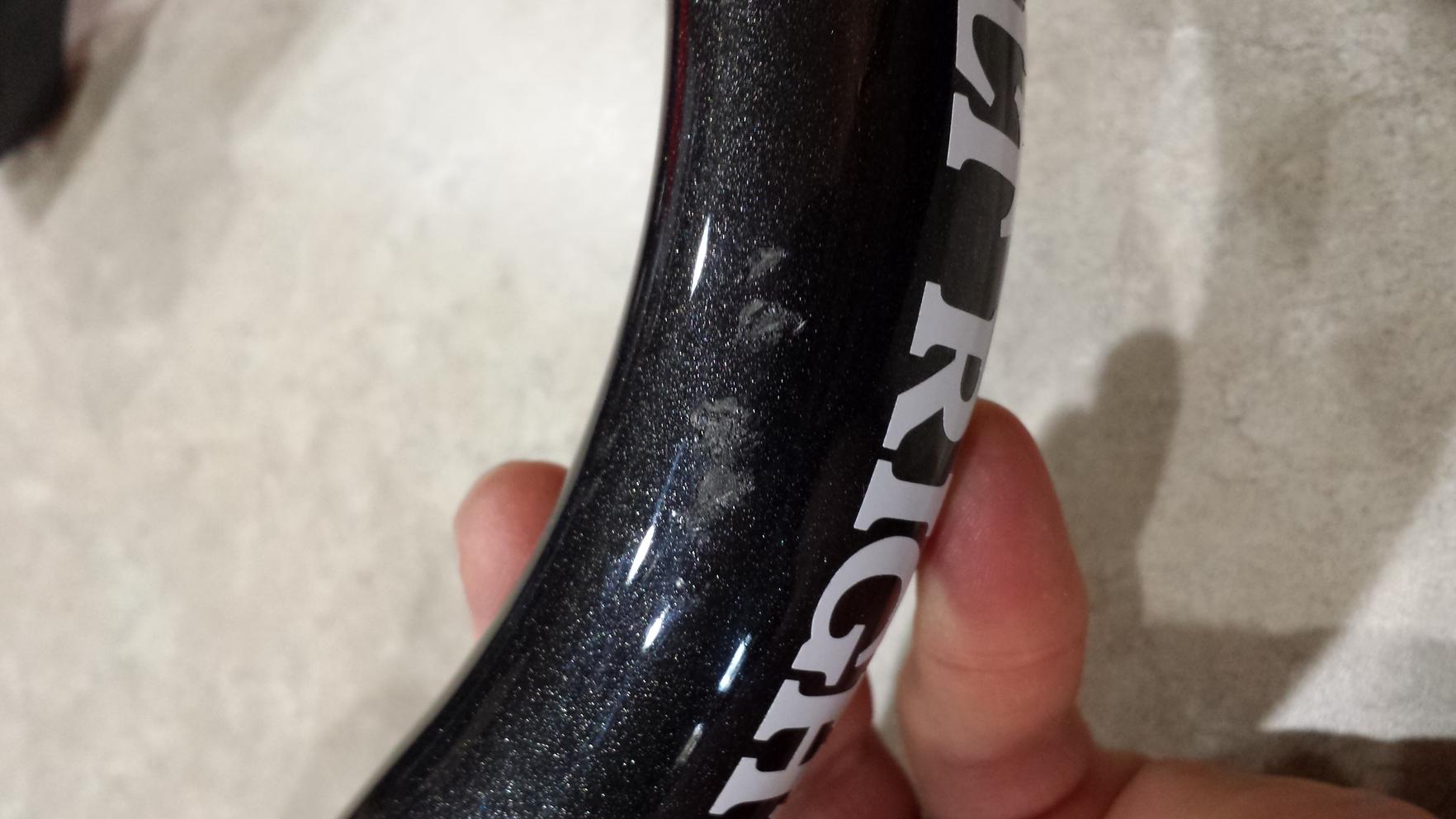

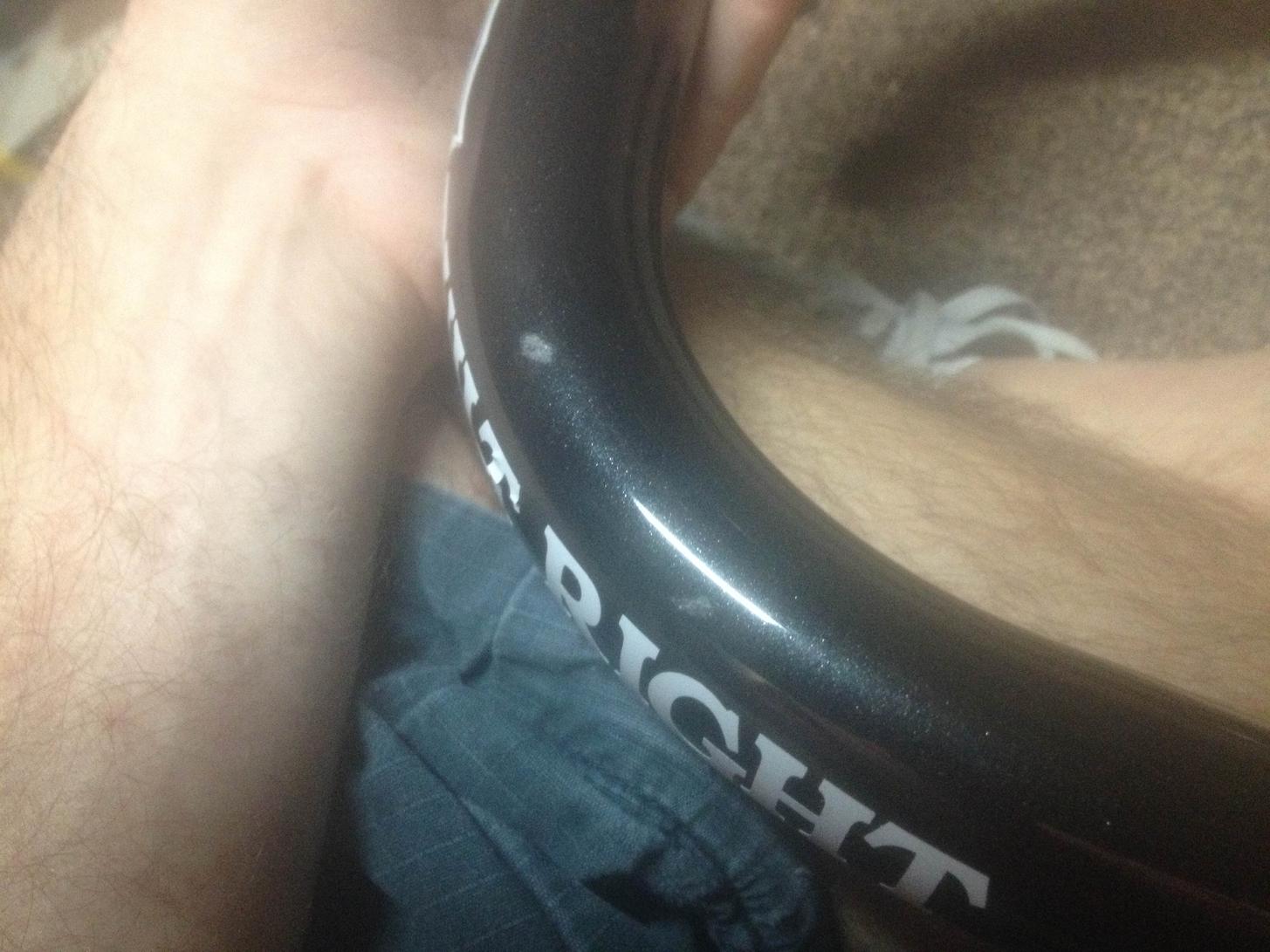

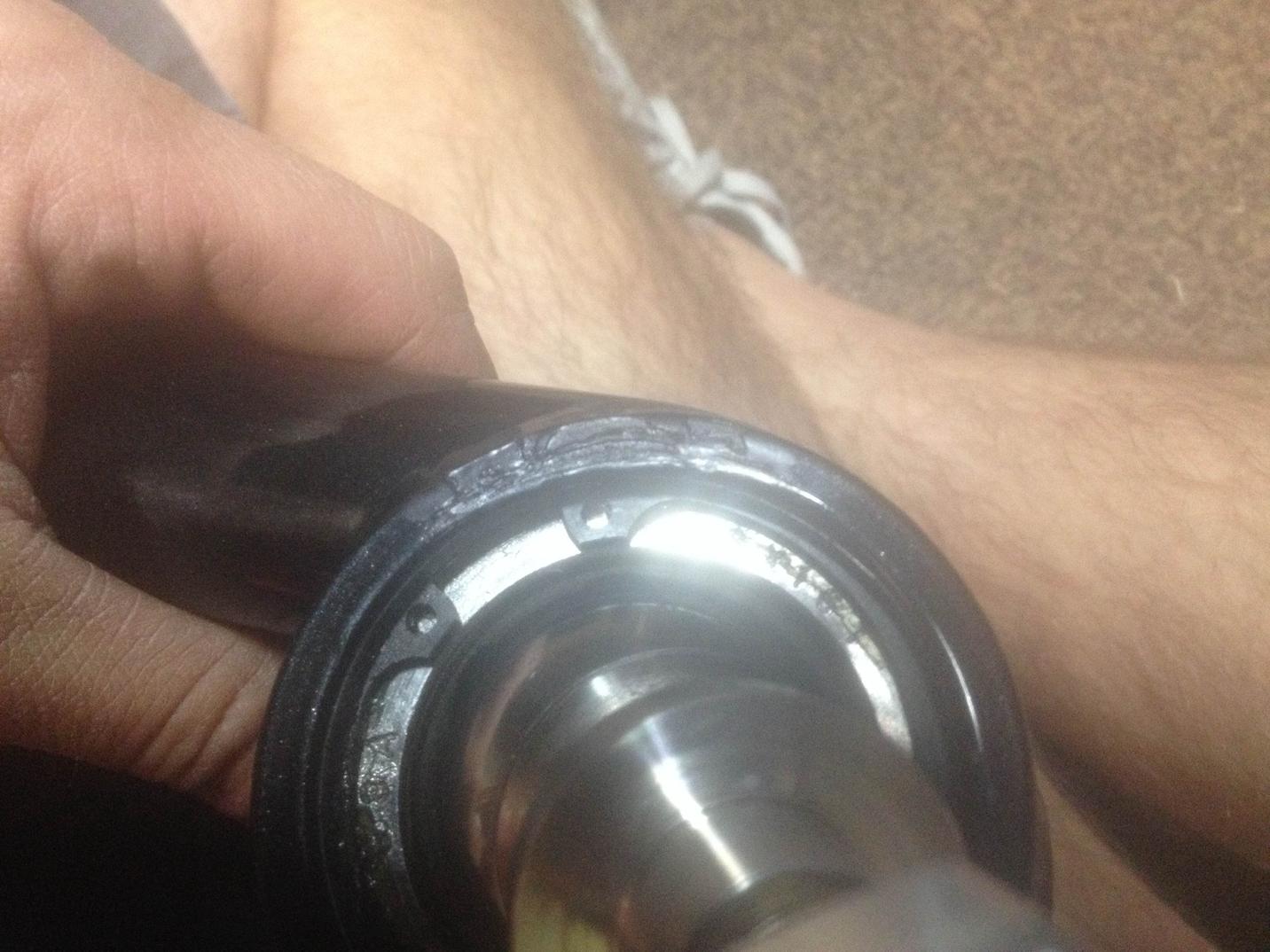

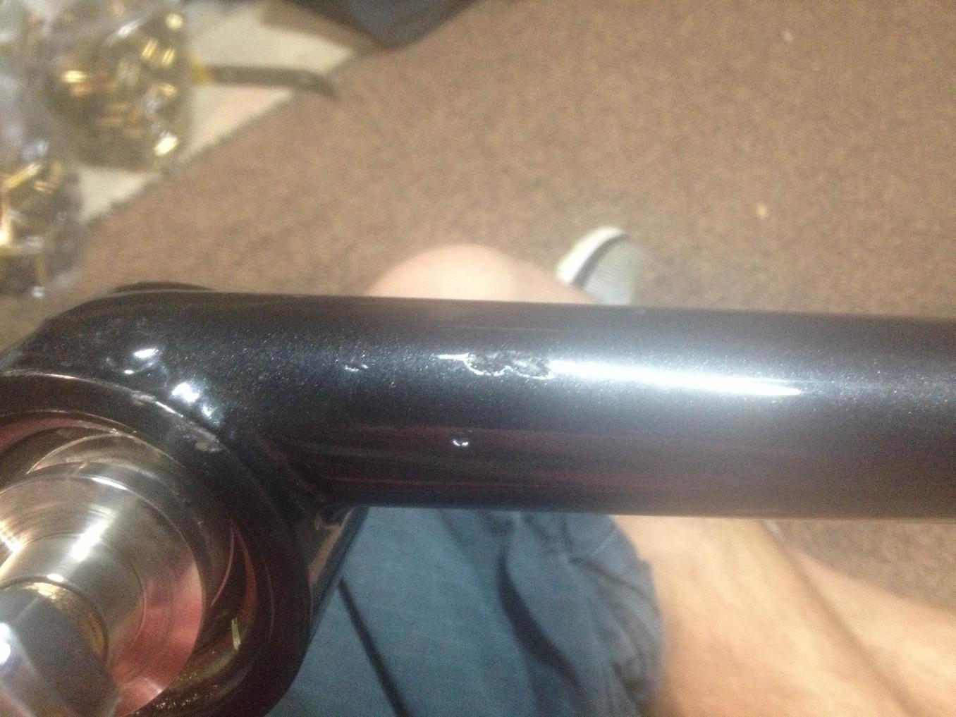

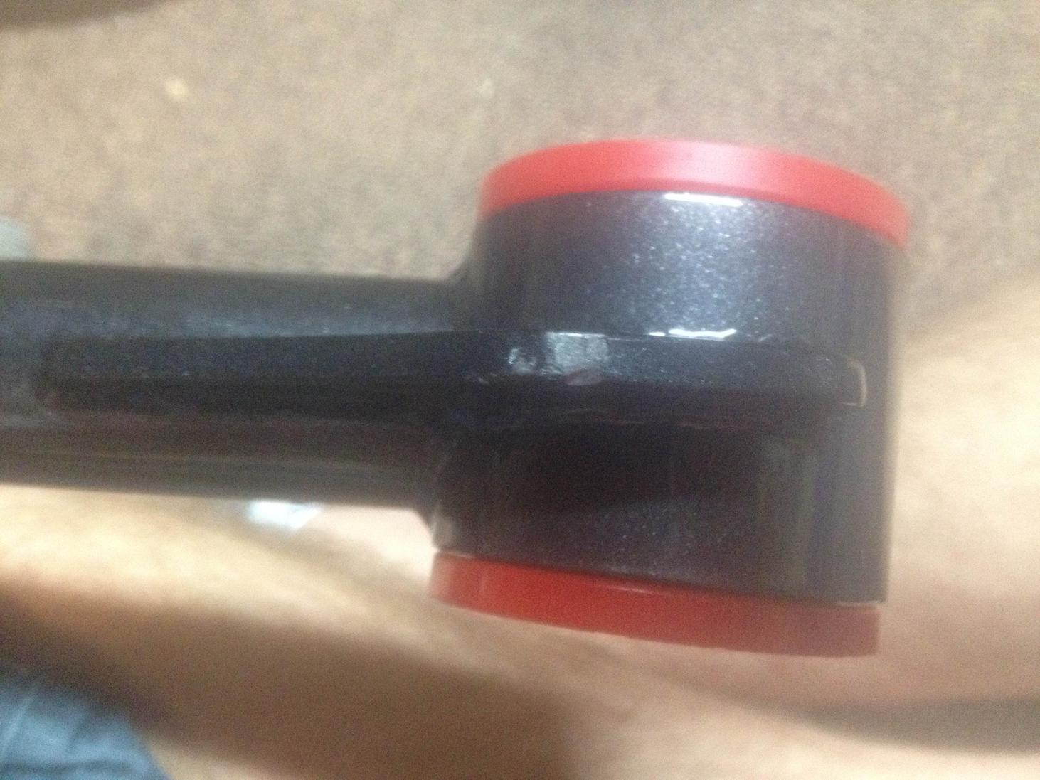

So I got mine today and while I don't feel they're that bad I wanted to get everyones ideas first. I've attached pictures. They were wrapped in bubble wrap. but only like one time around. I usually wrap things of this natrure at least 2-3 times, but I also tend to overdo things sometimes. My stickers are wrinkled and coming off and theres a few powder coat dings in mine. Now the question is, am I being unreasonable. I feel like my first trip down a gravel road is just gonna mess up the powder coat anyways because my tires are going to throw rocks all over it. I was kind of expecting this in all honesty because I read that entire post on tacoma world and quite a few people were also receiving them like this. I don't really want to be a pain in the ass, whats everyone else doing with theirs?

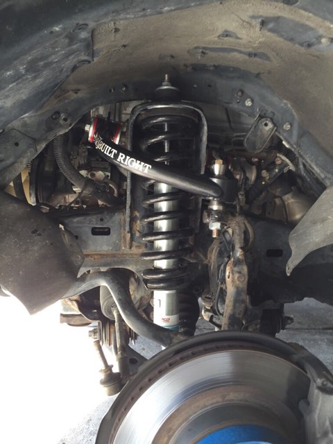

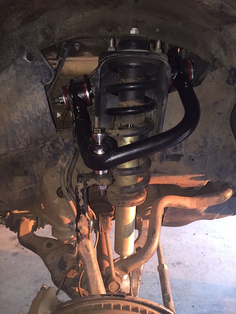

Alright I want to chime in since I got mine and did the install. So I had trouble getting the lower spacer in but once I gave it a few wacks with a rubber mallet it slid right in. I say this because I tried forever with a metal hammer and for some reason the rubber mallet did it.
My UCA's came absolutely perfect. Without a single imperfection. Install went really well and I am very happy with them. Stickers are peeling but I was going to remove them anyway.

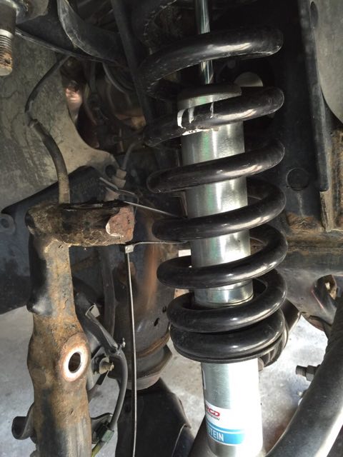

Install took me about 2.5 hours for the first side and a little less than an hour for the second. I had trouble with the upper ball joint separating from the spindle. Tip: use a pry bar and put pressure on the upper control arm and spindle while you hit the flat side with a hammer. It'll pop right out.

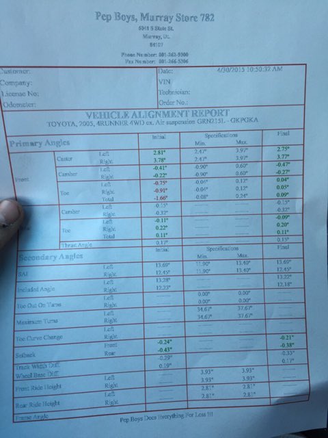

Haven't gotten an alignment yet but they have clearance of the shock at full drop. Yay.
I am impressed with these. Here are some pictures. If you have install questions let me know.
Use a zip tie from the spindle to the shock so you don't stretch the ABS wire.

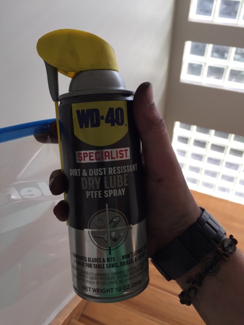

Here is what I'm using to lube the ball joint. I read up to get dry lube and spray them down every week or so.

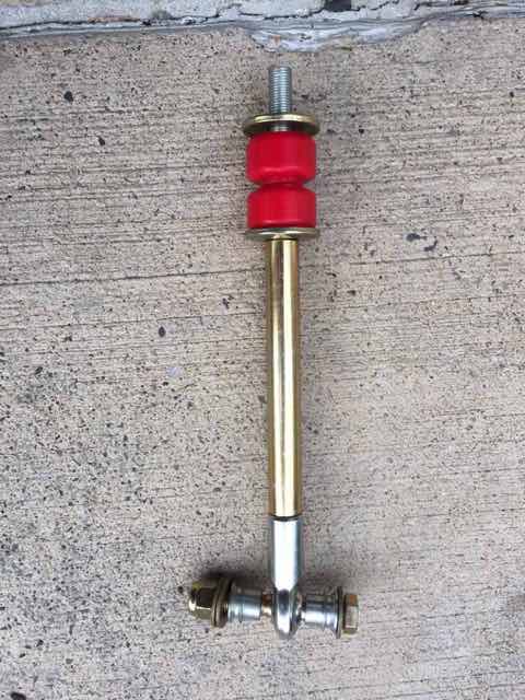

Off-topic: also made these today!

There's no reason for you to feel like an ass. You didn't package them up. I think it will be a great product they just need to work on the shipping. Thanks for getting a good price. I'm keeping mine cause they really are not that bad.
