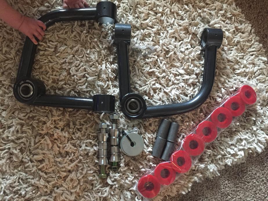

Received. Very happy with the build quality, I will say that the "built right" stickers will be coming off first thing as they are peeling off.

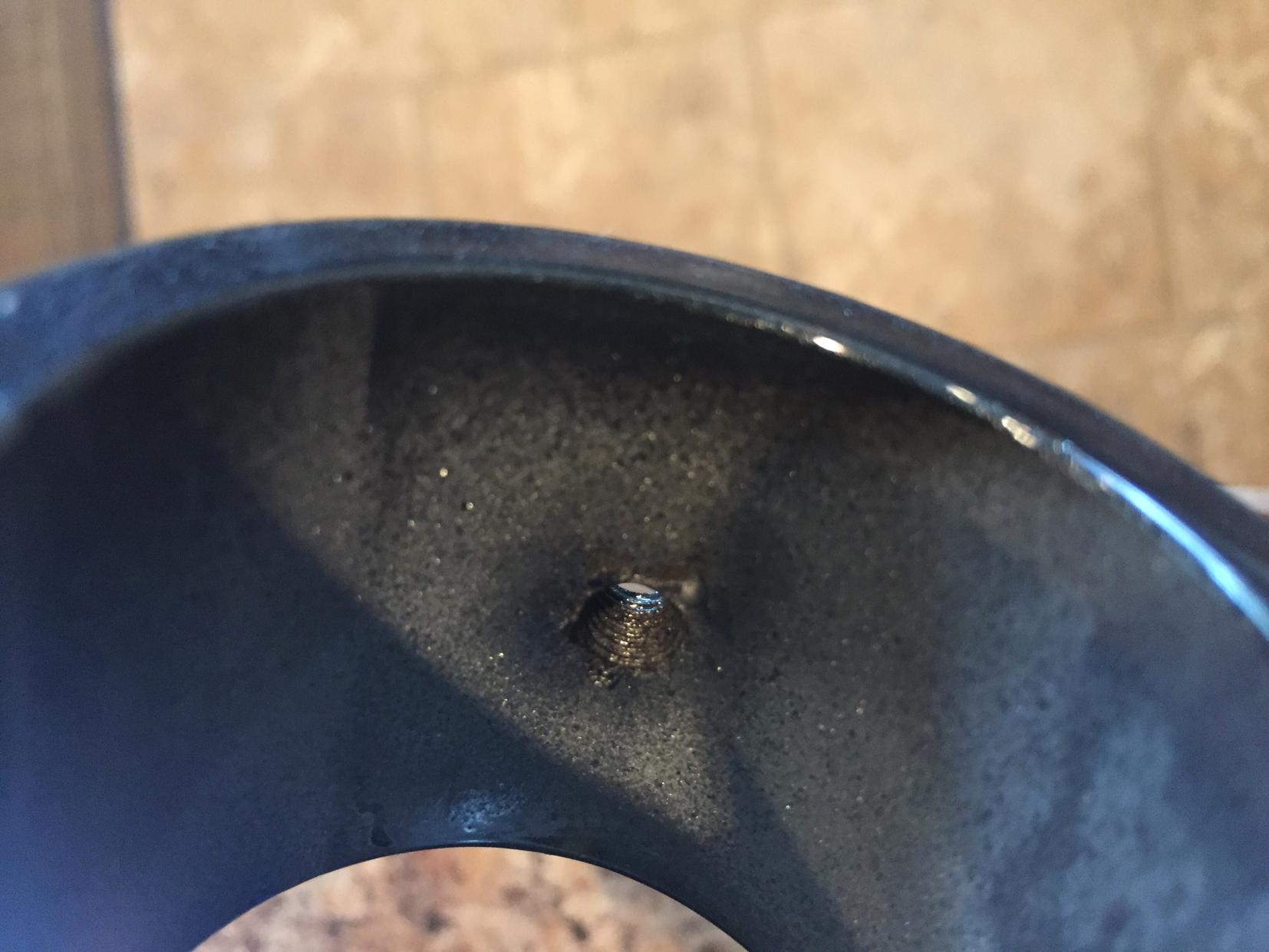

Be sure to file down the grease zerk fitting holes before installing the bushings to prevent damage when installing.
