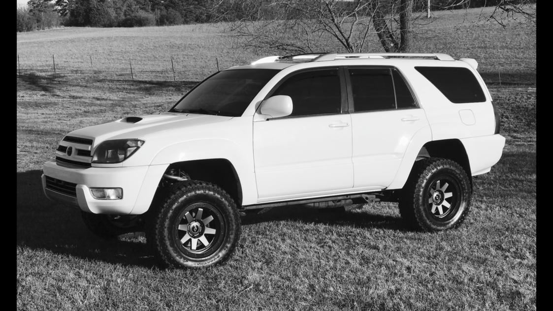

Thanks. I'm also in Knoxville. I'm sure we will pass each other around here sometime.
