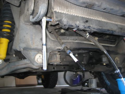

Lower radiator mounting bolts help
I just did a timing belt and water pump on my 2000 sr5 4x4 3.4l. well my truck suffers from rust issues that I'm slowly repairing. None the less instead of removing the mounting bracket from the front core support I just removed the four bolts attaching the radiator to the mounting bracket. I need the two lower bolts the utilize the square nut. I sheared both of those bolts. Anyone know the part number or where I can find these? I can make them or find something close on mcmastercarr but I'd rather get the original part.
