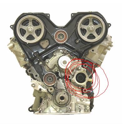

wheres the thermo go gents!
No codes and I Belive it is just something todo with the rad, I rode a/c off and didn't smell anti freeze (I did but it's bc it was outside while my rad boiled over)
right here
