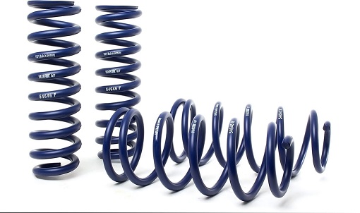

What do you think of the use of the H & R 54646 springs? with factory and non-factory shock absorbers

If you use them with the factory shocks they will destroy them.
There are obviously much better choices in the market. If you lift the front end with a spring you need to use and aftermarket shock (Eibach, Bilstein, etc)

I am in another country. there is no choice.
H & R says that they can be used with factory absorbers.
although I also think that we need others.
5100 will be weak for these springs?

5100's will do just fine they are not weak just non rebuildable like the OEM struts. If you have access to those get em.

I'm a fan of H&R on lowered vehicles as I've run several in my past life. For lifted trucks, never had experience but based on how stiff they are (at least with lowered vehicles, I'd rather run Eibach. H&R has always been known to be stiffer than most but quality is solid.
