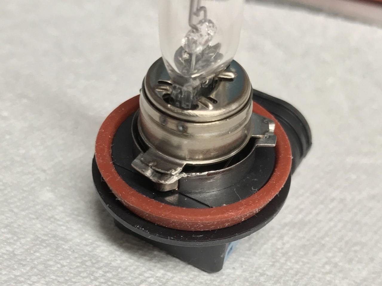

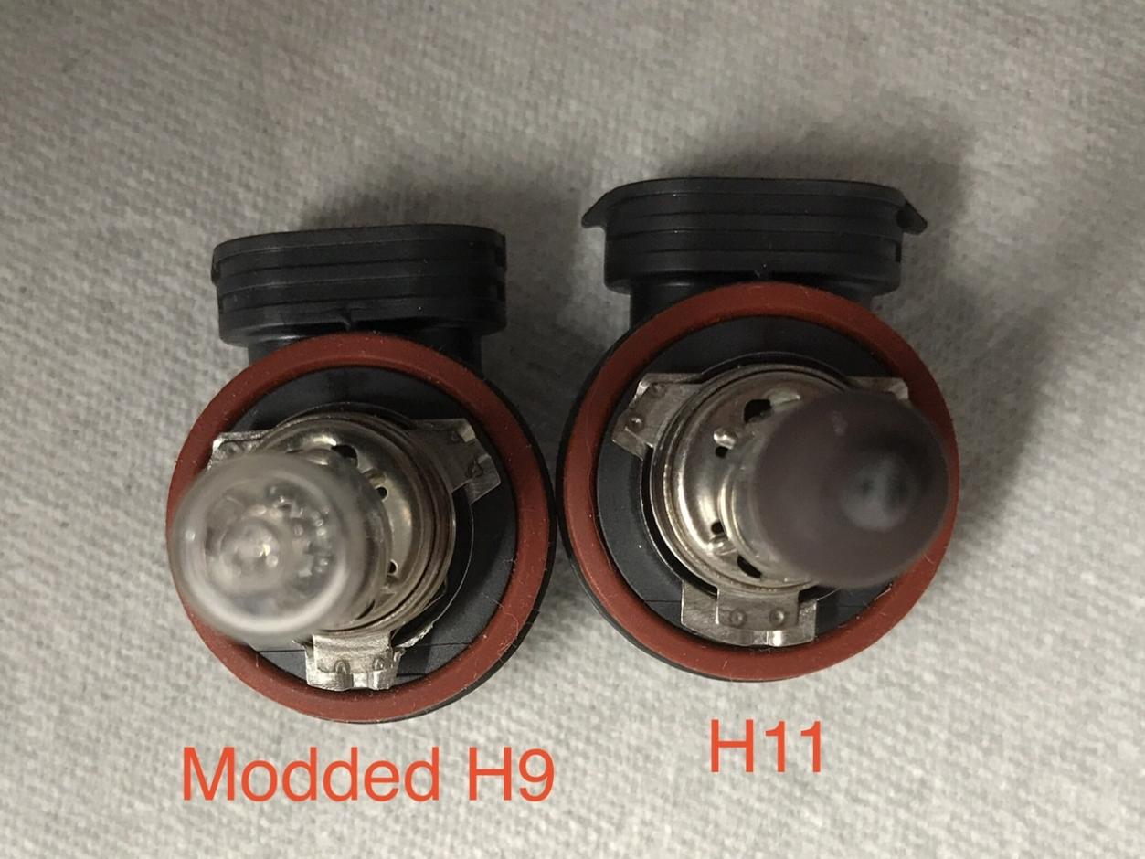

Compare the cut tab on the H9 with the original H11 bulb tab. You don’t want any sharp edges or burrs from cutting, clean them up with a fine toothed file. It doesn’t have to be perfect. I cut a little too much metal on this one but it still fit OK.
Hi ElectroBoy - thank you for the pics - My cuts do have burrs on them - Unfortunately, I don't have a file to clean them up (I need to add so many tools to my tool collection ... LOL).

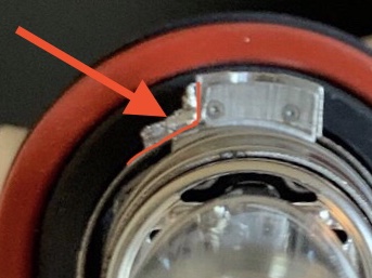

My trimmed H9 bulb looks like this right now:
script>
I think once I get access to the Dremel this weekend, I can clean up the edges and it should fit snug? Do you think I may have cut off too much of the metal tab too? I followed some instructions I found that said to trim off 3 millimeters from the metal tab to make it fit.
You just need to get rid of that metal above the thin red line in the photo. Careful dremel tool work will do it. Or a file. Or maybe more small nibbles with your side cutter, if it’s got a sharp precise point. You’ll get it. Just pretend you’re doing brain surgery!
