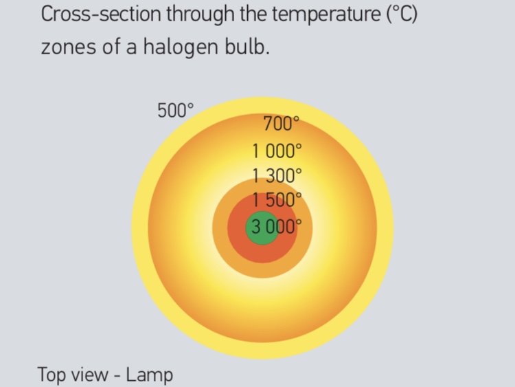

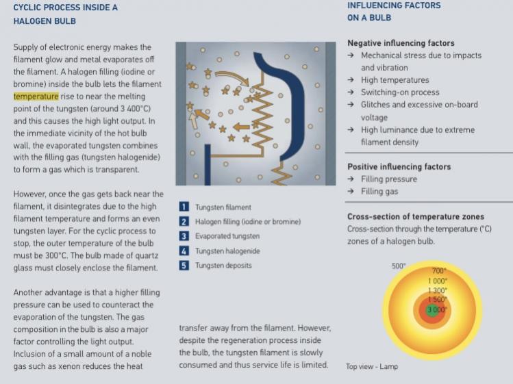

Also, I tried to use a hand-held thermometer (the type that uses a laser spot) to measure the temperature at the headlight lens with the H11 and H9 bulb (before/after). However, I wasn't able to get an accurate reading because I got an error code on the hand-held once the temperature reached 250C (250C is equal to 482F in US temperature scale) with the H11. So, the H11 temperature would have been more than 250C/482F. I didn't bother trying to measure the "after upgrade" temperature with the H9 bulb. Would you happen to have any information on temperature comparison between H9 and H11 bulb?

Based on the temperature reading you got, over 250C, I’d say you were probably measuring head-on into the lens and reading the actual bulb filament. The lens material itself is most likely polycarbonate which has a glass transition temperature of 147C. At that temperature the lens gets rubbery and would start to slump, and that didn’t happen to your lens.
I remember reading a comparison of bulb temps, I don’t recall the numbers.
You could try reading the lens temperature at different angles. Maybe that reading would be more representative.
Update: I just tried this with my thermapen IR reader and when reading head-on into the center of the lens the meter got an overload reading. When reading the lens from an angle I got 50C after 5 minutes.

Yes, you're correct - Yesterday, I had aimed the laser spot directly into the projector housing when it registered, "Error". Now that I've got the H9's installed, I tried measuring the temperature after they've been turned on for a few minutes and am seeing approximately the same temperature reading as you see when I take a few readings off the headlight lens at various spots.
Good to know about the 147C transition temperature! It gives us a usable reference-point in terms of an "extreme" temperature.
