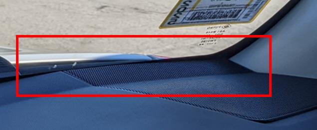

Take a look at the pic, you can see where the dash meets the windshield glass in the right corner, the dash is flared rising about maybe 3/4". If you press on the corner of the dash here it can be pushed down, but it will not stay down. It's like looking at a picture on the wall that is crooked, drives me nuts from the drivers seat.
Shop is willing to remove the windshield and see what might be causing this. I dont believe I beought it in like this.
Anyone experience the same after new windshield installed?

I'll take a guess that windscreen installer had too much glass adhesive/sealant in that area and excess amount of it pushed the dash pad up.
