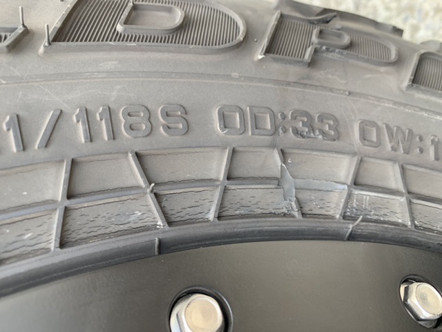

While rotating my tires, I discovered that all four tires have hairline cracks on around the head area. I attached a photo. Is this normal? Tires have roughly 20k miles. These are Falken Wildpeak AT3W in LT285/70/17 40 PSI cold.

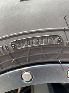

Check the manufacturer date. Not unheard of for a tire shop to sell old tires..

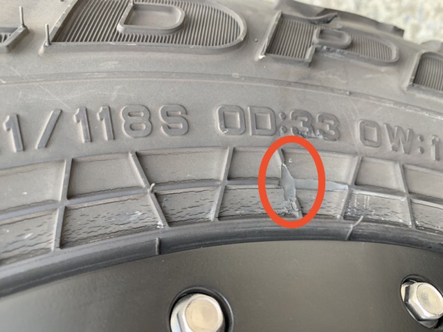

Maybe it’s latent damage from when they mounted the tires without enough lube, and the heat and aging is making it more apparent.
That little chip is suspicious.

FWIW - I wouldn't think twice about it. Rubber ages. Some small cracks on the surface don't really indicate a problem. It's most likely cosmetic. Look at the inside sidewall of your tires. If you don't see any issues there - it's probably the result of whatever chemicals you're using to clean them.
When one looks like this its time to replace all the tires.

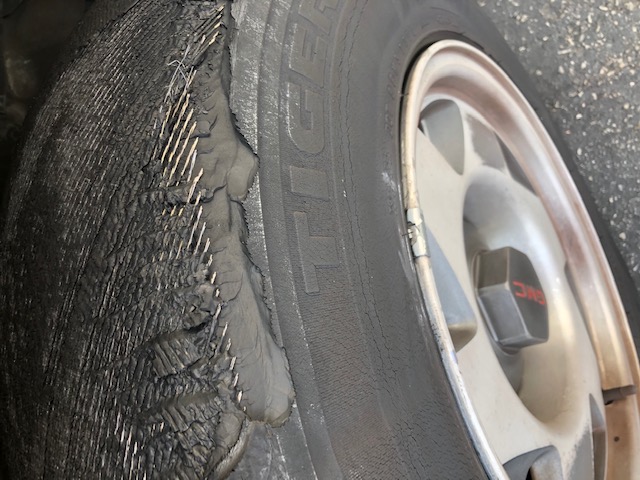

6 years and 17000 miles

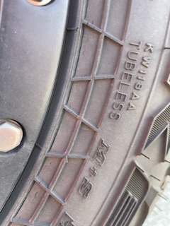

Any update on this? Curious if they were ever covered under warranty. I have the exact same cracking around the bead issue on both sidewalls of my At3/Ws. Mine are OEM size 265/70/17 on ICON Rebounds. Tires manufactured and purchased in 2019 with 23k on them. 3 from the same lot are all cracking and the 4th from a different lot is not.
Photos.
