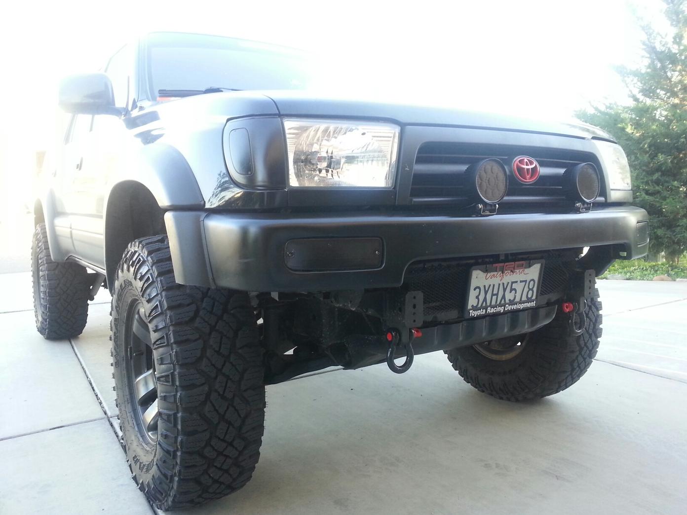

so the bumper you linked is a stock bumper that was trimmed to look like that. I'll tag [MENTION=91623]CenCalifoothill15[/MENTION] since its his truck and he will know best. The tow hooks are on separate pieces that are bolted into the frame.

The half bumper has served me well, really just did it to increase my approach angle and front end clearance, and looks good on 96-98 runners but does leave some areas exposed. To cover the AC condenser I used some steel mesh, a.k.a. (gutter guards $5) from Home Depot. And for the shackles I got some mounts welded on at a local shop for $20.

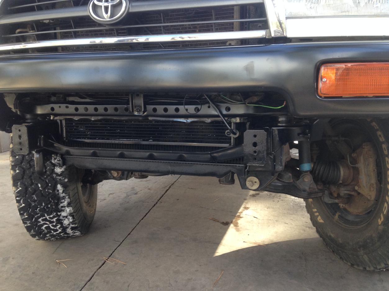

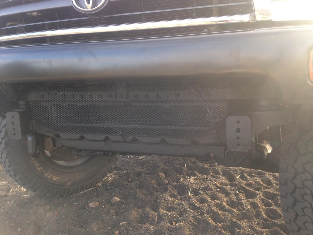

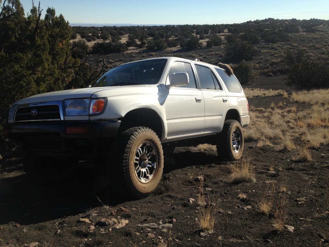

Heres my rig, named her pearl haha. 250,000k miles, crate engine dropped in at 225,000k and u can tell, k&n system, front and rear coils with 3 inch leveling kit, 33x10.50's goodyear all terrains with some sweet wheels. Traded a lifted chevy 1500 for it straight bilsteins. How did you attach the gutter guard? and ya as you can nothing under the bumper at all.

The reason yours is so much more exposed is because of the body lift. Sounds like a solid excuse for a new aftermarket bumper that accommodates. Also from what I've read the 3inch body lifts are uncommon. You sure it's 3 or is that just what he said?

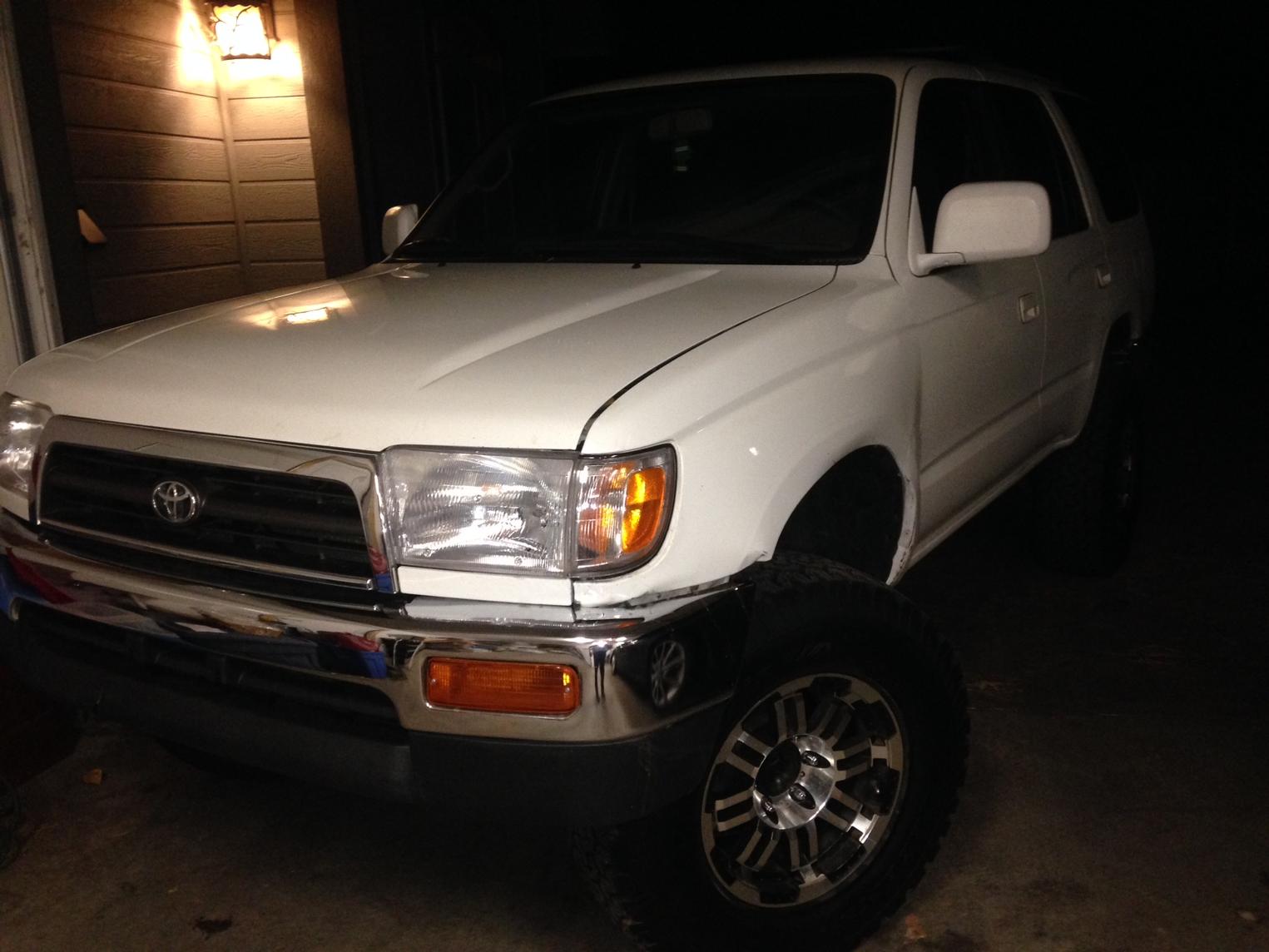

Made some progress! managed to snap the blinker lights taking off the bumper! i got a lil anxious! going to get the gutter guard and wiring for the light soon. any tips? what do u guys think?
