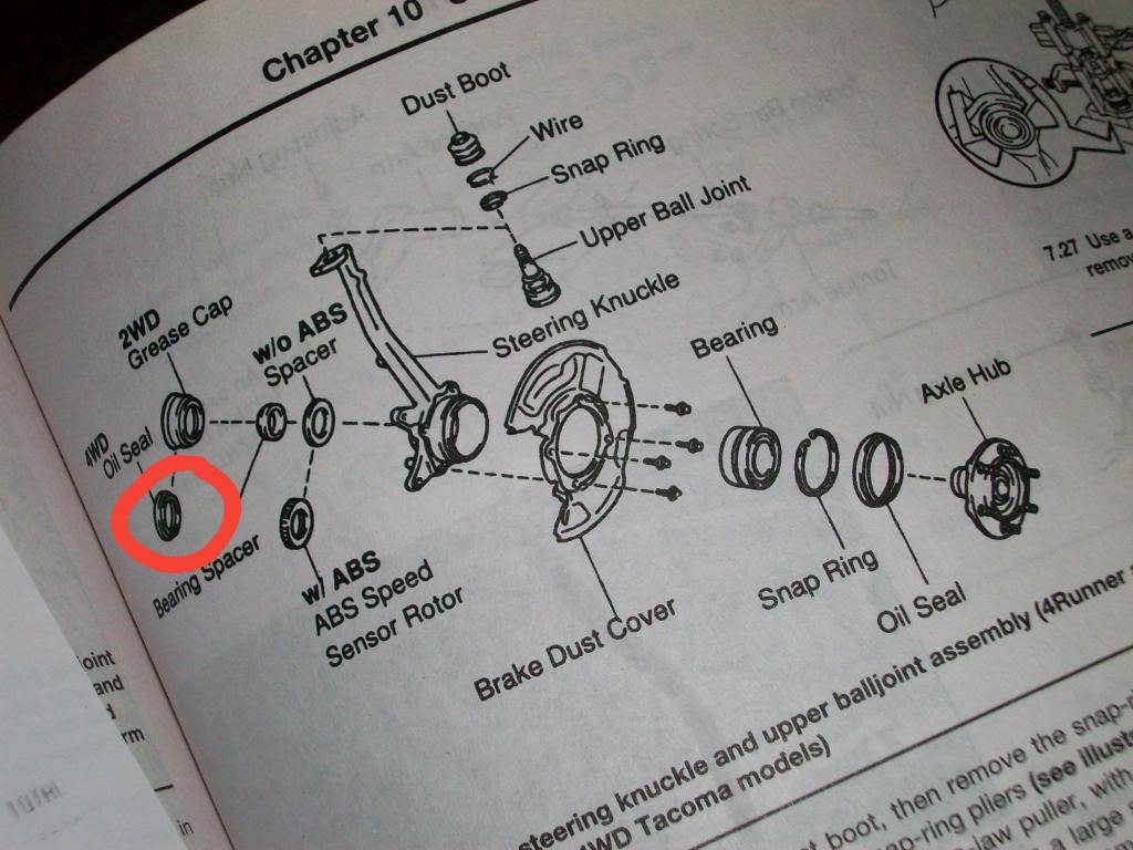

Secondly, many people have said to replace the oil seal when replacing half shafts. They are referring to the red circled part in my picture correct?

For sure replace the seals that go into the front diff, and plan on the ones that go in the outboard side of the axles. The number the previous member mentioned is correct for the outboard side seals. The seal you circled in red is just one of the seals for the inboard side. I just replaced both mine about a month ago, and the part #s are different for pass and driver side, and each side is installed at different depth in the differential. I will try to remember to look for the old boxes to find correct part #s but I'm betting they've been thrown away, just be forewarned they are different part #s and will require different install depths in the differential. Due diligence on this forum will find you the numbers and depths, as well as all information for the process itself. The really great thing about this whole deal is the axles can be swapped out by just removing two bolts and the axle nuts. No need to undo anything other than the two bolts in the lower ball joint brackets.
