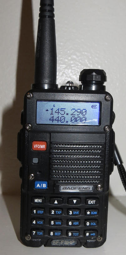

For a portable, try a handy talkie like this one. Dual band and only $62. Mine works well, I can hit a repeater 8 miles away on low power.
