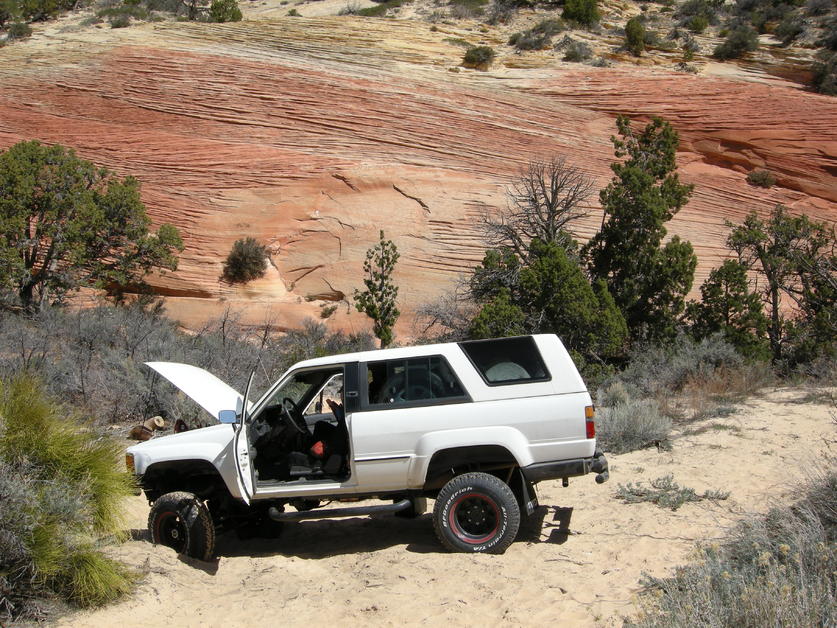

We headed out from the Bay, up over the Sierra on I-80 and then southeast across Nevada through... well basically nowhere, Tonopah ("Queen of the Silver Camps") being the highlight. We camped one night at the base of the Elkhart Cliffs, east of Mt. Carmel Junction, Utah, and west of Kanab. My wife was driving (:driving: :beer:), it was very sandy, she was in 4 Low and flooded the engine and just kept revving. The battery completely died.
I got a jump (see picture below), eventually... we were only 1.5 sandy miles back off the road. After several more jumps (all in Kanab, Utah), and a day of working in the parking lot of a Motel 6 in Page, Arizona, learning about the underside of my truck, I managed to replace my alternator.:bravo: Got a new battery while I was at it. Electrical problems solved. :trophy:
