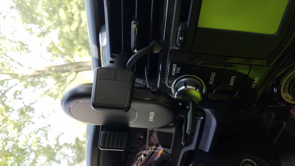

I got a dual, 2 amp usb socket on amazon. Wired my wireless charger and backup cam to it. You could solder wires onto the fron cig outlet with a fuse on the positive. I ran the wire from the charger into my ac duct and used strip caulk to seal it. Ran that down behind the front pocket. Same for dash cam. Just up and around then under glove box to the dual usb.

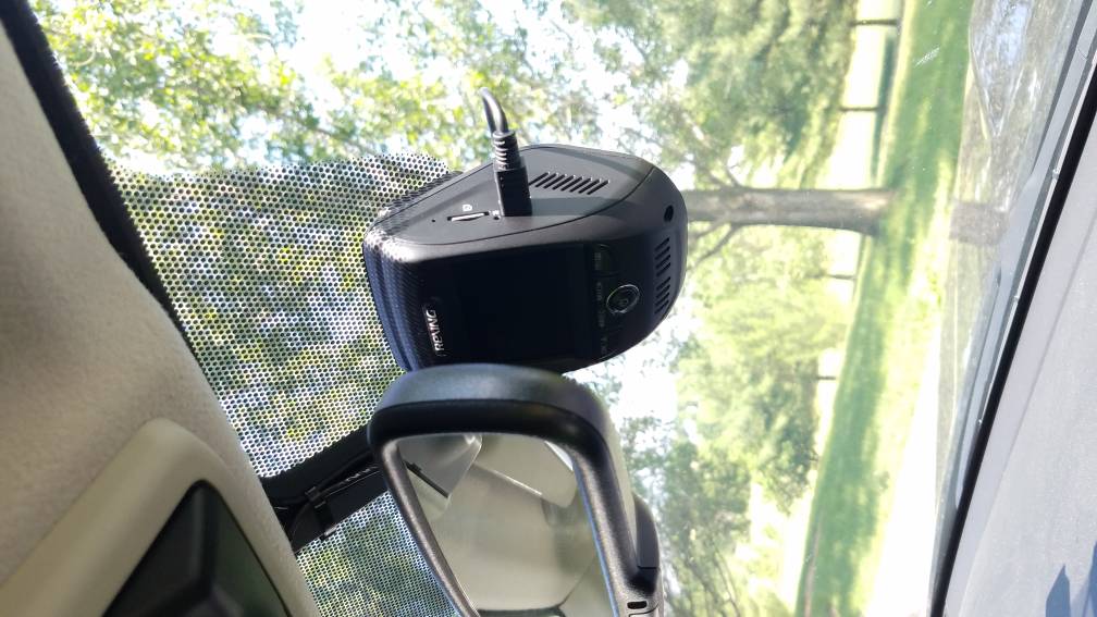

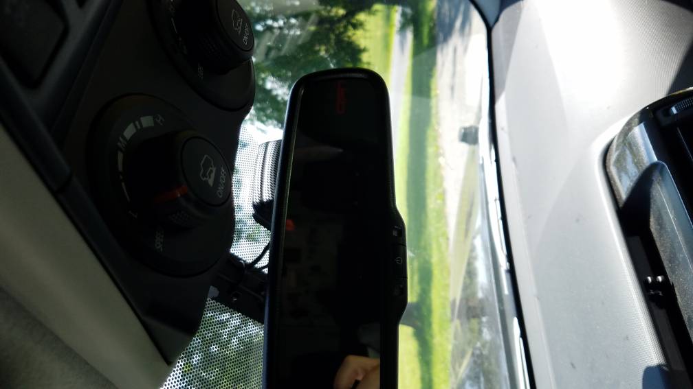

I thought I'd circle back after installing my Invisicord yesterday. Total elapsed time from start to finish was 15 minutes. Reading darkpassenger's messages helped me know what to expect but honestly, this might be the best and easiest mod based on return on level of effort I've ever done.
My Simple DIY Instructions:
1.) Swivel mirror to the right and undo the Molex connector.
2.) Slip the piggyback pins into the connector under the existing pins ensuring that the slip fit is secure. IC Red to mirror blue. IC Black to mirror White/Blk (Wire colors on mirror may differ on your vehicle.)
3.) Plug the connector back into the rear of the mirror. It only goes in one way.
4.) Arrange the free cord in such a way as to be inconspicuous and make sure to zip tie the Invisicord to the mirror cord to act as a strain relief. The Invisicord has a small black plastic cube in the middle that has a self-stick pad on it. It's probably where the 12vdc to 5vdc step down work is done. I used that to anchor the cord up near the top of the windshield.
5.) Plug the IC Mini-USB connector into the mini-USB port on the cam.
6.) Check for operation by starting your truck. My camera emits a chime sound when it powers on or off. Drive around and come back for a beer while you review your footage.

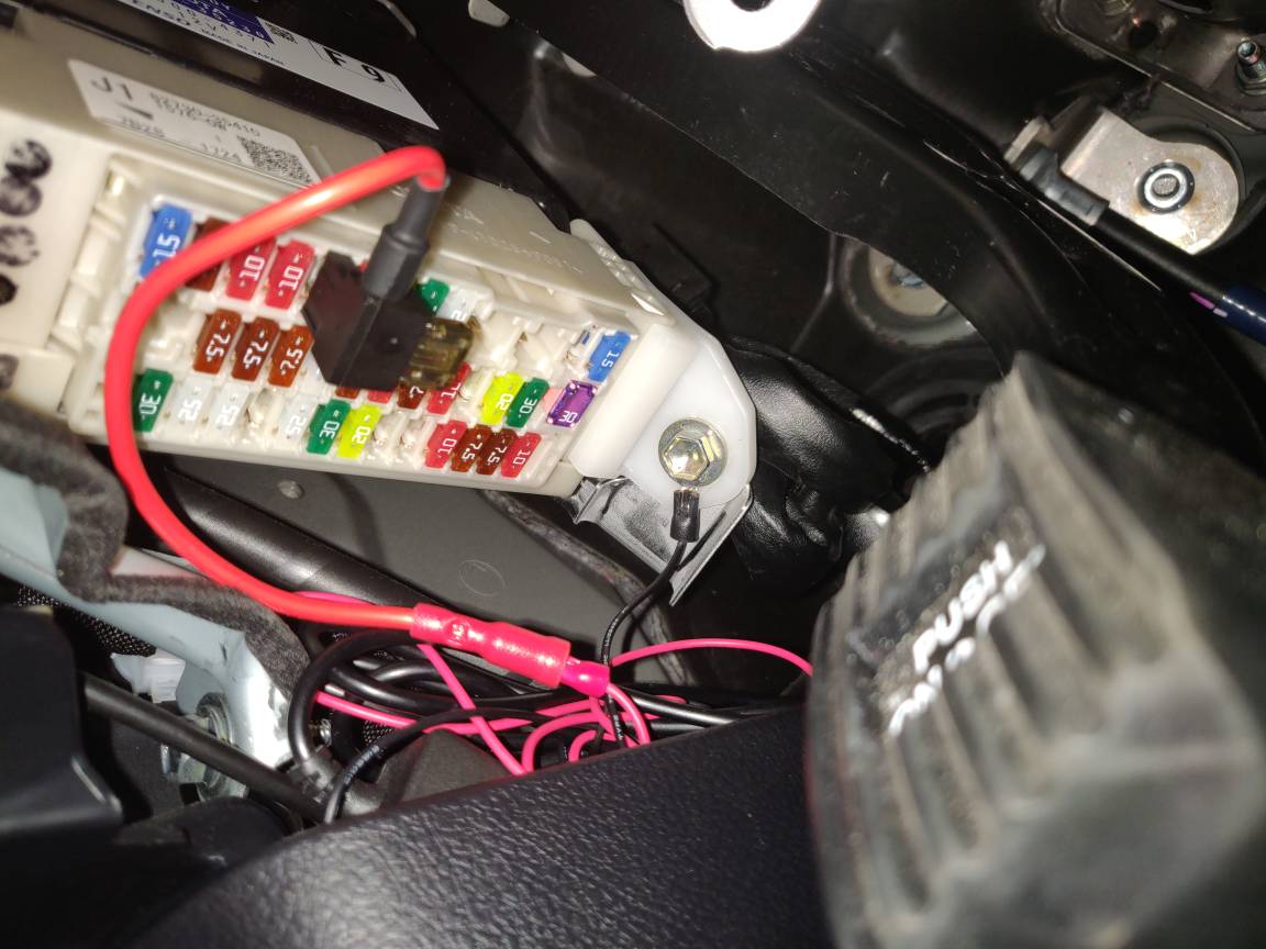

Old post but hoping you see my questions. Does your photo show the correct orientation for the Add-A-Fuse? I just learned about it needing to be inserted specific to which side of the fuse blocks power. I do not have a multi-meter to check. And the ground screw is done like that? Under the screw appears to be plastic. Thank you.
That is the correct orientation for the add-a-fuses. I used my multimeter to verify. I have my dashcams setup that way as well, except I'm running two add-a-fuses on separate circuits. as I have backup batteries under the driver seat for parking lot mode.
Grounds are fine, they are connected to the chassis under the plastic fuse box. Again, verified on my own with the multimeter.

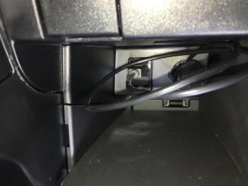

If you just want to hide the USB connector in the center console then you can just put a USB charger in the empty spot inside the glove box, splice into the cigarette charger in the center console (it does have a 15 ampere fuse capacity). Then you can route the USB wire from under the glovebox through the cigarette socket empty spot right next to it and plug in all inside your glovebox

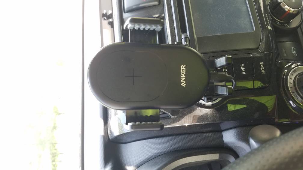

Also, does anyone know of a kit that will allow me to hardwire my dash cam and my wireless charger to a single fuse tap? I'd really like to do both hardwired and wires tucked away so nothing is connected to my cigarette outlet.
I have had my dashcam hardwired to the ACC fuse using the kit you linked.
Wanted to do the same as you for my wireless charger and just got a second hardwire kit and tapped into the WIP fuse. Working fine for me.
