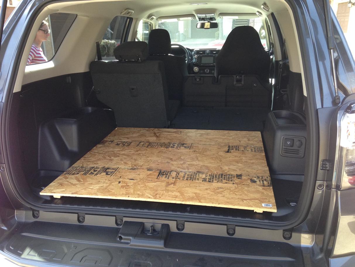

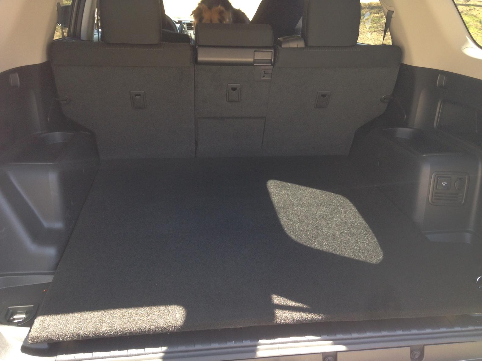

I had the same question and came up with nothing. Today I took care of it on my own though. Turns out a set of 2x2 posts with a 1/2" thick plywood board on top + carpet is exactly the height you need to level it out. And the board is 41x43. Here's mine.

Picked it up at Home Depot, along with all the rest of the supplies. I saw all of the storage options that people have built but honestly I just needed a level floor for when I'm camping, and I'll take it out when I'm back to civilization. The whole thing cost <$40 and took maybe 1.5 hours to build. Nothing fancy!

That's why I am hunting out an aftermarket solution (but that solution do not provide the "so call" level sleeping surface; while personally, I wouldn't consider the tray a "sleepable" surface. [MENTION=107827]boulderER[/MENTION] 's solution is the most elegant, simplest and best "sleeping surface" solution I have seen).
