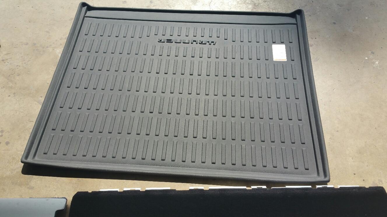

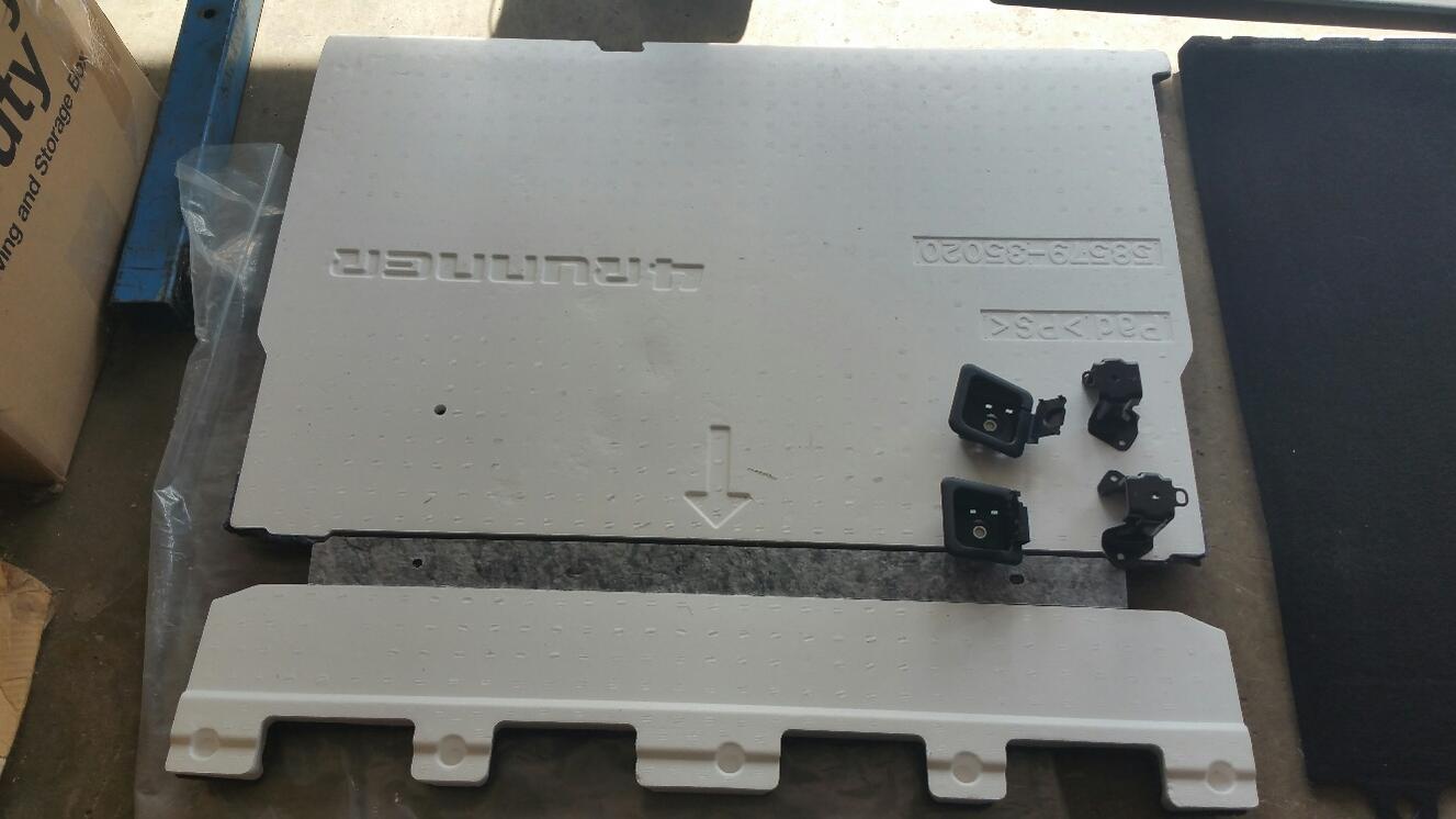

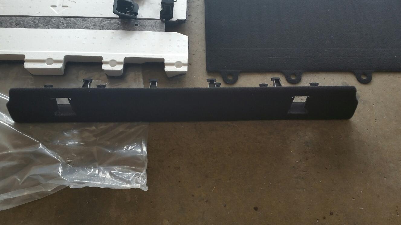

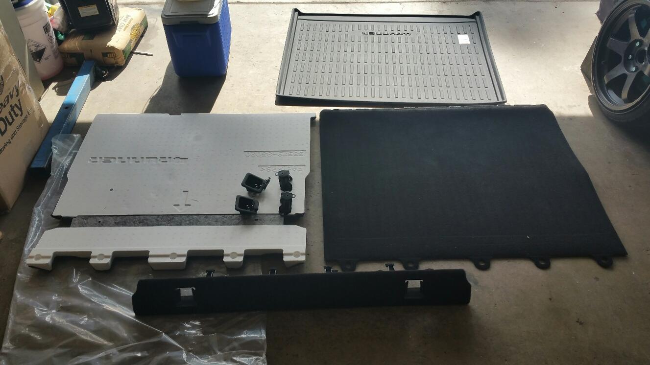

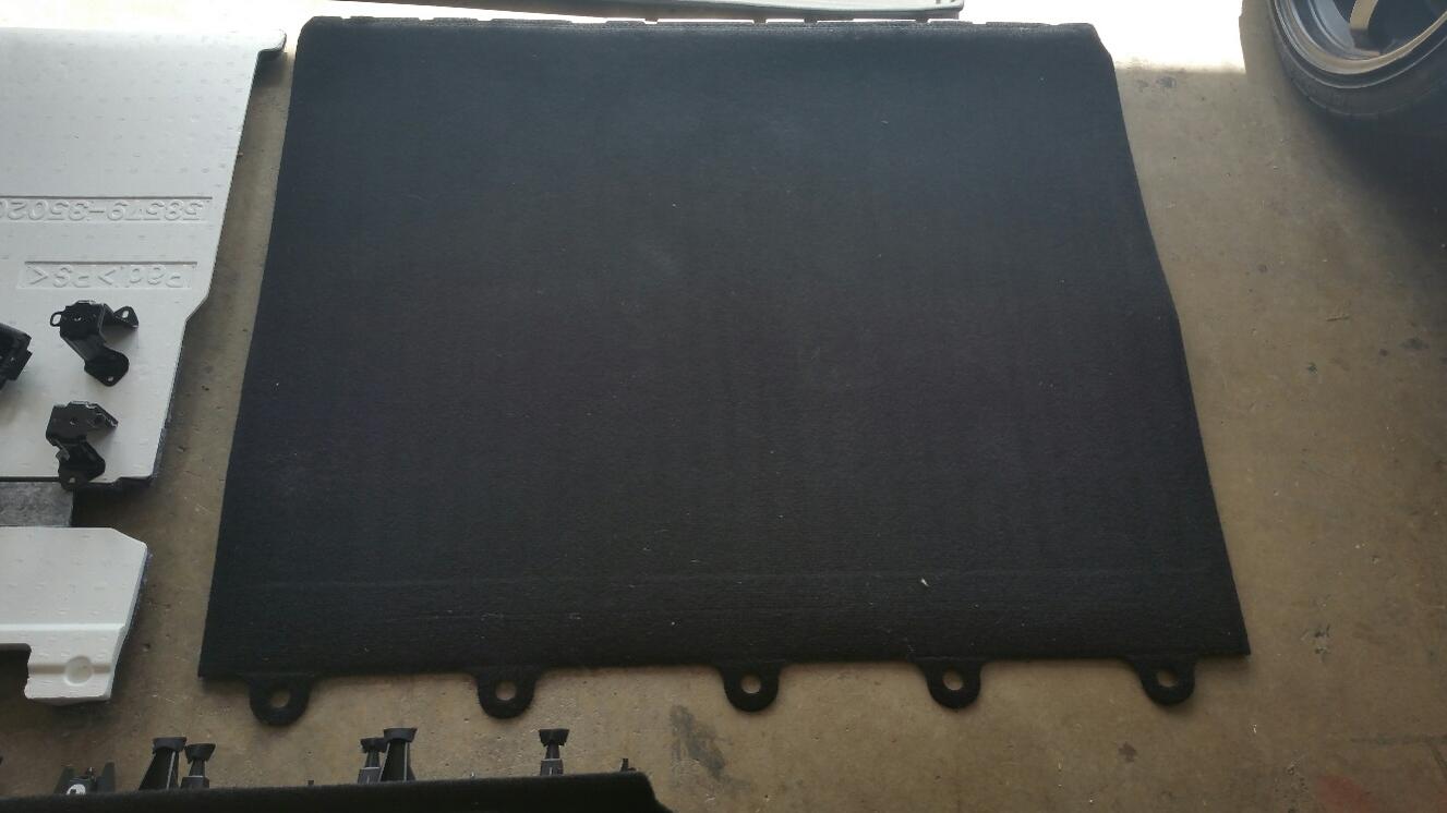

Here's what i removed to install the sliding tray, Simple swap, took about an hour to remove and install. Had to drill 2 holes to mount the sliding tray hardware.
The removed parts are:
1. Carpet
2. Cargo Rubber Mat
3. Foam padding under carpet
4. Panel for compartment behind the seats
5. 2 Mounting brakets for Panel
6. 2 hook plate mounts
