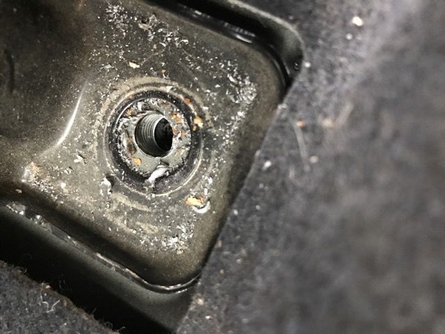

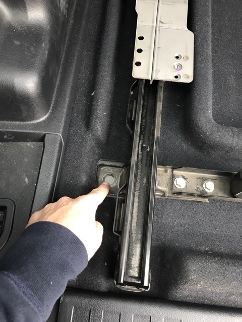

Yes it bolted right in, Just have to drill two holes on the floor of the rear most bolts on each side of the slide/track(closest to the rear door)...if that makes sense....

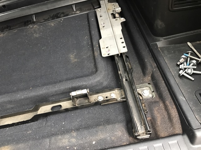

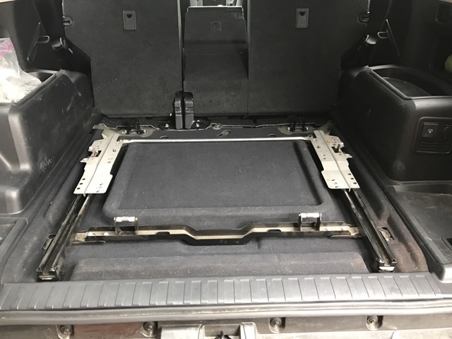

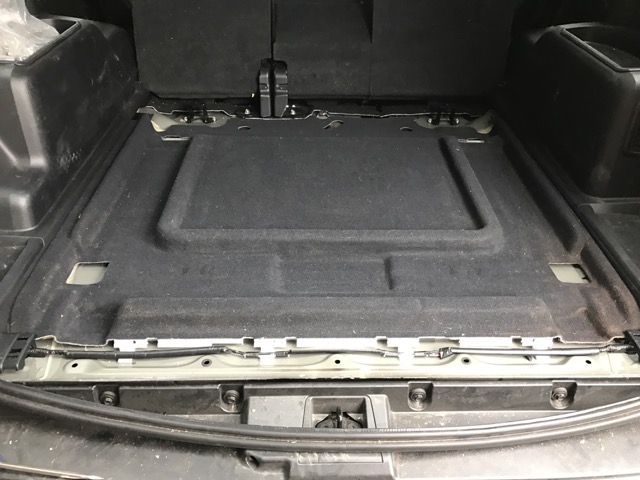

Hey gang, I just wanted to let you know I just posted a detailed "how-to" for installing the rear cargo slider into an SR5 here:
5th Gen Sliding cargo tray Install - Pics/Steps
A few pics from the thread are below just to give you an idea... if you are like, too lazy to click the above link or something...:redbrick:

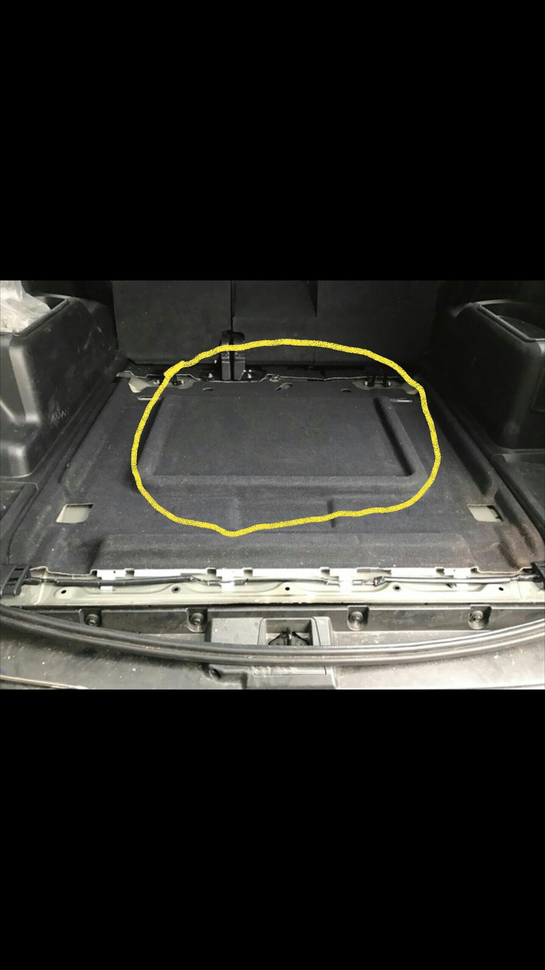

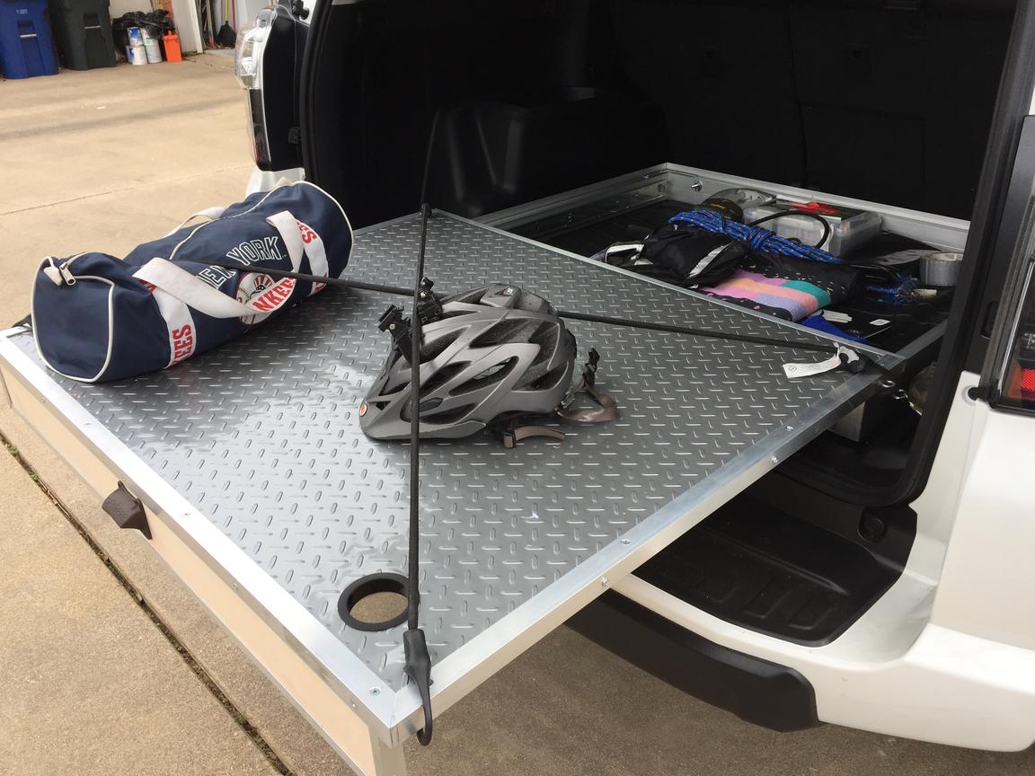

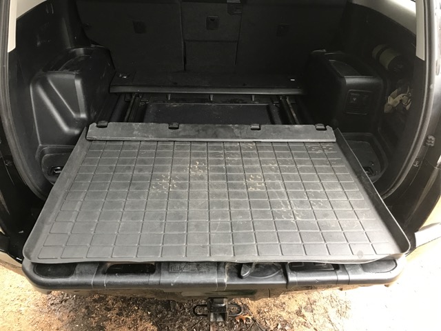

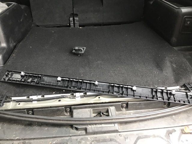

How much distance do you think there is between the rear deck body panel and the grey panel in this pic? I'm looking to cut the square area out and store items between the body and the bottom of the sliding deck.

Just use 2" rigid foam insulation. It flushes out almost perfect with an angle cut at the seat to eliminate any gap.
