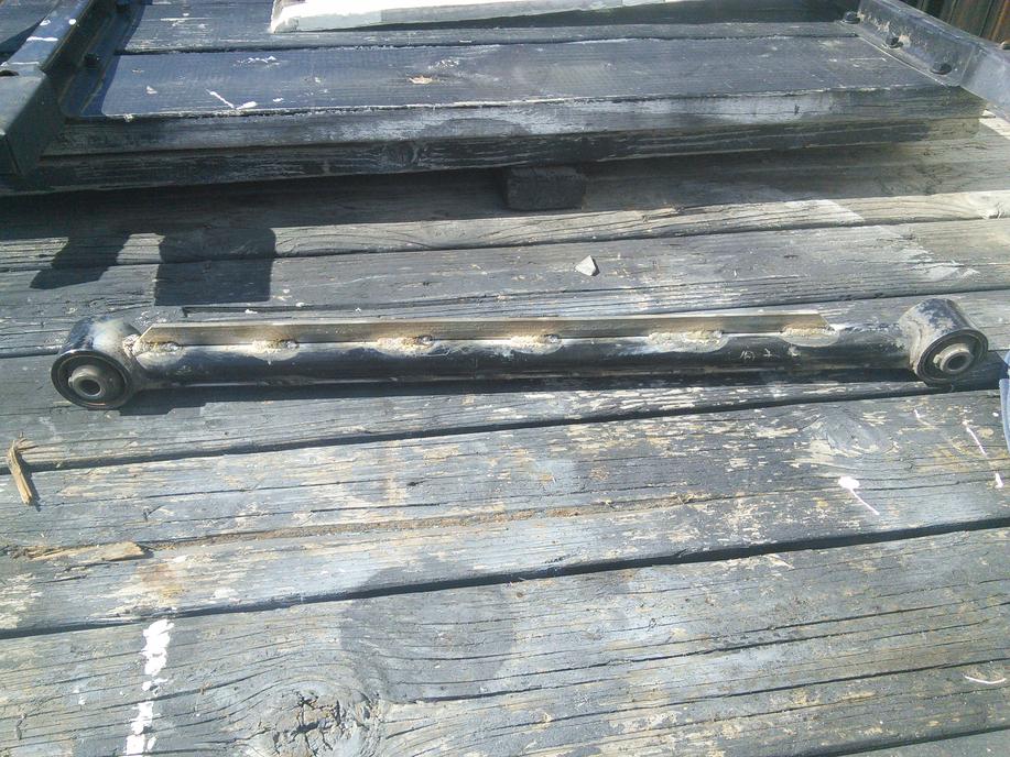

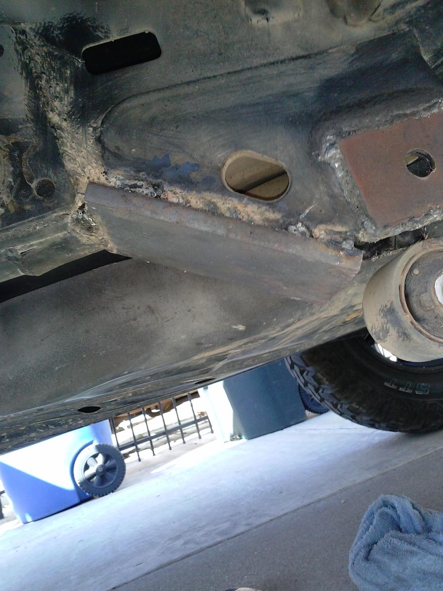

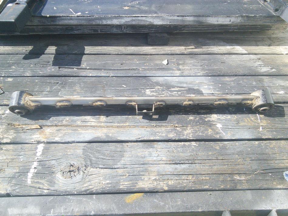

I also added plates to the link mounting area as they kept getting all bent up, and a plate to slide over to the links. You can buy bolt on skids for this part, but I had some scrap steel laying around. Haven't had a problem since doing all this anymore.

Can you get us the details of the piece you welded on? Length width thickness?
I think I mentioned it my build thread.
It's just 1/8" thick mild steel angle iron from Home Depot. Was getting some parts to make the welder I bought work and saw the angle iron and said, "huh that would work well!"
