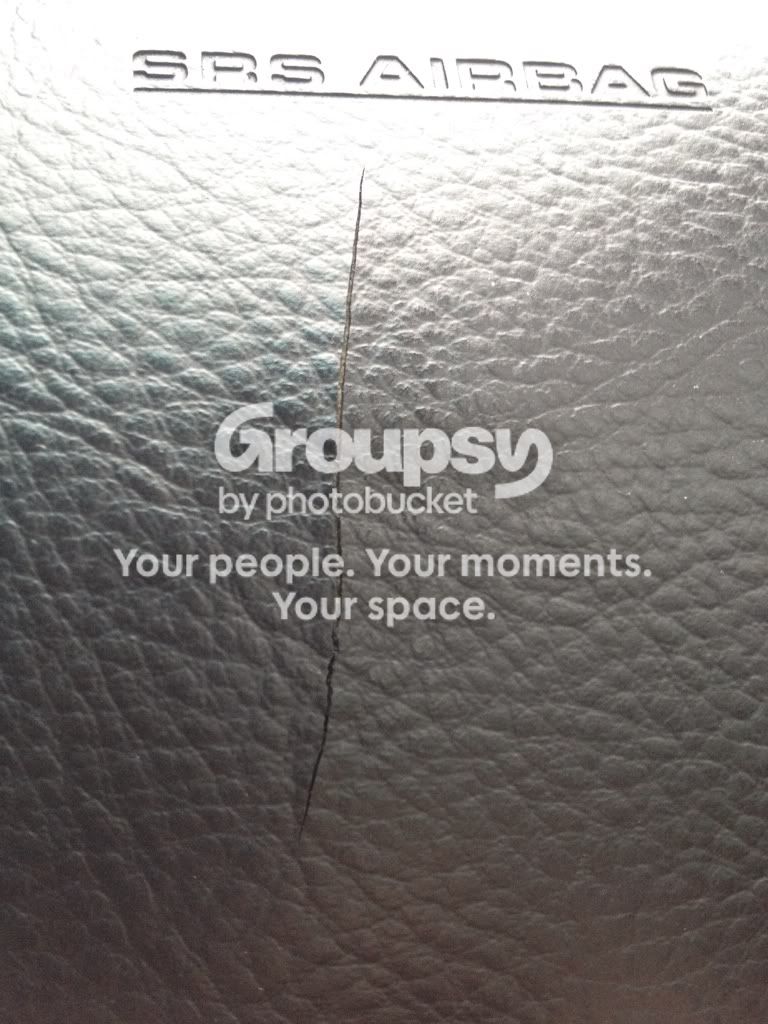

Found a crack in the dash. From some searches it seems like a common issue, but I haven't really found any posts that talk about the cracks being fixed.
Are people either leaving them alone or replacing the dash?

+1 would also like to know . ours is cracked in the 03 T4R, doesn't really bother me, but my it bothers my wife...
My 04 is cracked, as is my buddies 05. We've talked about using some kind of glue stuff to stick it back together, but I'm worried I'll just make it worse.
I'm in as well, mine is cracked in two separate spots. Neither is noticeable so I've just left it alone, would like a fix though.
It bothers me as well, I've got a bunch all over the place in all shapes and sizes. I figured it was from the stereo install guys being rough when they put her back together, but guess I'm not the only one!

mine has a small crack but my main concern with the dash board is the awful creaking noise in warmer weather. i am considering replacing it down the road...maybe an opportunity for a group buy? :keyboard:

Oh yes, you can't "patch job" the dashboard and not expect "seems" and signs of it being repaired. That would look bad. They apparently put on a new cover on the dash making it look seamless and professional. I wonder what they charge?
The color match doesn't look to good to me. I was wondering if you could fill in the crack and then use Plastic Dip to coat the whole thing. Plastic Dip seems to have a lot of elasticity to it. The biggest problem would be over-spray I guess.
I've seem some amazing work done by detailers. Checking with a good detail person may lead to some options. Probably wouldn't cost more than $50 for a repair.
Toyota replaced my entire dash in 2005 4runner a few years ago. Dealer called me and did the replacement.
no cost to me. 10% FREE. must have been a recall!
