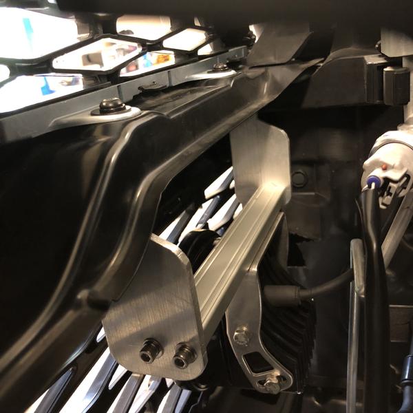

You could make some pretty simple mounts if you were willing to cut holes in the lower grill section. Then mount those to either the crash beam or hang down from the center bumper support crossmember. These are the mounts I made to hang lights down utilizing stock holes so I could install the C4 bumper and still have lights in the grill opening.
You want to be careful if you get too low. On plastic with some reinforcement, you’ll be at greater risk of ripping them off if you actually go off road.
