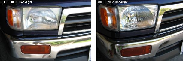

So we know of course that 99+ headlight housing are a vast improvement in light output due to the lens not having the angled lines found in the 96-98 lenses. Is it is all possible to sand and buff these lines out? Post your opinions!

Reflector bowl inside will still be smooth, so unless you're doing a projector retrofit, no real point.
Rockauto.com has 99 headlights for less then 50 for the set... greatest cheapest improvement you can make on a 96-98.. changes light output by far while looking cleaner/newer.

You'll get poor light output if you keep the '97 bowl and install the newer glass since the '97 bowl is a smooth finish. The newer headlights have reflective lines in the bowl that do the reflecting, instead of the glass like in the older models.

I've tried sanding pits out of glass headlight lenses and using cerium oxide to polish them. DIDN"T WORK. The amount of time and effort it would take would be insane, if you didn't crack the glass. $80 for a set of headlights is cheap.
Has anyone put 99-02 housings in a 96-98 who can say for sure if housings alone make the headlights brigher? I'd be down with that, TYC's aren't pricey at all.

I am sure they are brighter because they are being impeded. I purchased TYCs for my retrofit and they are awesome.
