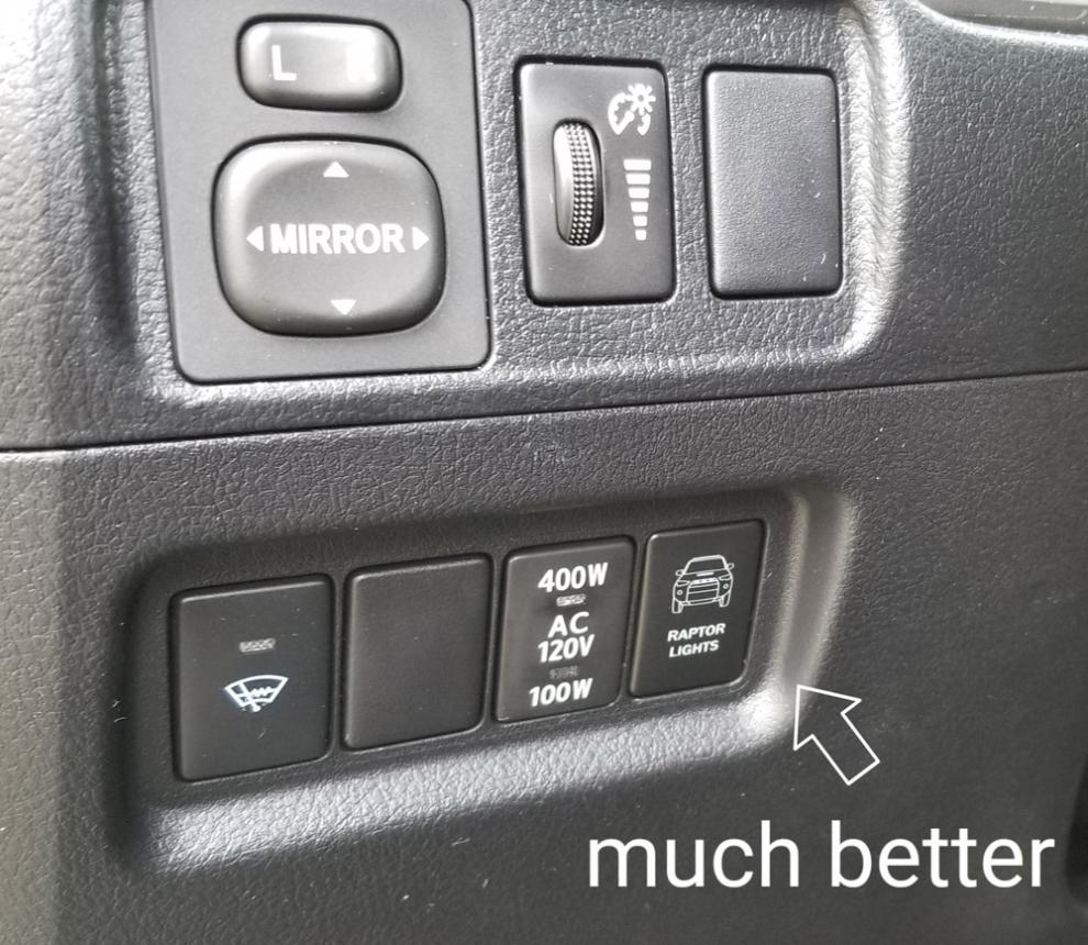

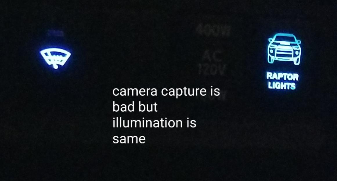

Here are some... just wired it up tonight... very happy except wish the switch color matched blue of other interior lights better.
Cheers JC
Got new AOB switch from RonnieBoyFab… Much better!

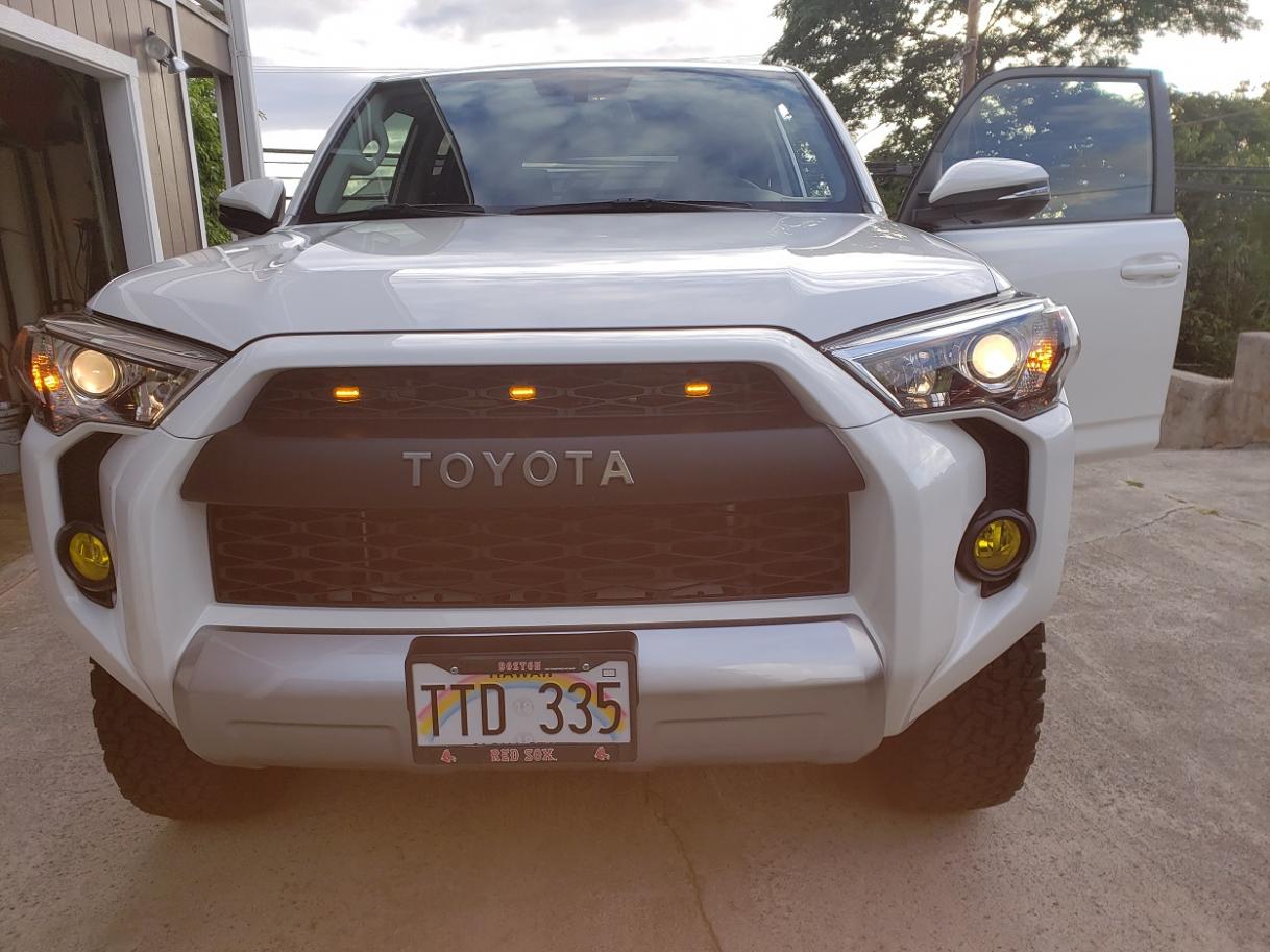

Ronnieboy also recommends removing the upper grill, which isn’t necessary. The Yotaled is a 10 minute installation with ad-a-fuse in the #14 spot that runs the lights whenever the 4R is on.

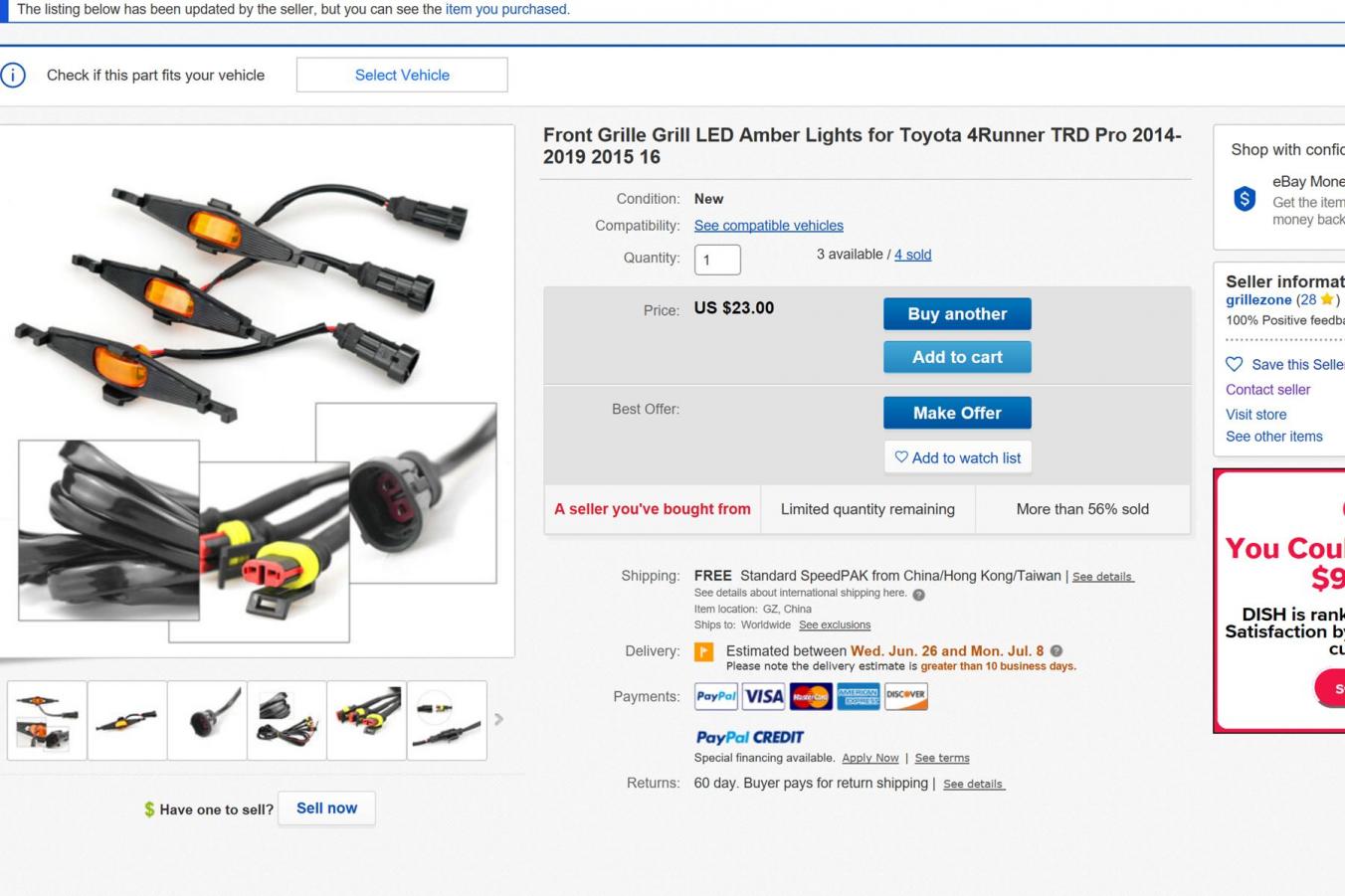

Anyone install these China Raptor leds from EBAY.
Looks like they should just click in from the backside, I can align it ok but wont stay. I must be doing it wrong. Pls save me as I had to walk away for a while, too frustrating for something so simple.
I sent a email to the seller but these China sellers rarely reply with anything useful.

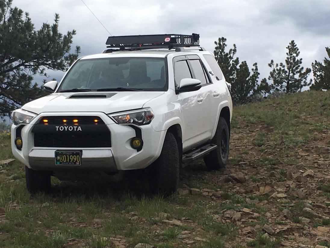

The Cartrimhome ones actually click into place from the front. Note that there are two slightly different sized "diamonds" in the grille opening pattern. The Cartrimhome lights fit into the smaller of the two diamonds, so you can't click in three lights with the middle one centered for the classic three light raptor look. It's why I have four lights on my grille (plus they come in sets of four). Yours might be sized for the slightly larger of the grille openings?

Seller was no help, says no install instructions avail, send a pic of problem. JOKE! Good point on the different opening sizes.
I'm going to pull off the top grill piece and work on it on the bench later today.
Option A- make it fit with gentle persuasion
B- gorilla glue it from the back
C- black zip ties
It's going on 1 way or another.
