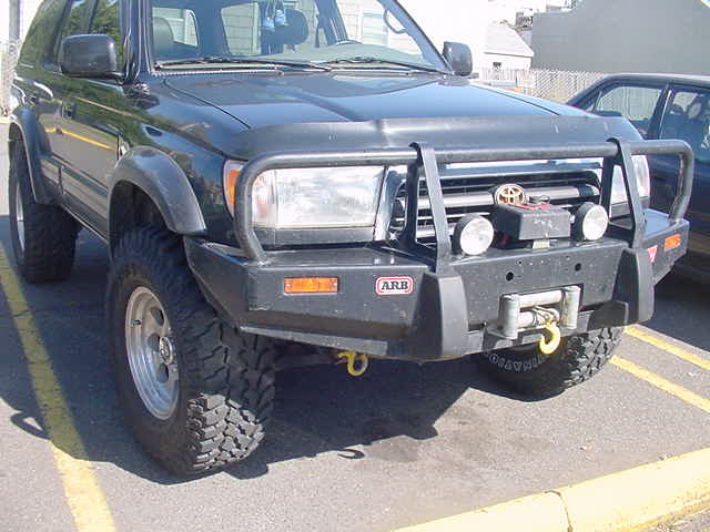

i ran baja claws for a couple of years,
got more mileage than i expected.
loved everything about them EXCEPT
no traction when side hilling.
i just got some firestone mt's last week,
so far so good.
no mudding yet just rocks & soft dirt.
i stepped down from 305's to 285's because
they didn't have them in stock.
$ 125.00 a piece no bad
eric
hey man nice 3rd gen. Have a website or more picvs or any thing??
