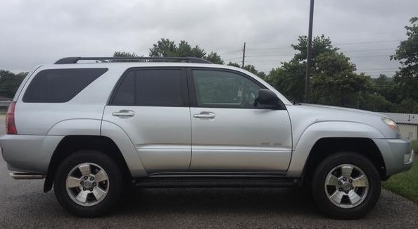

I'm not sure where you're at with your suspension upgrade but here are some pics of my recent Taco/FJ swaps. The 1st pic is the Taco swap and the 2nd pic is both the Taco & FJ swap together. I hope it's helpful.
-1st Pic: 2014 Tacoma TRD Off-Road front Strut/springs & rear shocks (Total lift: 1.75") ...............................-2nd PIC:2013 FJ TT rear springs (Total lift: 1")

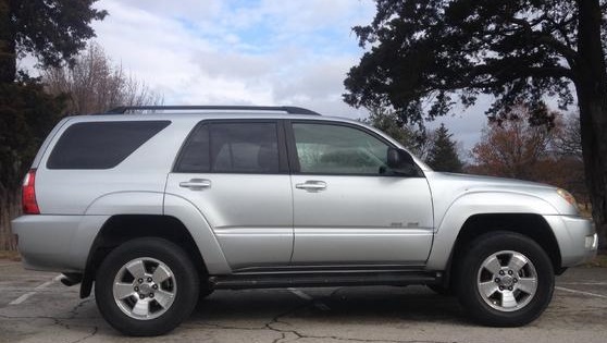

Since I never posted a picture of my truck after doing this swap, here it is. This is with Taco springs/Toytec 1/2" spacers on the front and FJ springs/Daystar 1.5" spacers on the rear. The ride is very good with this combo.
Best looking nautical blue paint I've seen. Tell me your secrets. Mine is so hard to keep clean and has swirl marks :(
No secrets here. That picture makes it look nicer than it really is. With 200k miles on the clock, it has a ton of rock chips on the front end. The right rear quarter panel was damaged at some point and the paint match is a bit off. Looks good from 20 feet or greater.
