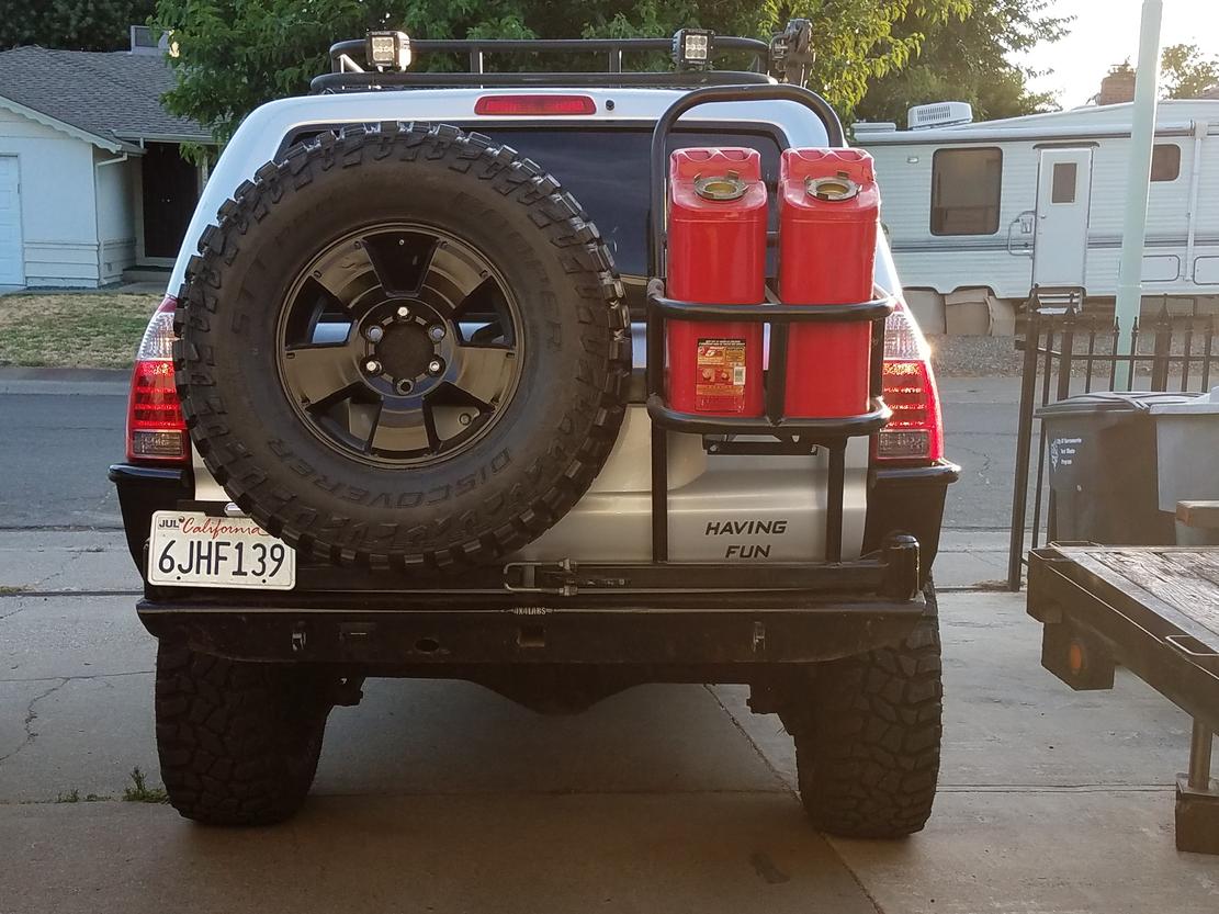

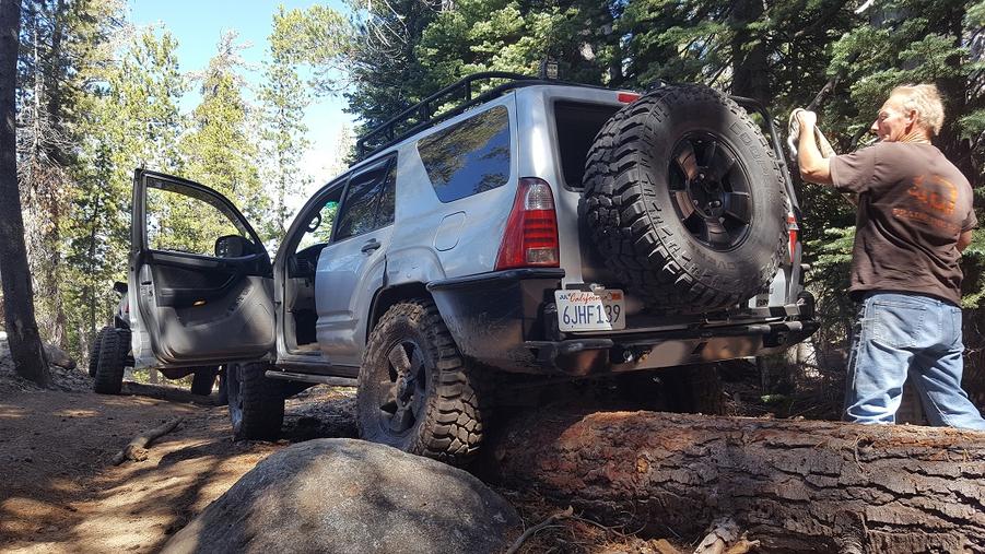

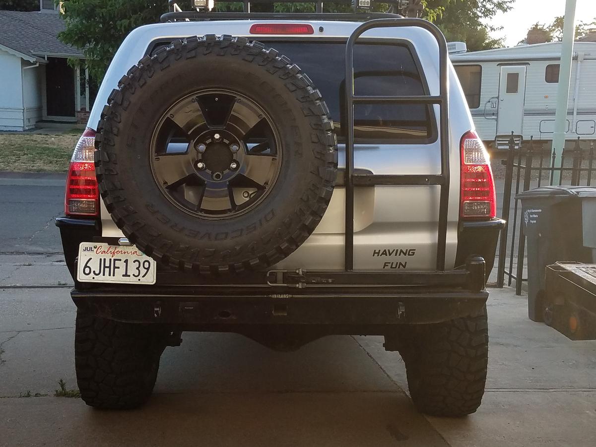

Finally had someone bend some tubing for me so I could weld up a ladder on the swing arm.

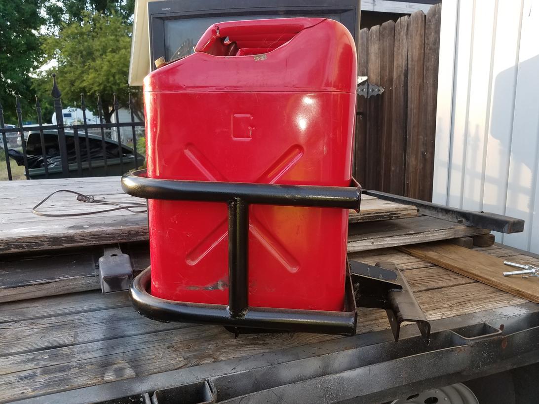

In addition, bent some additional tubing to make a Jerry can holder that is removable.
Tax time was good. So hooked her up with some Icon 56550 LT shocks. Now I can utilize them Overland coils. Had to put some off set MT trailing arms also. She flexes now.
Changed out all brake lines to braided.
Tires where getting worn out, so up graded to some 315 Cooper STT PRO.
Extended bump stops. Relocated the license plate, and shifted over and lowered the tire carrier. Dayum tire too heavy to lift that high.

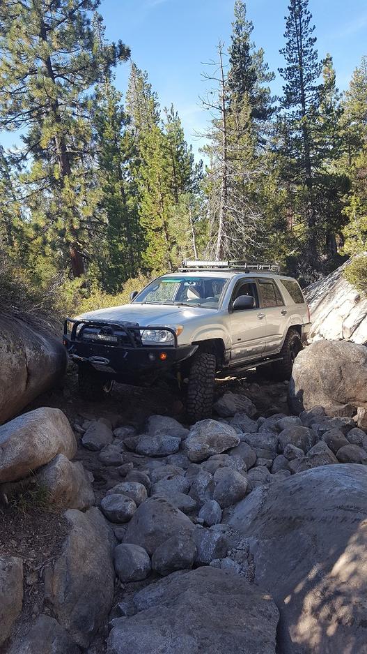

Slick Rock and Deer Valley. You needed some wheeling pics.

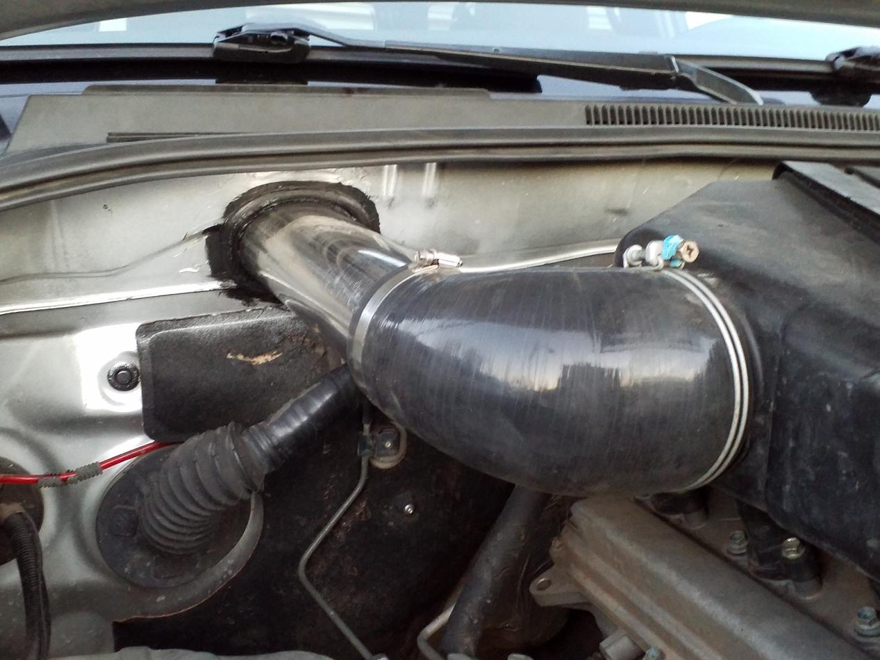

Periodically, I find a few drops of water in the air box from going through small rivers, too much liner cut out. Snorkle out off the question as I tend to go into some really ruff tight spaces in the woods. So decided to do the Cowl install.

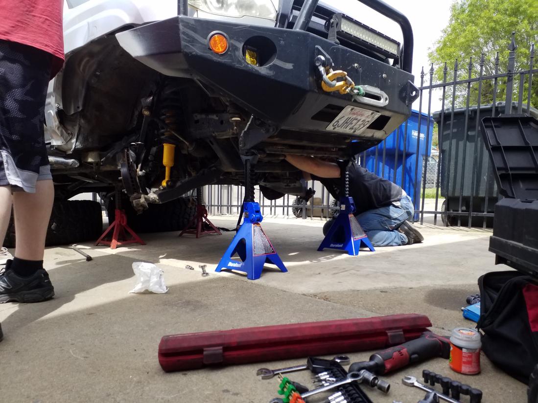

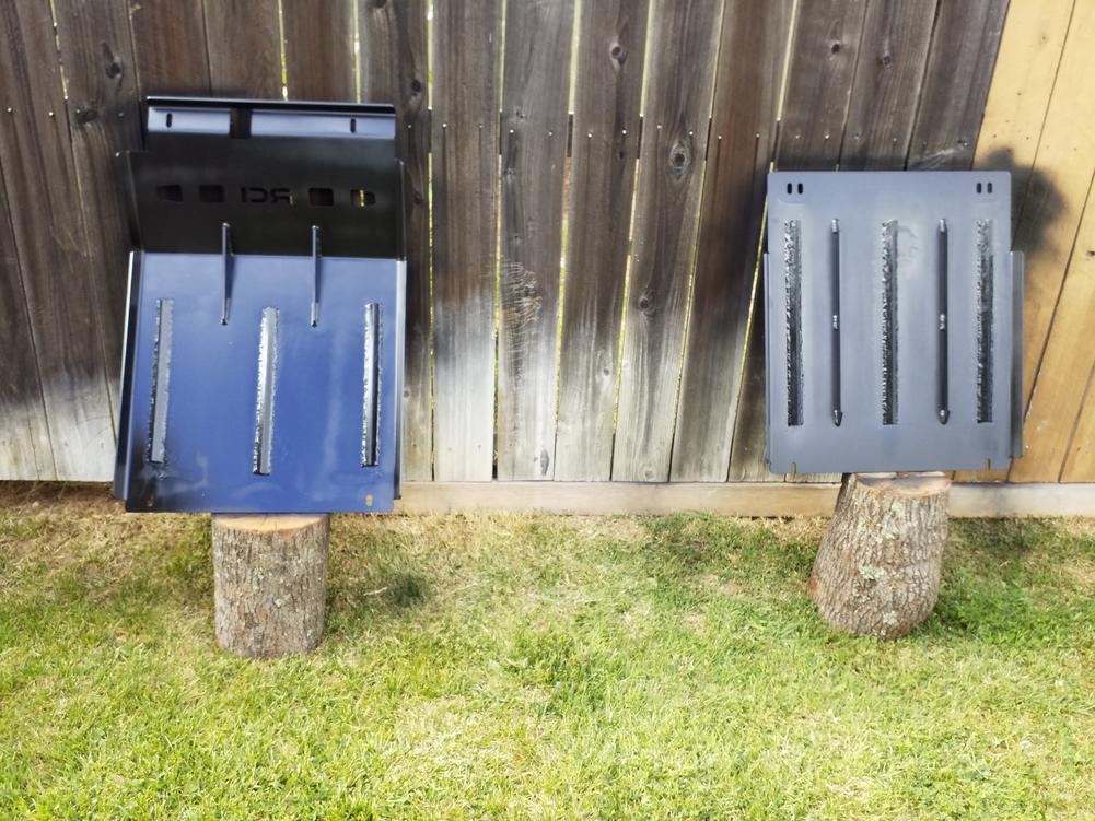

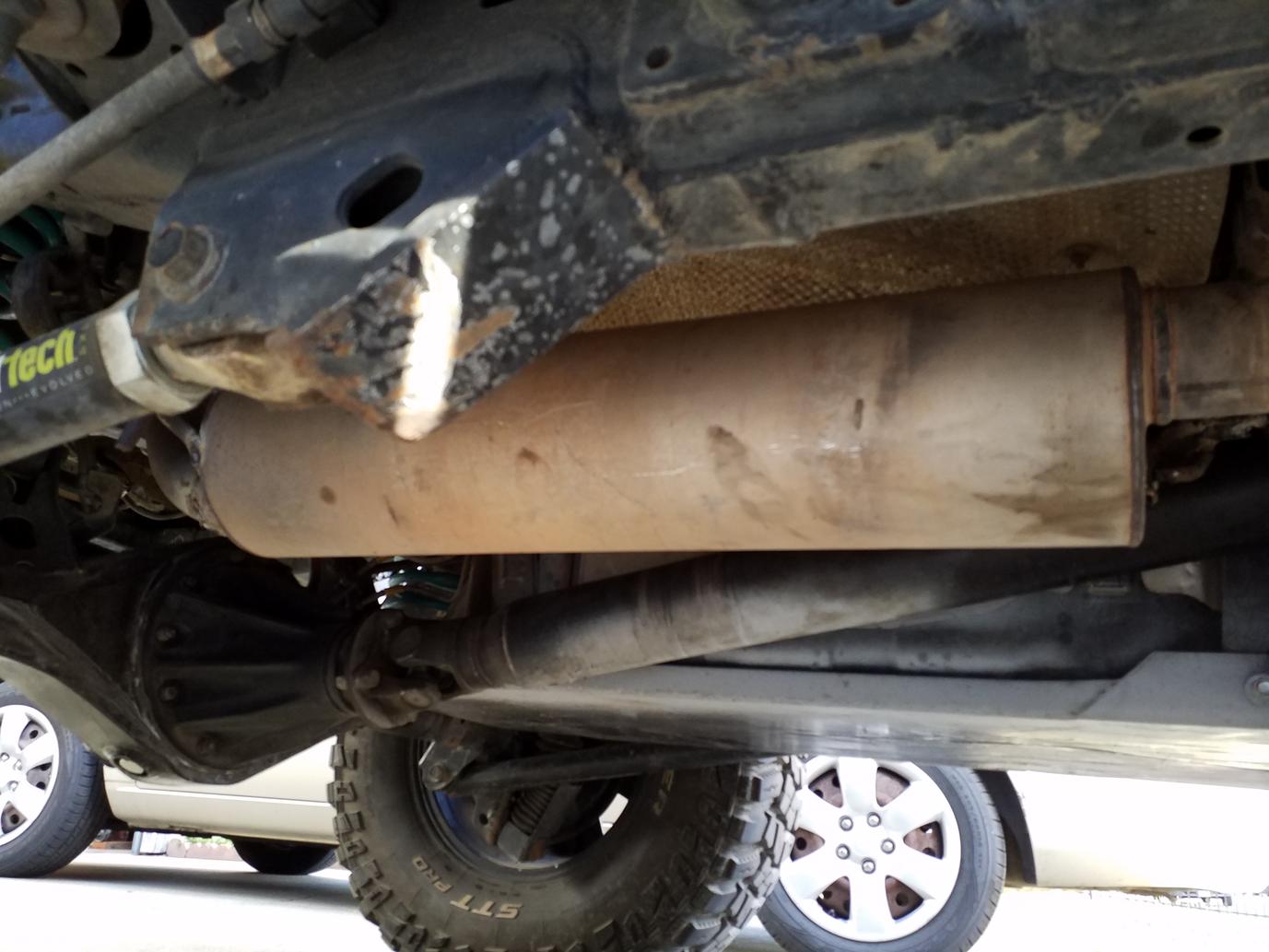

Time for some updates, and up grades! Aluminium skids just wasn't holding up to the abuse I tend to give out, so ordered steel ones. Since they where new, decided to add some extra reinforcement to them. I passed my old ones onto [MENTION=87687]LTDSC[/MENTION] as he has none, and he was so kind to pass on his old Gibson muffler. Thank you sir!
This all happened at a mod day I through at my house. [MENTION=157695]theoutbackdream[/MENTION] was kind enough to make a showing, and gave him my OME reinforced lower links. [MENTION=113049]rochmpr[/MENTION] was so kind to come a little early and gave me a hand at predissambling my front end for a regear change/swap.
Changed up to 4.56 gears and through a True Trac in the rear.

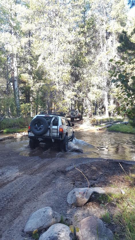

A few from Signal Peak on 6/9/18

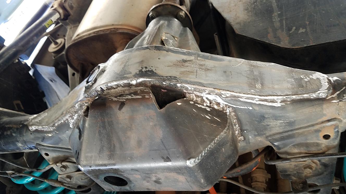

When I did my regear, decided to ad a FJ rear diff cage and ad some 3/16" flat stock on her.20180407_162701.jpg
