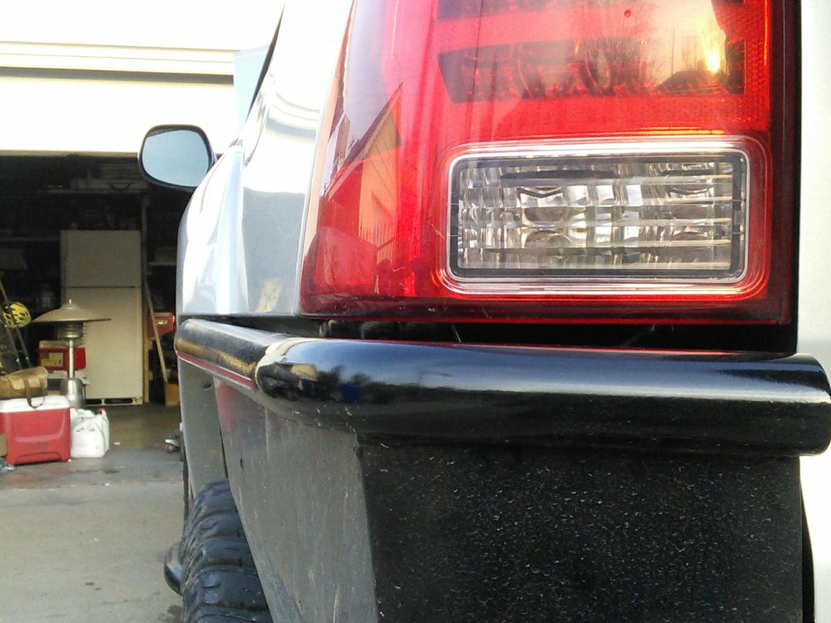

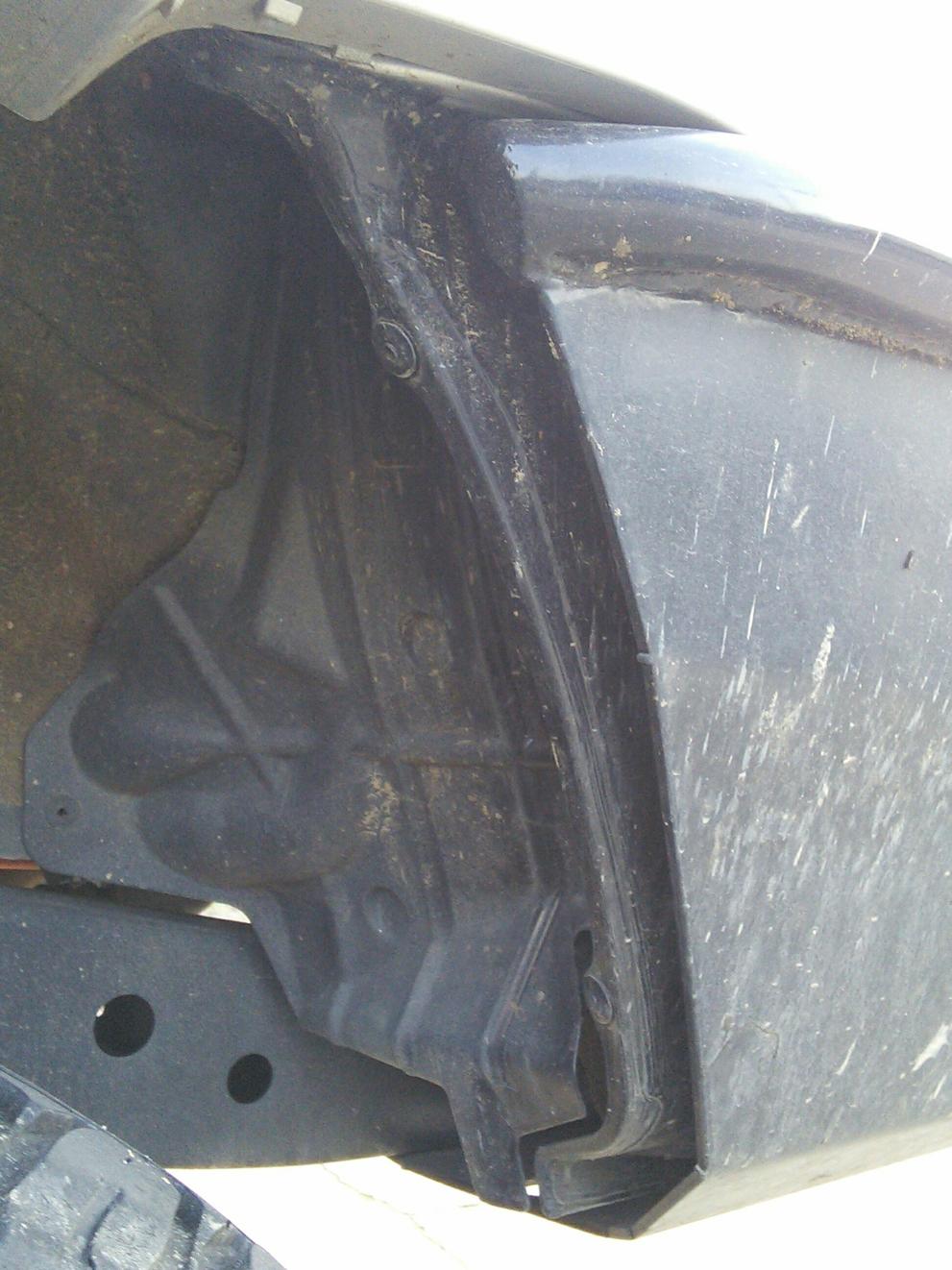

As far as the rear pinch welds. I snipped about 1.5" at the top then folded them in and pounded them back about 2 inches. Picture was before the rear bumper.
/\ Pretty much what I did. Don't think I will have to cut the bumper for 34" though.
I might have to pull the bumper off and smash the inner body in some so I can add some extra steel at a 90* angle on the ends @ the wheel well area. noticed it pushes in at that area when taking a hit.

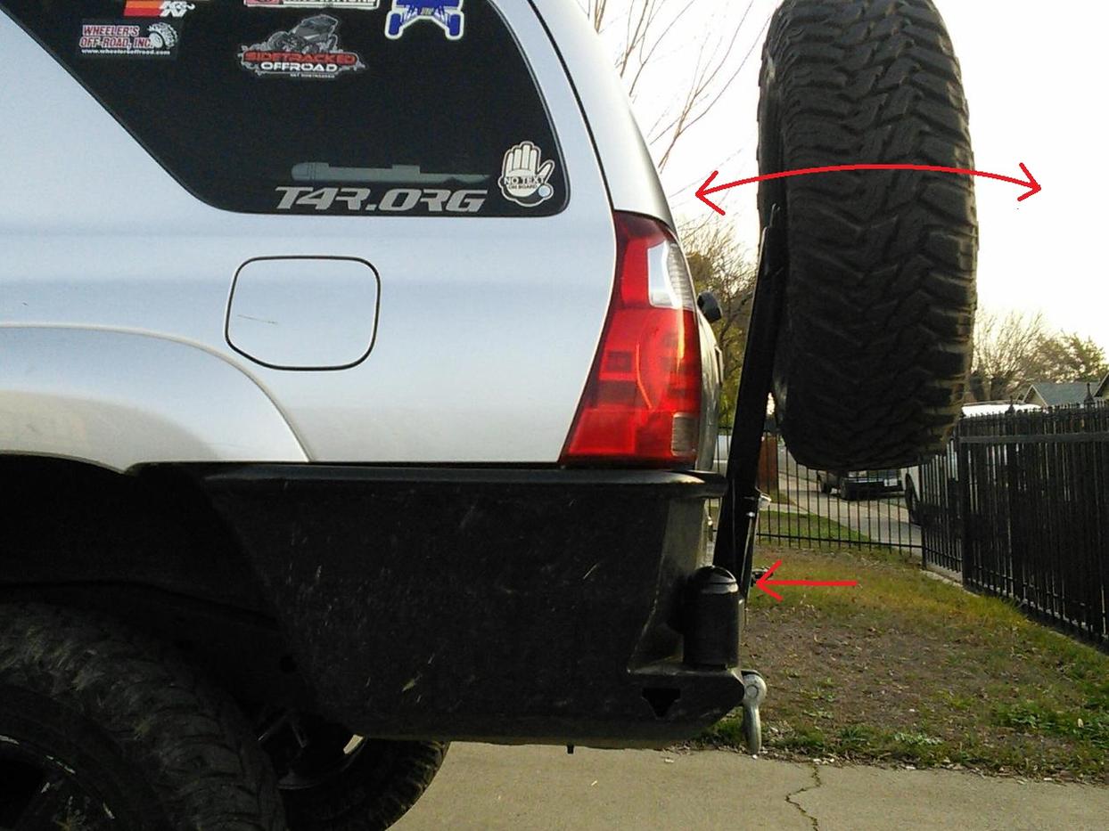

Do you notice any flex on the tire carrier? That's my biggest concern with 4x4labs design.

I don't think the (any) flex is in the tire carrier, I do believe it is coming more from any bumper mounting to the frame. As my SW front and others, they have a gap below the body line for this.
Mine as far as the rear on the stoppers, as I put in that build thread, the location spot, place it on the bumper and make sure your hatch door clears it for location. I put mine a little closer, so I had to cut the height down a little. So in doing so, on flex, allowed it to bunny hop above it once. I added a bead line weld on the stoppers themselves.

When I spoke to Luke about this kit for my 4th gen he stated that the horizontal tube that the tire carrier mounts to is the source of the flex, as it wants to twist from the weight of the wheel and tire in regards to how the tire carrier mounts to that horizontal tube.

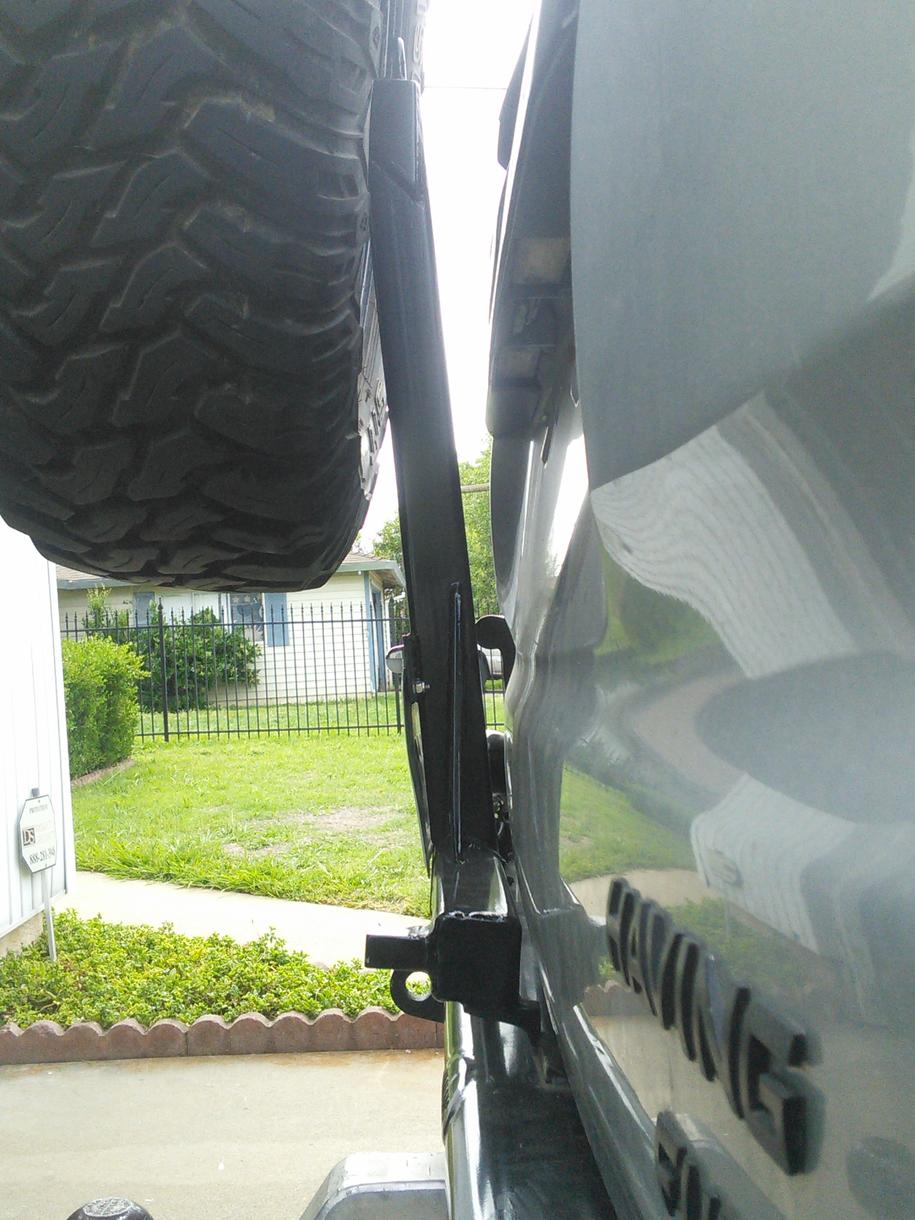

That tube is .25" thick and the spindle housing is also. A lot of metal to try to flex. My gusset I added is .25 thick also, you could make a longer one to help with that I suppose. The spindle itself is rated @ 4000lbs.
I'll see about running over to my flex loading dock area and see if it shows any height difference for you latter.
If any flex I would see is from bouncing with that weight on principle.
As far as the tubes sticking out, as your going step by step building this bumper, you can pull the sides out farther, and the back pieces are longer for cutting off to fit. Same with the top tube can cut down to fit from both ends.
I did just put my weight on the arm and it dropped about 1/8".

This is the flex i'm worried about. With the bending occurring at the bottom red arrow, and more specifically, twisting the swingout along the length of the bar. Like a torsion bar.
I need to do this. I flexed the rear out almost all the way and cut up my brand new Toyo MTs a little bit.
