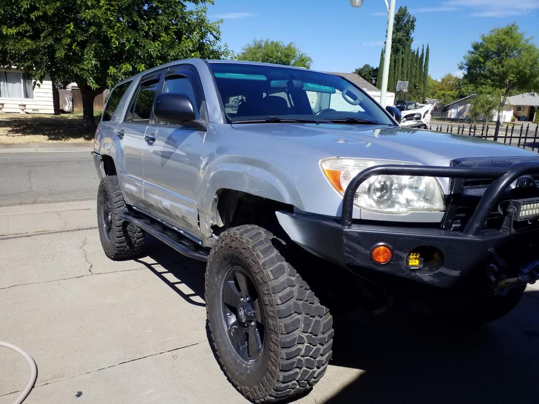

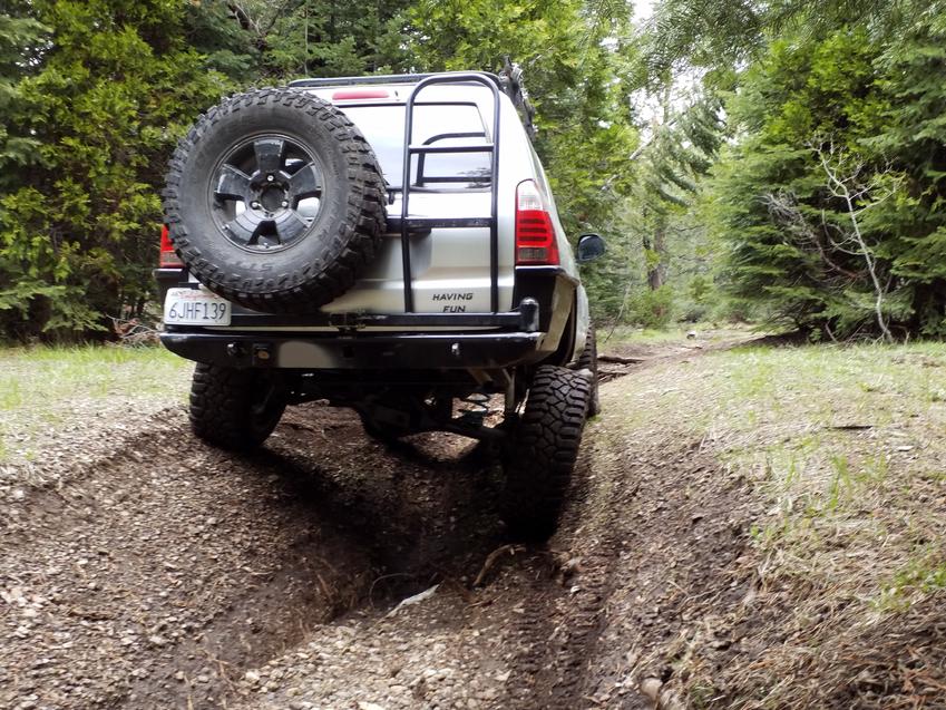

Took her out and found this flex spot. Still has a slight tank rub. Cut it out, need to see if that's it.
Painted slidders again. Then had my buddy do a claybar/wax to her. Took all the yrs of overspray and greasy hands right off. Looks almost new again.

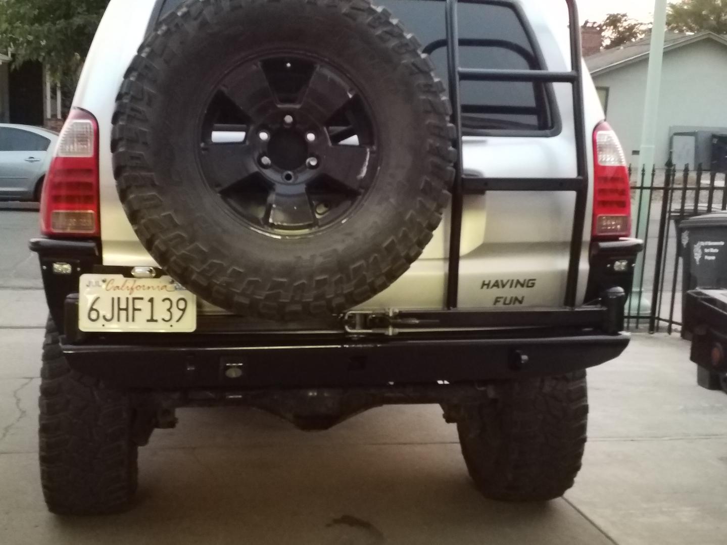

Done adding to the bumper. Added some lights in it, Luke should just do this to them IMO, and got it painted 1 color again.

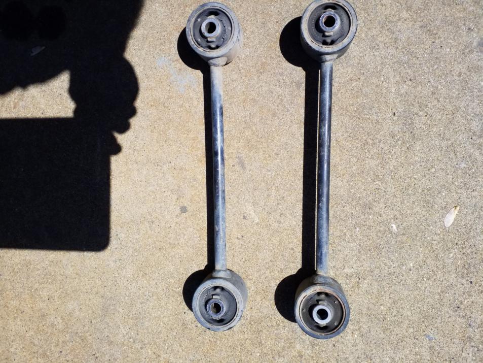

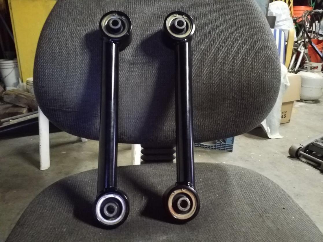

These upper links finally couldn't handle the flex stress I putting them through, so had RENZ Fabrication hook me up with some dbl offset arms, with Metalcloak bushings. Had him add a little more length to them for my pinion angle,

Well had to do some more things to keep her in shape and hopefully not break on me.

Man, I have got to do this sometime soon. I feel like these rear links are just tooth picks. Looking through your thread has me feeling a little more motivated to get my work done on my truck.
PHP:
q
They are in comparison. OEM bushings where getting pretty bad also.
Depending on your lift height, add some length, and more flex able type bushings.
I come close to maxing my shocks out and there the longer ones. Lower links contact my axle at drop.
