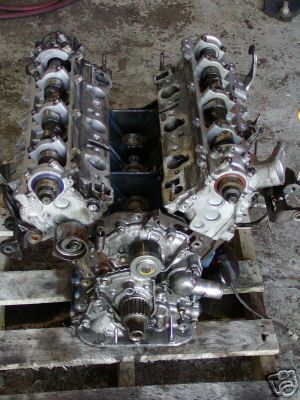

That sounds so logical it's almost funny. I haven't had a chance to try it, but I can see how that would work. I know the bolts you're talking about so shouldn't be a problem. I've got my engine sitting on an engine stand with new one on the way (see picture).
One other question for you pro engine guys. I'm planning on swapping out the following for new. Anything else I should think of replacing while I'm doing this:
Water Pump
Thermostat
Idler Pulley's
spark plugs
timing belt
fuel injectors
Someone suggested replacing the Cam Oil Seals because they dry out easily. Is there anthing I need to remember when doing this. I've taken these out on my junk engine, but when replacing on new engine (see picture) do I need to be careful or do anything special?
Any help for a novice would be GREATLY appreciated!!
Steve
[email protected]
