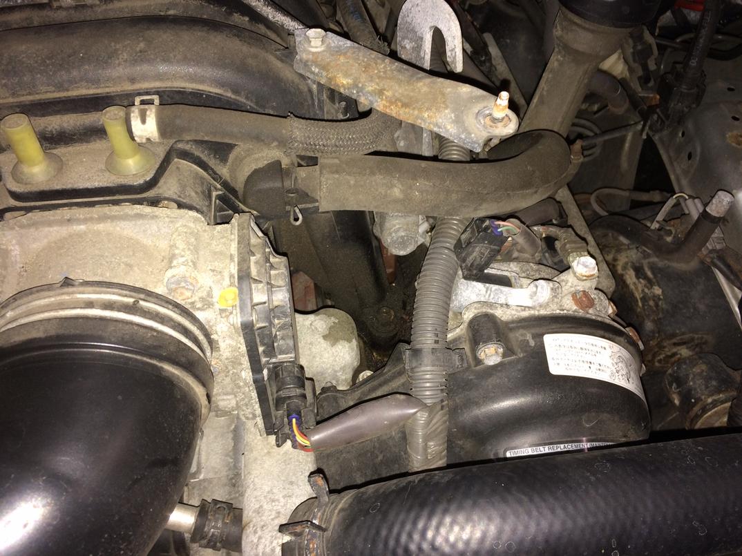

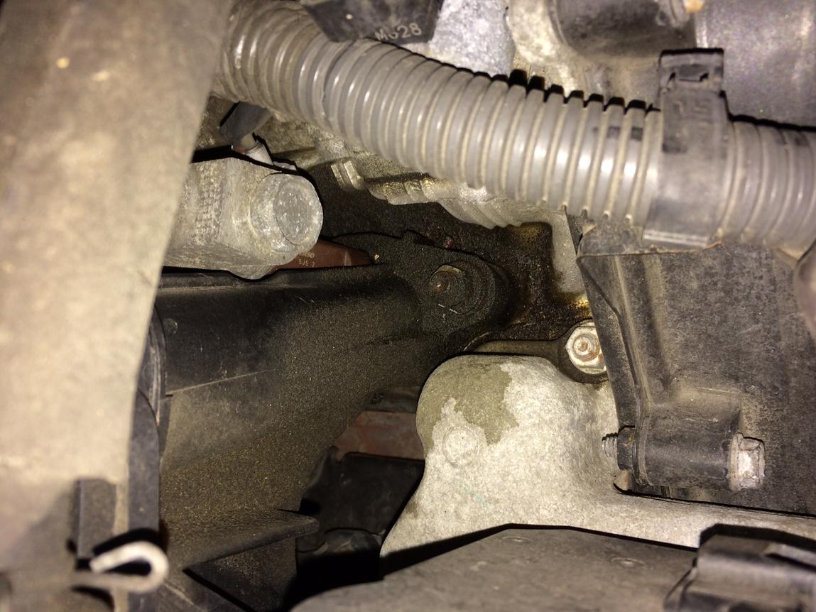

I thought my valve cover gaskets were leaking oil, however after looking closer it appears to be a different "gasket". It is a very slow "weeping" coming from this corner. I checked the bolt and it is tight. Its leaking from the front drivers side corner right next to the valve cover.
No noticeable oil loss on dip stick during oil change interval of 5k miles. 186k on the odometer.
Any idea what this might be?
