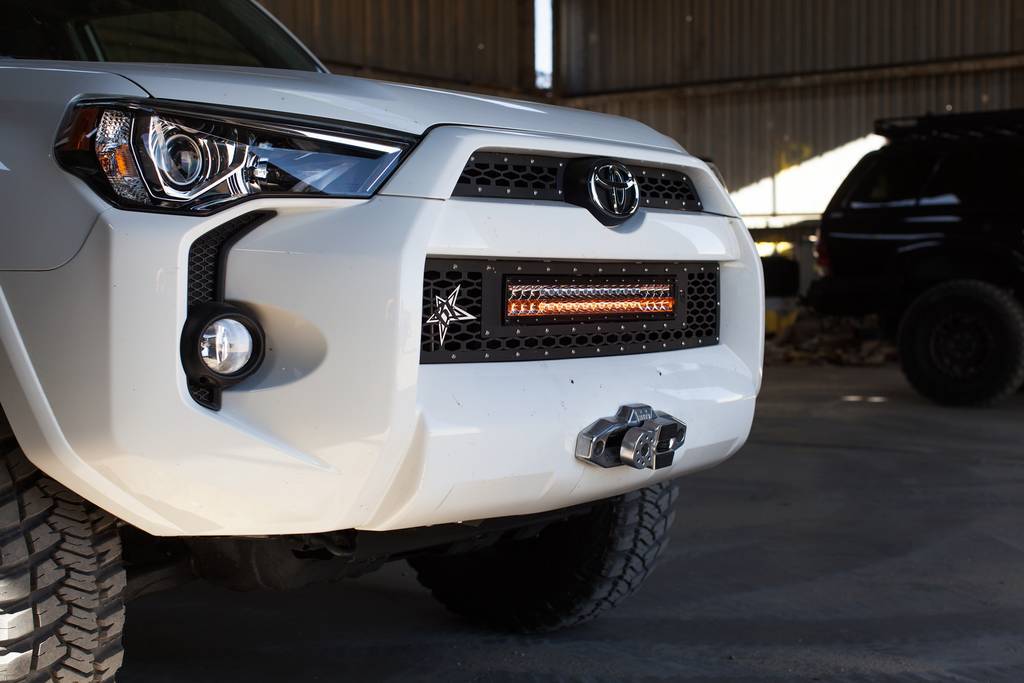

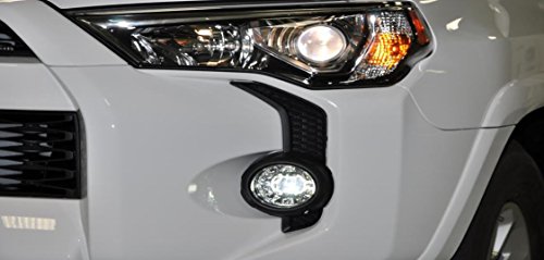

I ended up with "Southeastern" Toyota's OEM dual purpose LED fog & DRL (ring).
Actually, I have a Rigid 5th gen+ Front Grille on order, with the dual color Amber/White 20" E-series, that would be the BEST solution(amber bar) for getting you visible light thru foggy mountain roads.
* Rigid Industries 5th gen+ (2014+) Front Grille
* 1x Rigid 20" E-series Dual Color Amber/White (Grille Front) SKU: 120312AW
