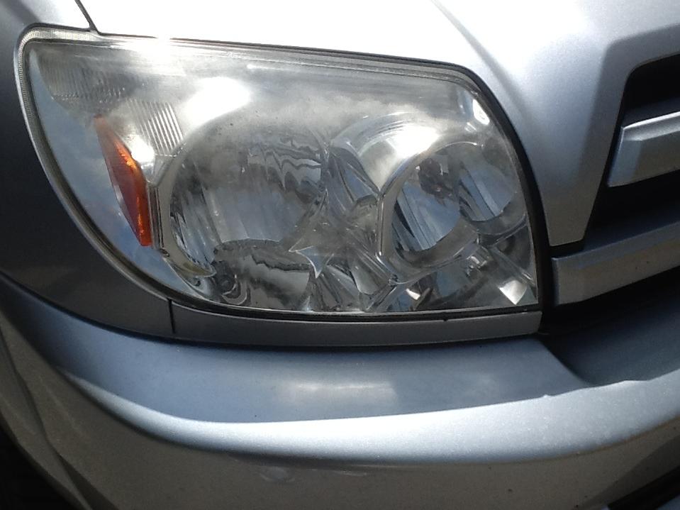

I am wanting to replace the dulled, scratched headlamp assembly for my 93K mile Sport Edition. Looking around online, found the assembly (at a surprisingly decent price) from Rock Auto.
1. Has anyone replaced this assembly to a like-new condition?
2. Is there a better retailer than Rock Auto?
a. Has anyone had a problem with Rock Auto?
Thanks in advance.
Matt

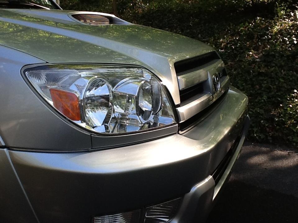

Well, I finally did my lights using the 3M Kit, purchased for approx. $20 at Wally World.
I do not think I could be much happier with the results. Outstanding for the price.
I had a difficult time finding the product. I was searching the car care section - but here it was in the car repair section (near the Bondo and sand paper).
I did not think my lenses were terribly yellowed - but I took my time. For both lenses start to finish, 90 minutes.
A couple of observations:
1. I used Frog Tape around the lights. May not have been strong enough. Burned through once or twice. A little collateral damage.
2. I was shocked at how much rubbing compound I splashed in the last step. Do not keep your hood up - otherwise you will be cleaning overspray out of every nook and cranny.
3. YouTube 3M and watch the demo online if you are uncomfortable taking a drill to your headlights.
A big thanks to all for suggesting this route.
Here is an after pic:
