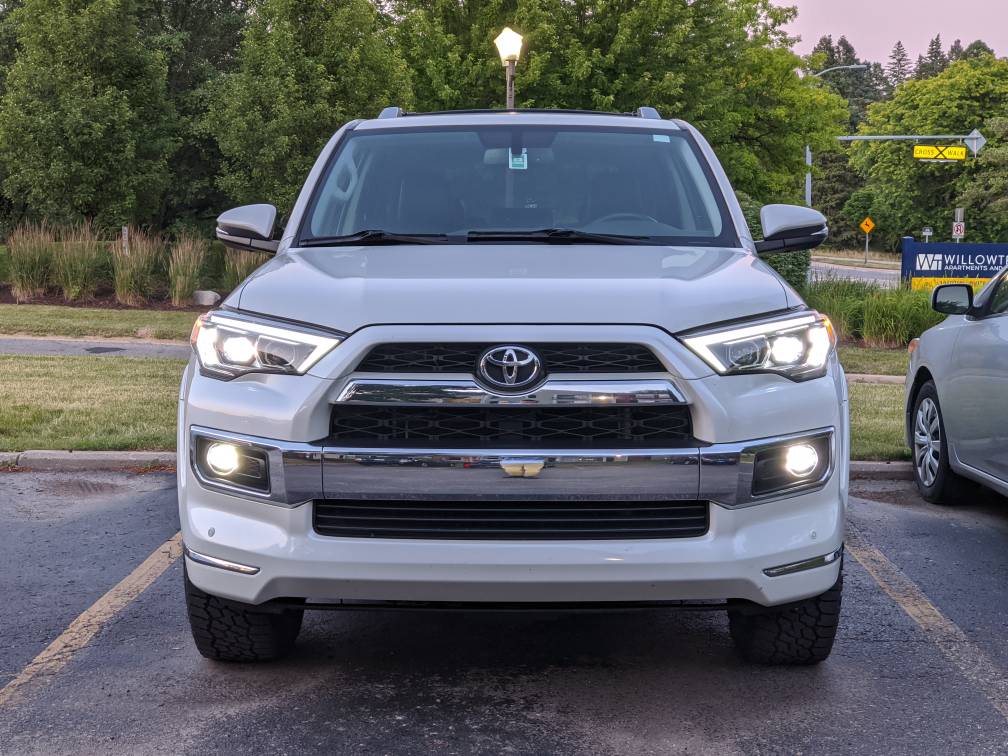

I installed Nineo H11 along with dual color switch backs in fog light housing.
cutoff is great with no glare to traffic.

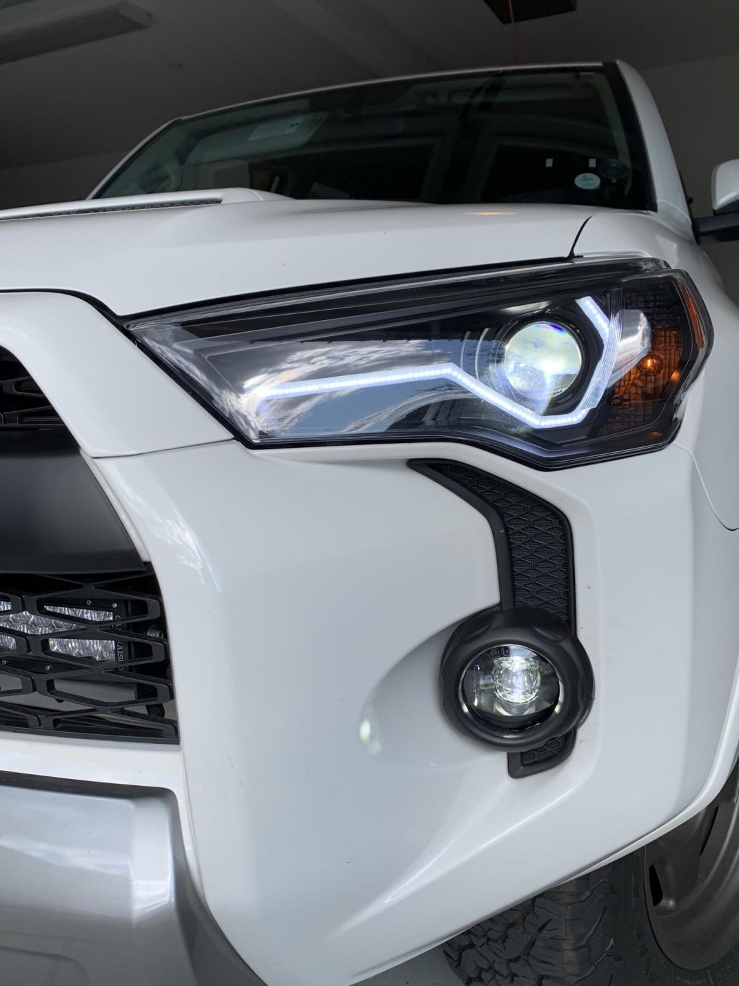

I went with Kustom54 AB6’s with the Morimoto MLEDs BiLED projectors. It lights up the road really well by itself. I also upgraded the fogs with Toyota OEM LED fogs (replaced BD Squadrons which I didn’t use much). The combination is amazing.
Those look nice. I also upgraded the fog lights with the OEM LED ones as well. Thanks for the suggestion. I’m going to look at these.
