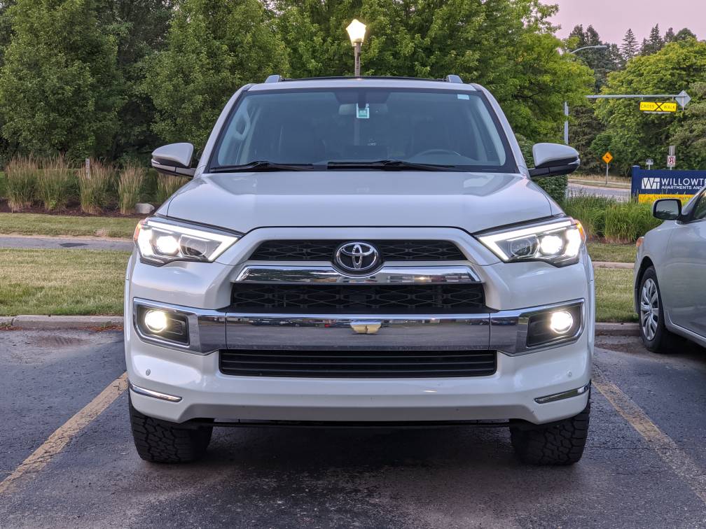

I'm literally driving to Colorado right now for my vacation. I have the Alpharex Luxx's and they've been fantastic so far. Just went through a torrential storm in western Illinois that reportedly had 70 mph winds and had no trouble cutting through the rain combined with the newer style OEM LED fog lights.
I came out of a 2018 IS350 and I would say these are pretty comparable in performance. The output is nice and even and has pretty good width. My only complaint is the cutoff is a little sharper and deeper than I'd like so I had to raise them to cover more on the left.
OEM fogs add a TON of width and good foreground light. I tend to keep the fogs off when I'm on the highway to cut down on foreground glare and preserve distance vision.

I was gonna ask if this works on the limited till I saw the front end. I have a nightshade and want this same exact setup! Thx
