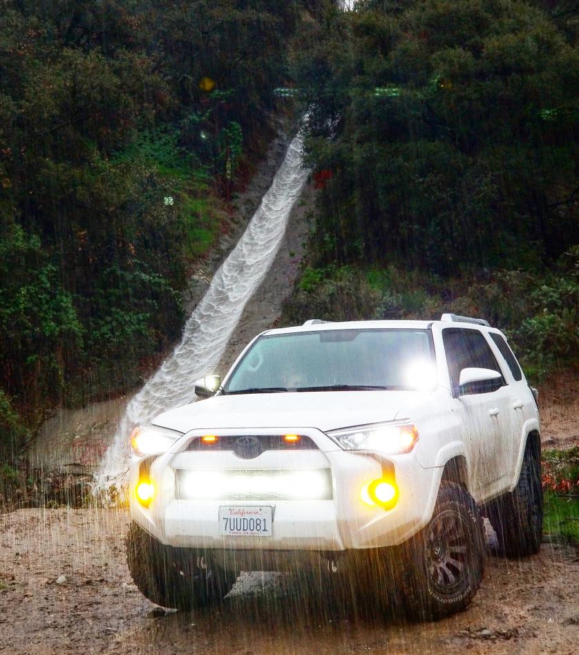

I have 5500k HID's in my lows & 3000k LED's in my fogs - both branded by DDM Tuning out of Huntington Beach (they have an actual store you can go in and work with in person which is awesome). Never one issue after being installed almost 2 years...I get flashed all the time - but no one ever shines their brights at me.
giggity
