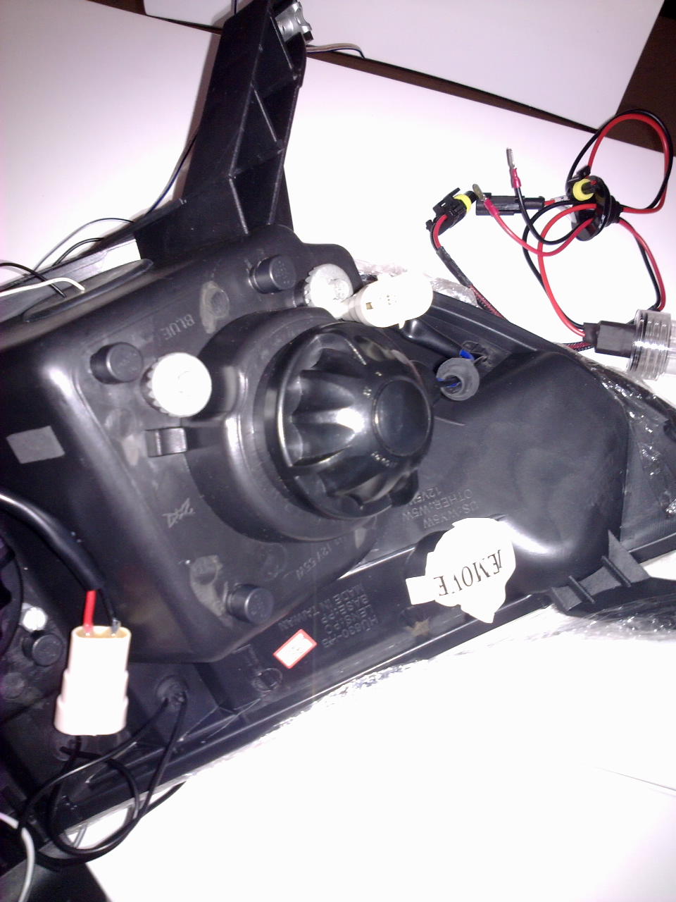

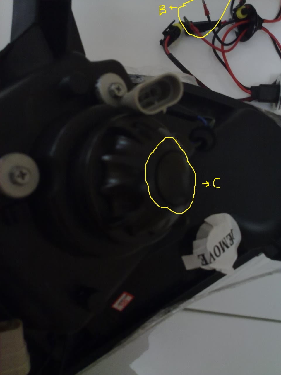

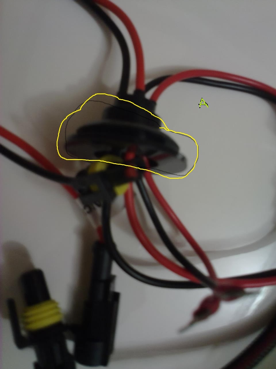

see the pics of my setup....when i ordered. i ordered the hids as an extra option, so the setup was pri,marily a projector angel eyes based - plug and plaay.the ballasts are normally. my problem is with the items circled in yellow
the cable ends mrked b... i believe is the input voltage for the ballaasts....but where do i hook them upto?...dont think its safe running them direct to the battery.
the black plstic cover marked c, i think i need to cut it up to pass through the rubber gromet marked a?

i hope the pics above are self explnatory....for aa projector assy its plug and play...but i run into some hitches if i want to hook up the hid option

Right - so the wires "B" are for an H1 style harness, but your truck has 9006. You have two options:
1) attach a 9006 harness to those (buy one and splice it one, I used one form the set of 9006 HIDs that I had in my reflector housings)
2) attach the HID wires directly to the factory headlight wiring, removing the harness altogether - free, but PITA when you have to change a bulb or remove the assembly. I recommend option 1, harnesses are cheap
As for cover "c" you need to drill a 1" hole to allow the grommet to fit in place, i can take some pics of what I did when I work on the truck later today

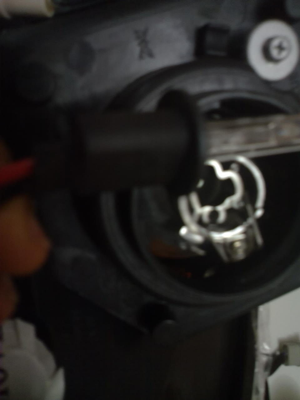

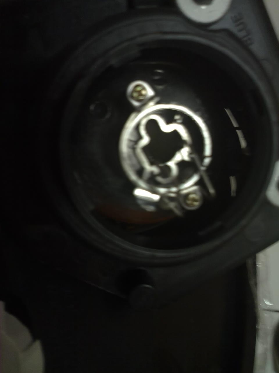

also noticed that the hid bulbs will not fil properly in this bulb holder........any way around it?

i bought from spec d.......they werent pre instlled....the hids cme as an option for $35 extra or so.....really quite unhappy how it turned out... i might just stick with the [special] halogen bulbs that were preinstlled......n leave out the hid/ballast option... they said everything would be plug and play...but its not turning out to be so.... i could deal with a lil cutting of plastic and splicing cable.............but this bulb fitment issue... i really dont hv a clue
