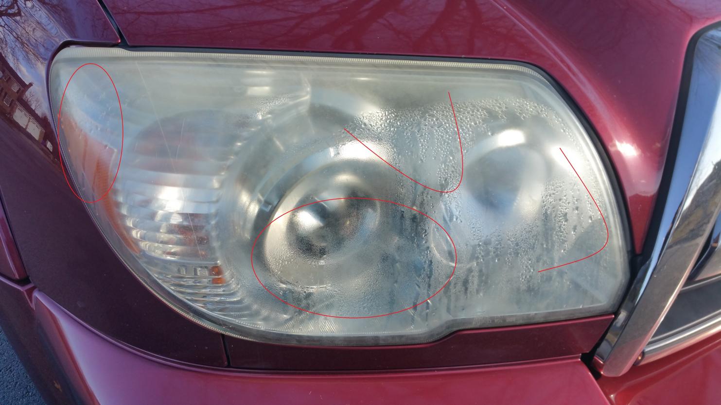

Guys, before even i proceed with "sealing" headlight, does anyone have any idea how to clean-up all that "watery mess"?
pic attached
pic attached
I pulled the low and high bulbs out. Stick a blow dryer to the high beam socket and waited. Eventually, they'll dry up. Heat the plastic from the outside helps too.
That’s how I’ve usually done it, but in addition to that, I’ve taken along section of paper towel and twisted it into a diameter that can fit through the bulb hole making sort of a wicking rope to dry the puddles first. Usually I bring it in the house, flip it glass side down for a short time so the water pools. That makes it easier to wick up the bulk of it, then I use the hair dryer to evaporate most of the remaining moisture. It still helps to leave it in the house at least overnight to continue drying out. I run a pellet stove for heat this time of year, so I leave it near that, which helps a lot. I just wish I didn’t have to keep doing this! At this point, short of permanently sealing around the bulbs with silicone, and blocking the vent, I’m out of ideas. Who knows, maybe the adjusters need to be sealed too. Wish I could trash the vendor on Amazon, but they won’t allow me to post a review for some reason...hmm... wonder why that is...?
from my headlight experience, to dry the lights out, you need to pop it in the over and bake at 250 for 10 mins, at this point, if you decide to seperate the lights and paint, this is good time. now to clean inside lens, use distill water and super fine glass cloth, like the ones that come with glasses.
before you put it in the over, you can drain the water out first.
now for sealing it back up, i stick it back in the oven, for 10 mins at the same temp. then press it together, after that, put it back in for another 5 to 10.
give it a final squeeze and let it cool off, dont forget to put the screws back in while its still warm.
to test if the seal is good, i use a pressure washer, something like 1500 psi at the widest nozzle. spray top to bottom, might as well wash the truck too. now see if it still leak.
I wish I had just tried that right from the beginning. Now that I’ve beaded them with silicone, it will be much harder and require quite a bit of work to get all that cleaned out prior to baking, which is why I’m just going to replace them instead to save time. If I decide to use them for a retro, then I’d have the time to work on them at my leisure without tying up the truck at least.
well, if your lights are out the truck, i still suggest you to shake out all the water and use a air compressor and spray it dry, you might be surprise on how much water was trapped in. either way, if you want to do the retro, i use the old lights as practice.
