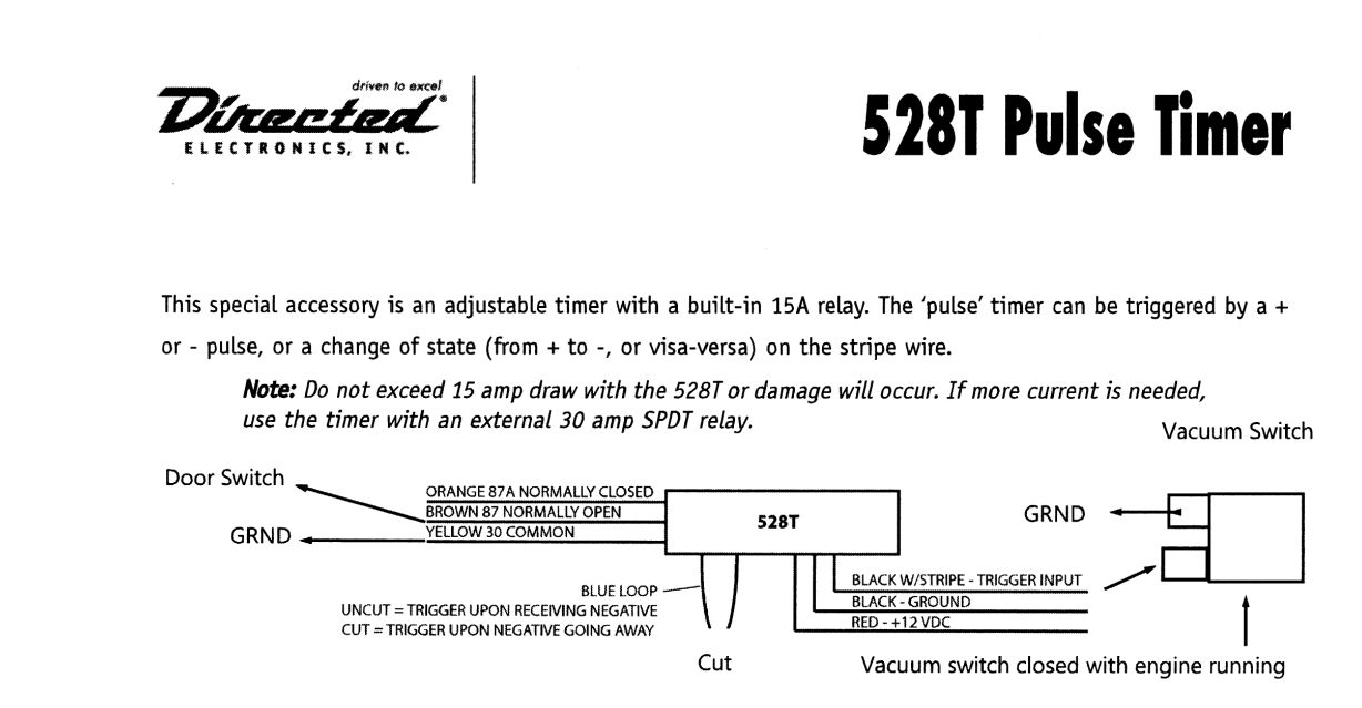

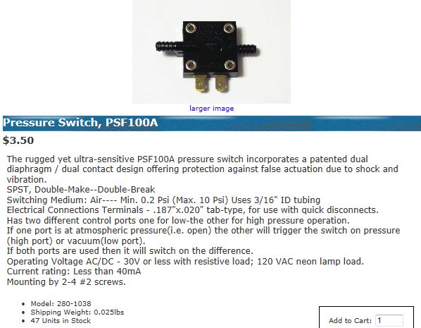

I had the same problem with a 2003 Limited. I created this to fool the system to thinking the door was opened. The Pressure switch grabs any vacuum source that only exists when the engine is running. This creates a ground. The delay timer loses the a ground pulse to the relay trigger when the vacuum is gone. The delay timer is set to trip when it loses the ground. This delay can be set from 5-90 seconds. Then the timer sends a ground pulse to the door switch. The delay relay is about $15USD and the vacuum switch is about $3.50USD both are available from an online sources.
