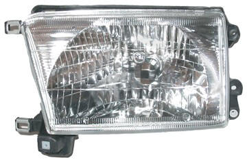

yes, basically what toyota did, is they changed the lens... instead of having all of those cuts or "fluting"(those lines in the casting, that go up and down and side ways and angles ect -they help channel or disperse the light to where it needs to go ) in the lens that the 96-99s had, in 00-on they gave the trucks a perfectly clear lens and made the reflector have all the cuts or fluting in it, and it works better, the fluting in the lens "soaked up" some of the light output and you would lose some light.
see the difference?

So my best bet would be a set of 00 assemblies with some Sylvania bulbs..??

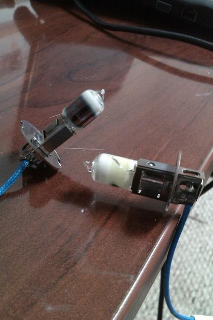

two different H3 bulbs by sylvania from different lights in different trucks out of different packages and both did this in less than 2 months, and again they are not head lights, these where in fog lights i had, still have and use.
