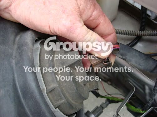

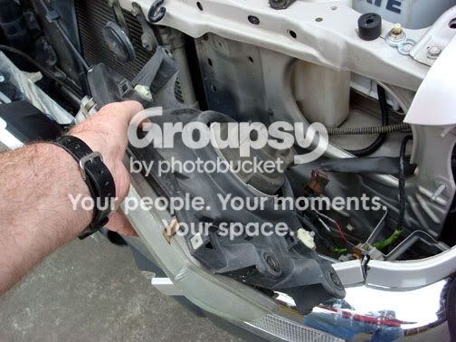

So you're looking for the stock headlight plug that comes from the factory wiring harness and plugs into the back of the H4 bulb. I pulled a few images from google
Headlite017.jpg~original
hanging in this pic
Headlite018.jpg~original

For the headlight connector: Any 96-02 4runner will have this. Plenty of partouts to choose from in the classifieds.

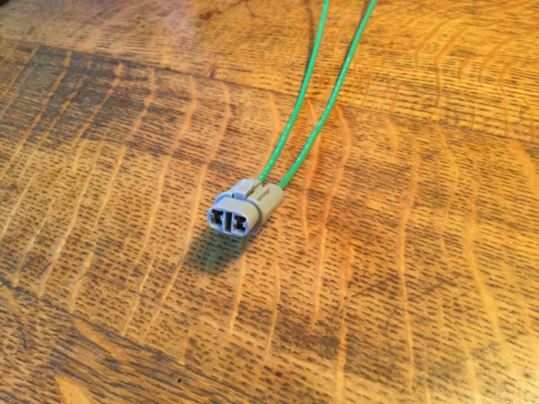

Hi, I need the part number for this cable shown in as a attachment photo I cant seem to find one without part number also The original connector melted into the blinker assembly so I replaced the assembly but I was unable to find this cable. So I had to tape the wires inside the connector but evey time I hit a bump it comes loose please help. This vehicle is a 1997 4Runner and the cable connects to the blinker on the bumper and I found a listing for a subaru vehicle but it is already sold Gray 2-pin Turn signal Connector Pigtail for Subaru JDM Legacy Outback | eBay
