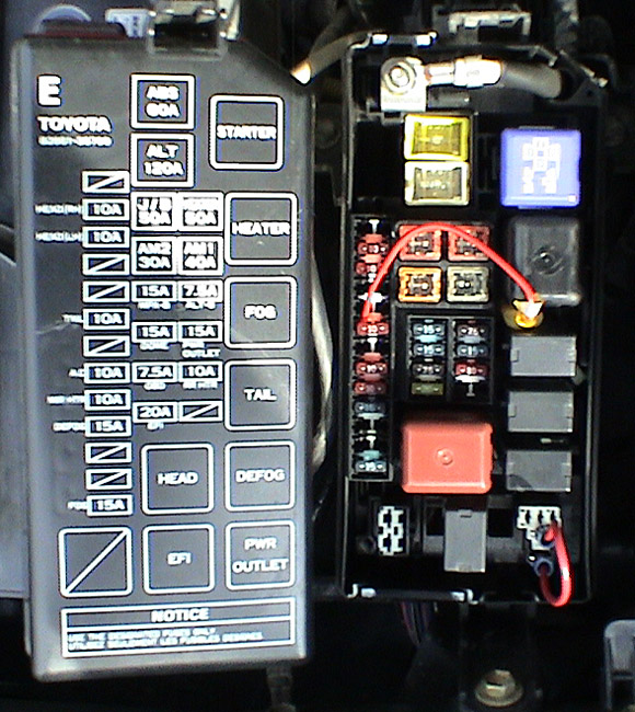

First, pull the HEAD relay in the engine room fuse box. That should kill the lights. Then we will worry about those later.
Next is to check all the major fuses. These are the square plastic thingys with the plastic windows in the pic below. We are most interested in the 120A ALT, 50A J/B, 30A AM2, and 40A AM1. Some of these biggies need to be unscrewed from underneath if you have to change them. I am not a fan of visual checks of fuses but I suspect you will see one of these is burnt.
I cannot for the life of me figure out how this symptom set could be caused by messing with the door. But we will figure it out.
