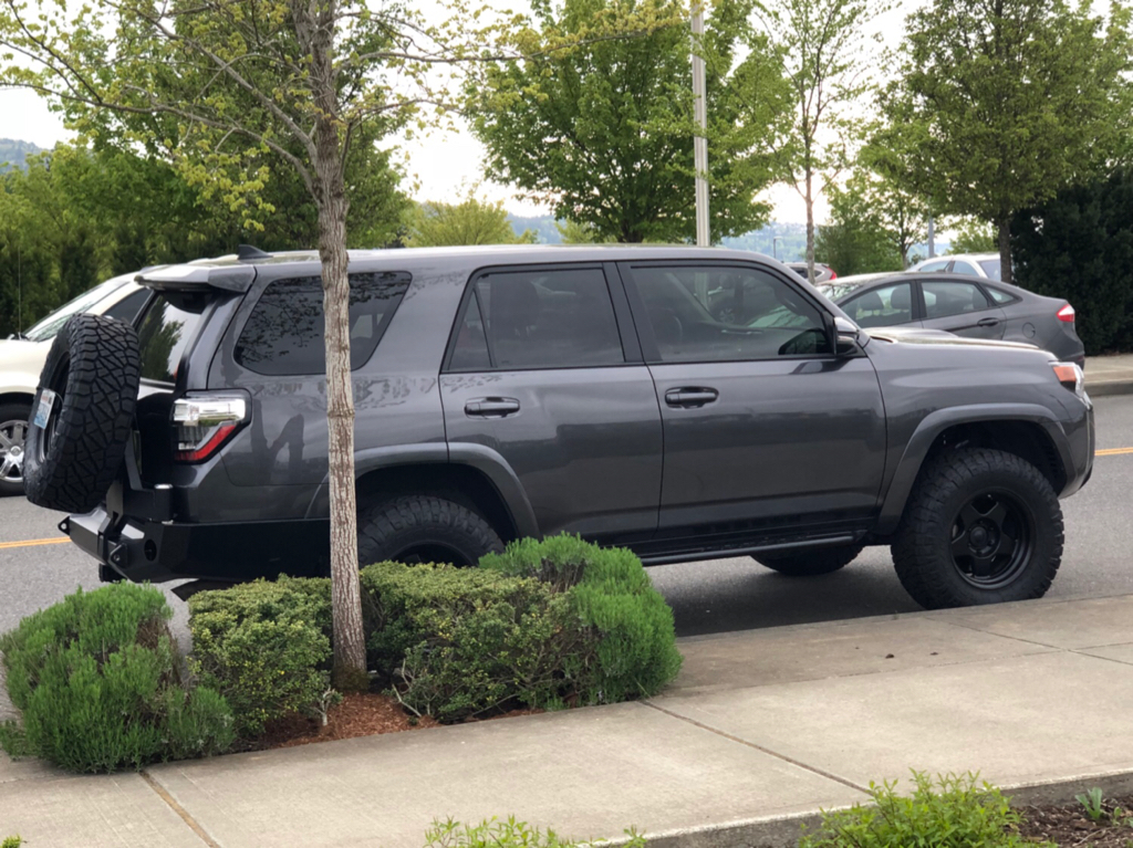

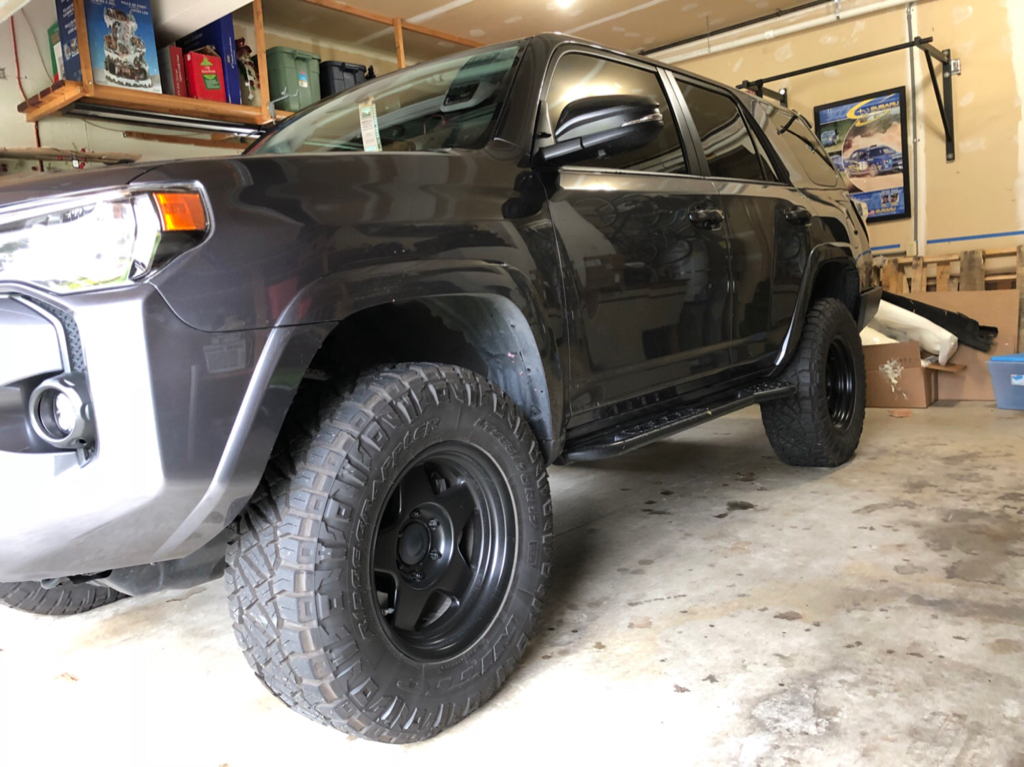

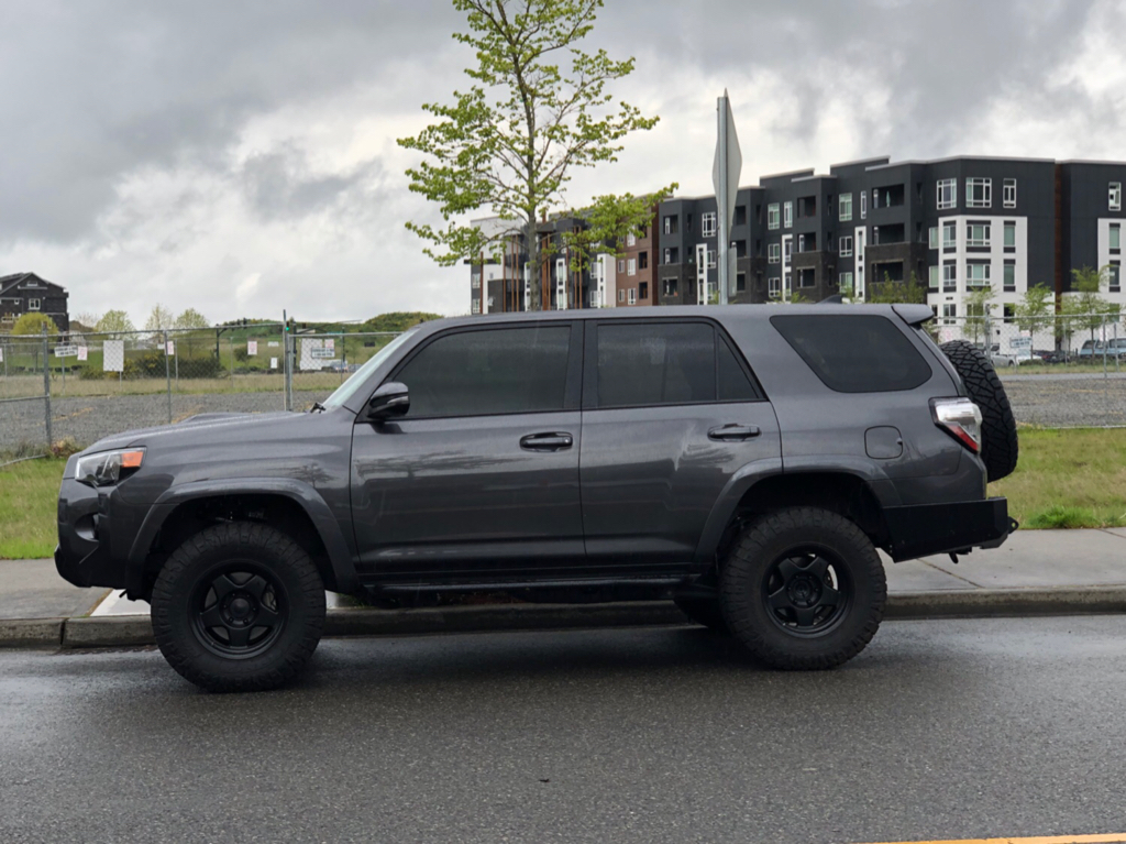

I lost about an inch in the rear with Wheeler's T-13 springs. I ordered some OME 895E, but am now second guessing whether to go with the 895S instead. Any thoughts?

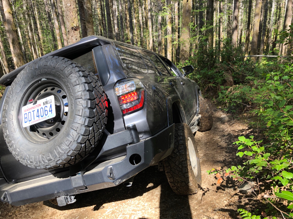

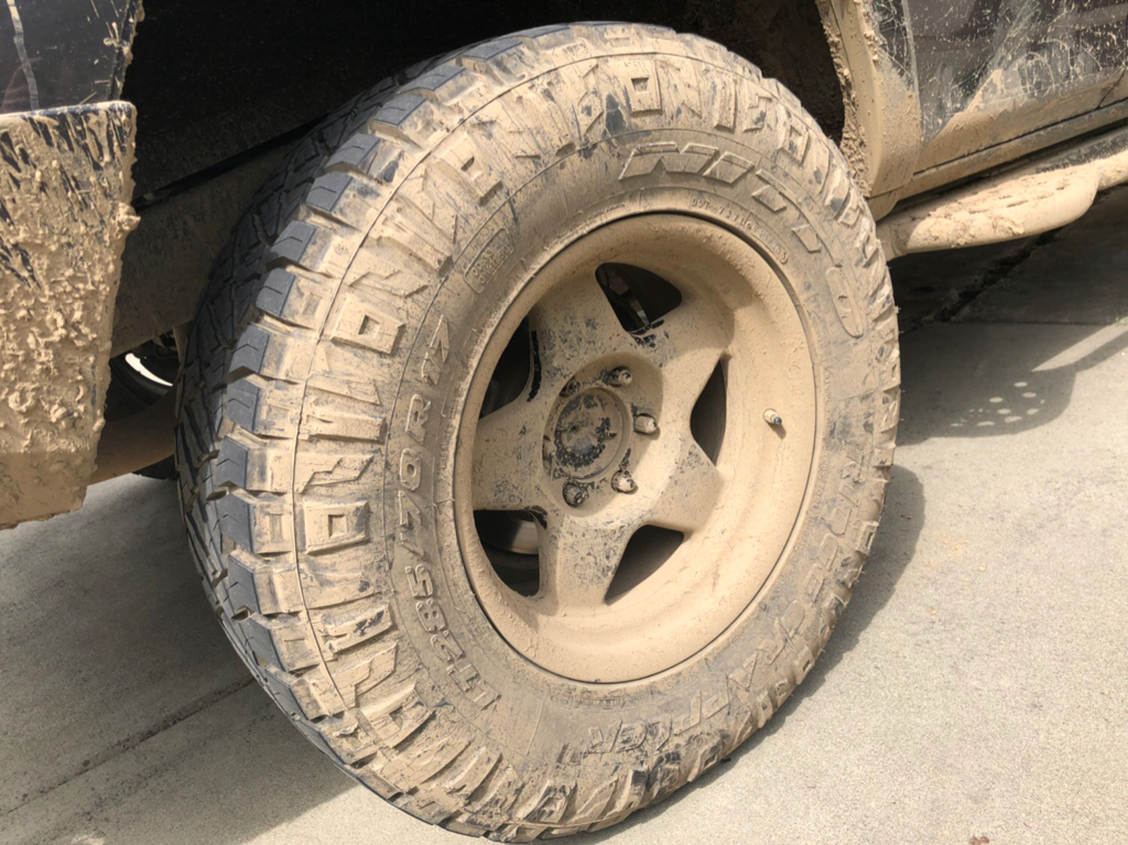

Adjusted the rear tire to sit closer to the cab. Much better!

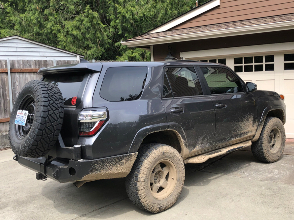

Threw in some OME 895E in the rear. I gained back the inch I lost so I am back to pre bumper height.

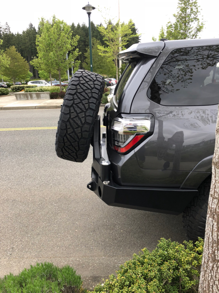

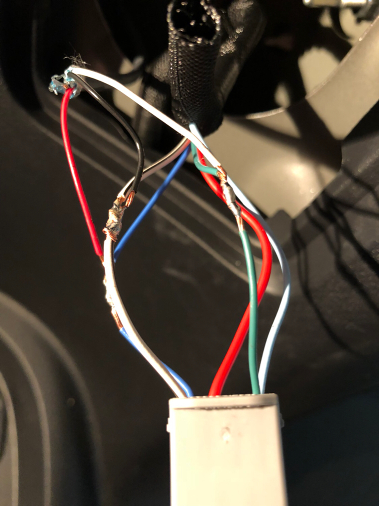

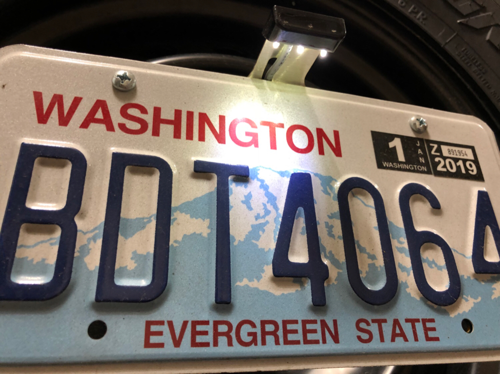

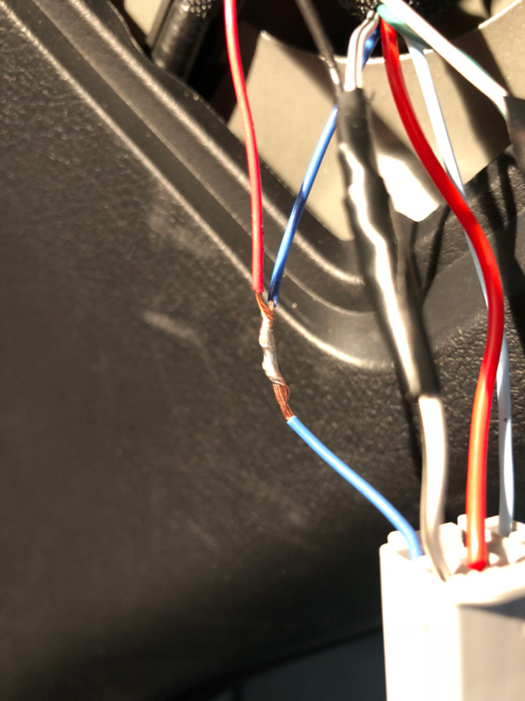

So I wired in my license plate light/brake light combo. For anyone wondering, if you are wiring into your taillight the white with black is ground, the dark blue is brake light switched,and the green is running lights.
