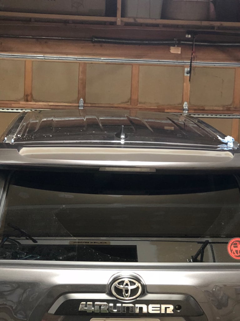

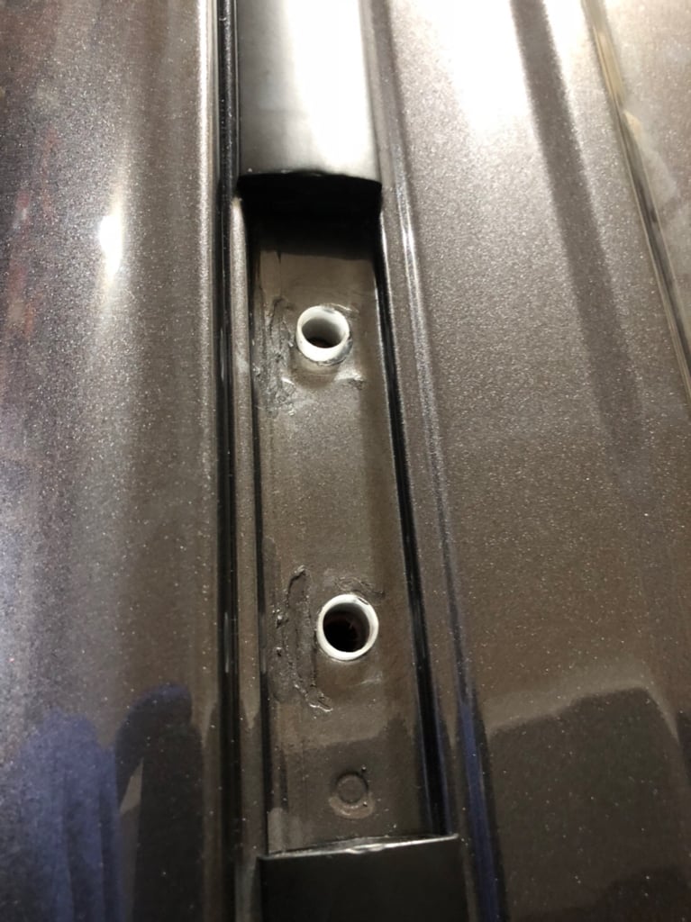

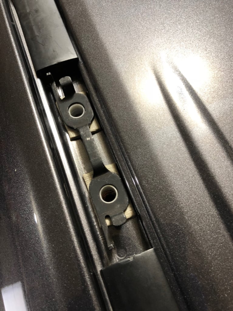

Part 1 of roof rack delete done! What a mess getting all of the sealant off from the Prinsu rack.

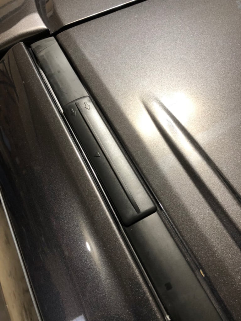

Buttoning up my rack delete today. Also figuring how I will mount my plate on the new rear bumper. I was originally going to go with a tire mounted system, but since my Maxtrax will be mounted there I may go this route:

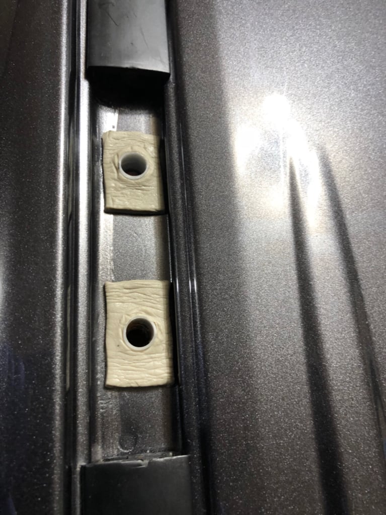

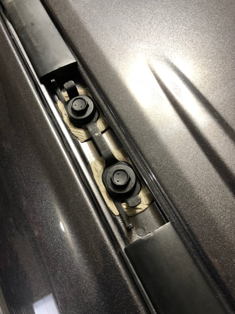

Here’s how I sealed my rack delete. I used RV butyl putty under the brackets and blue loctite on the mounting hardware. I then tightened the brackets down until the putty compressed out. I hope it stays water tight!

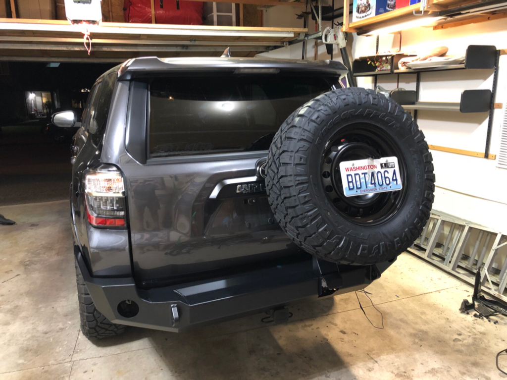

Small update: I returned the Curt hitch mounted license plate holder and purchased a RockHard4x4 unit that is meant for a Jeep. Just so happens that their kit is drilled for 6 on 5.5 as well! I ended up not liking the look of the hitch mount.

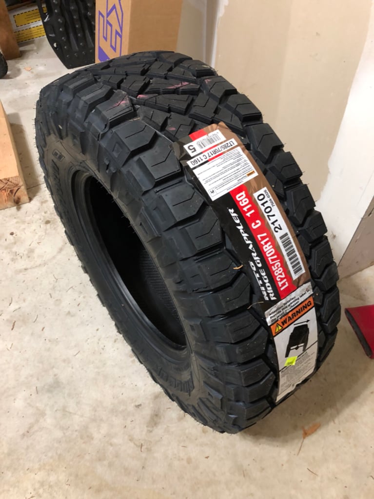

My spare tire showed up today! Now I just need to get my rear bumper on there so I can mount it!

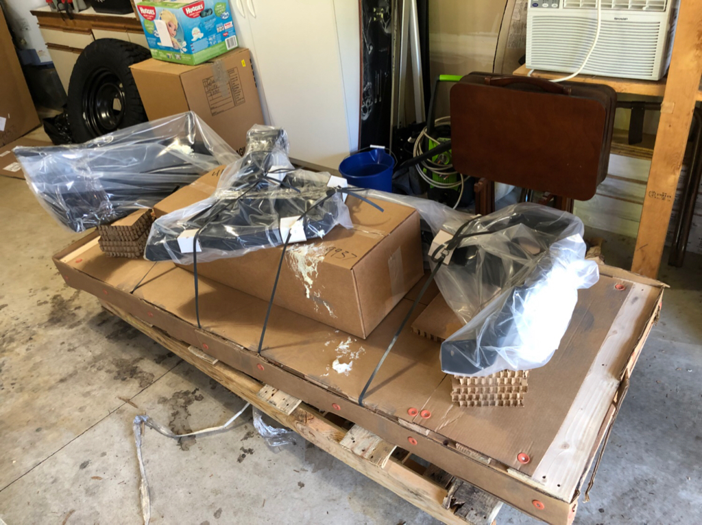

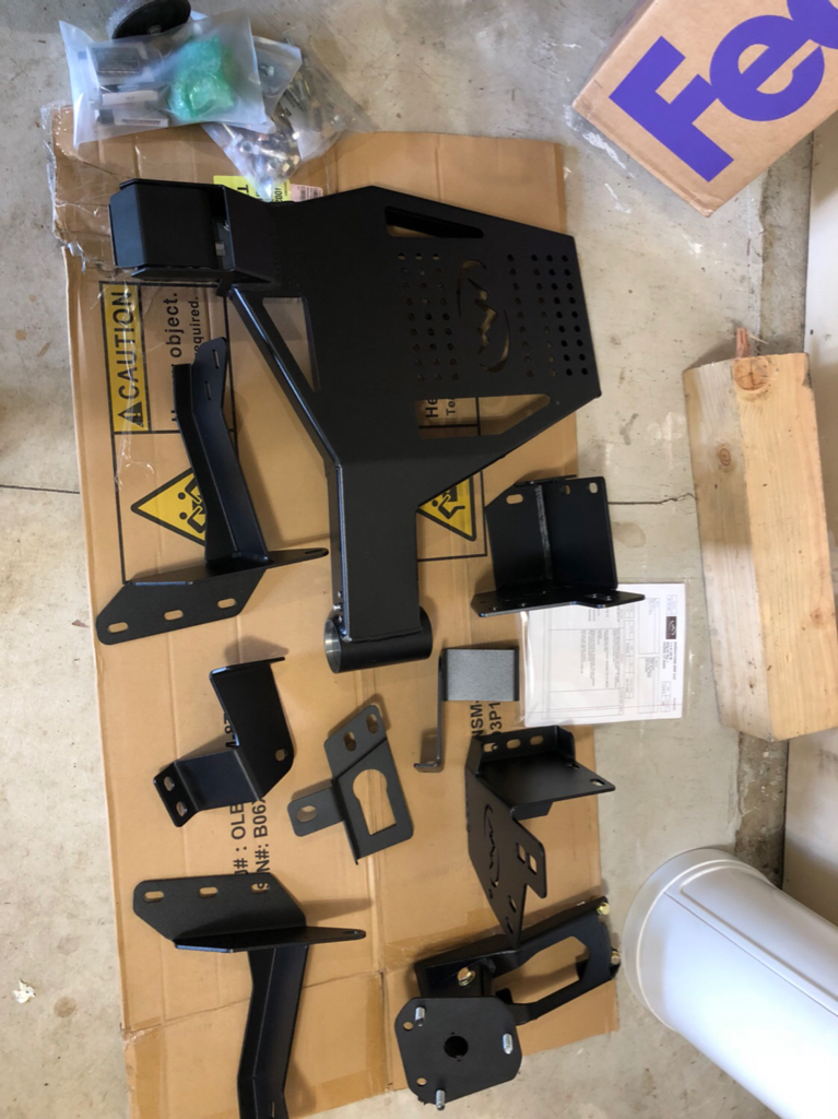

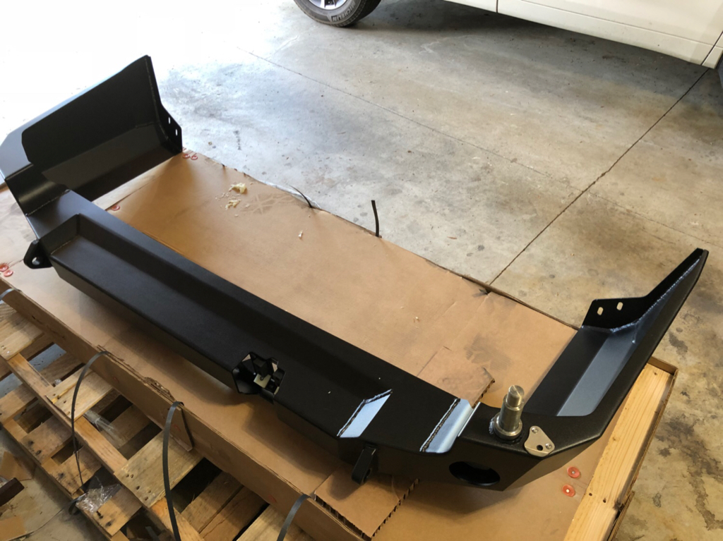

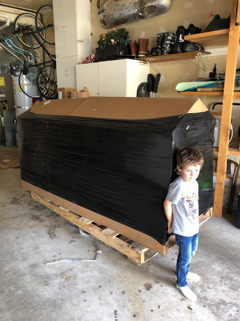

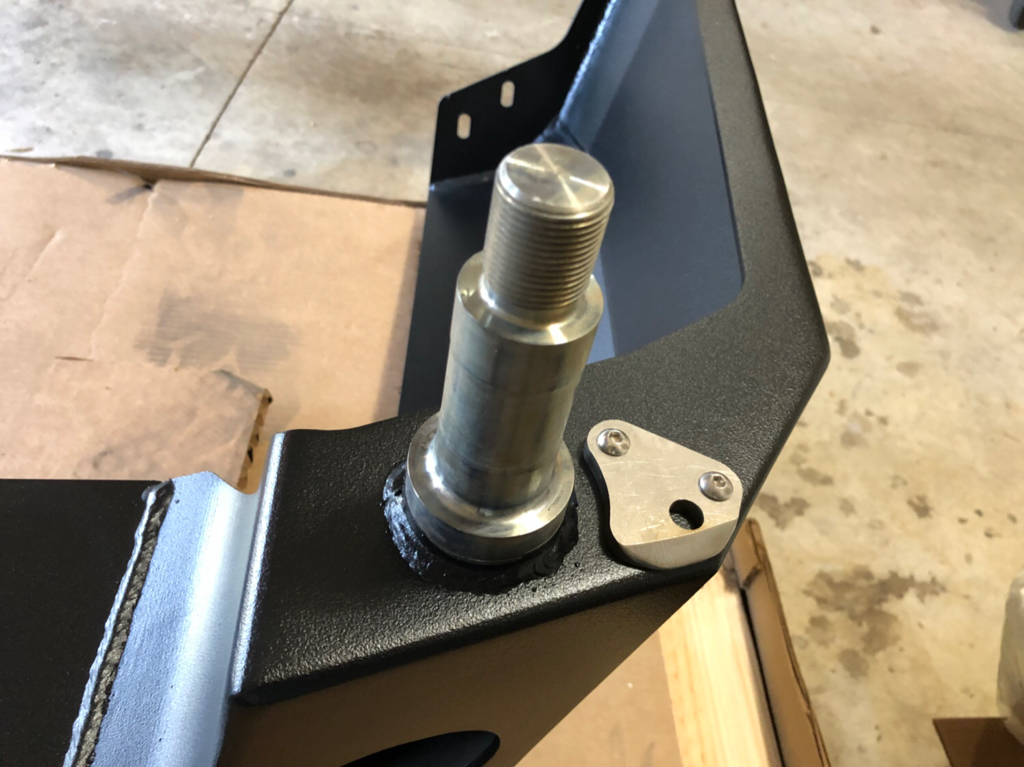

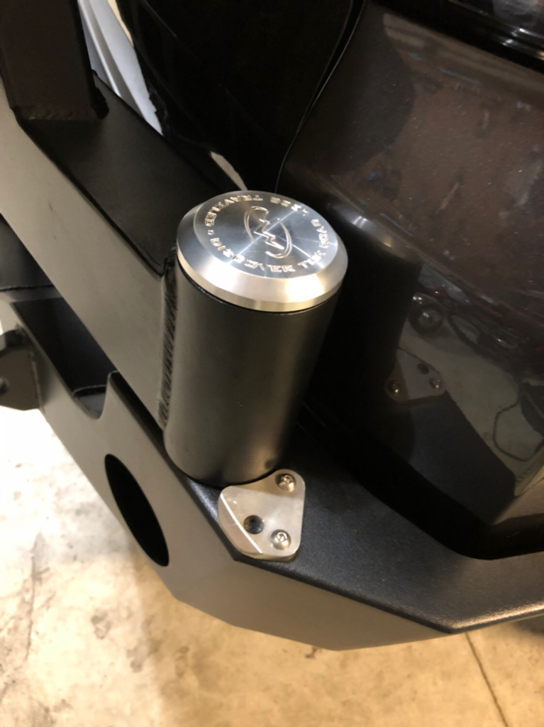

Unboxing! The quality of build on this bumper is very high.
Updates will come as the install progresses....

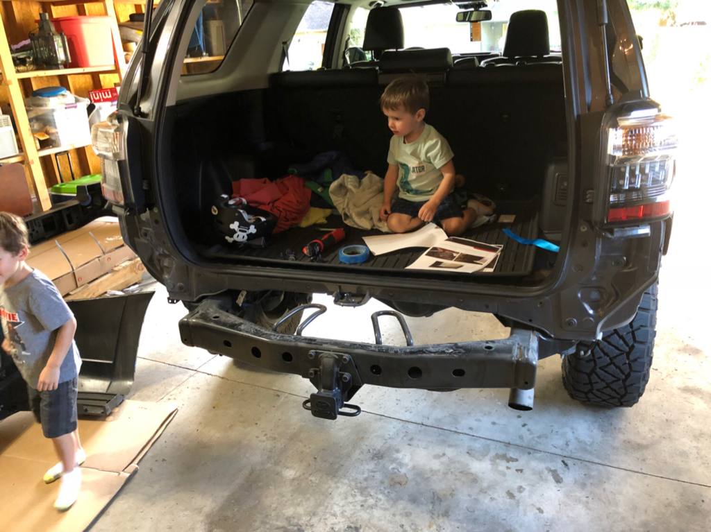

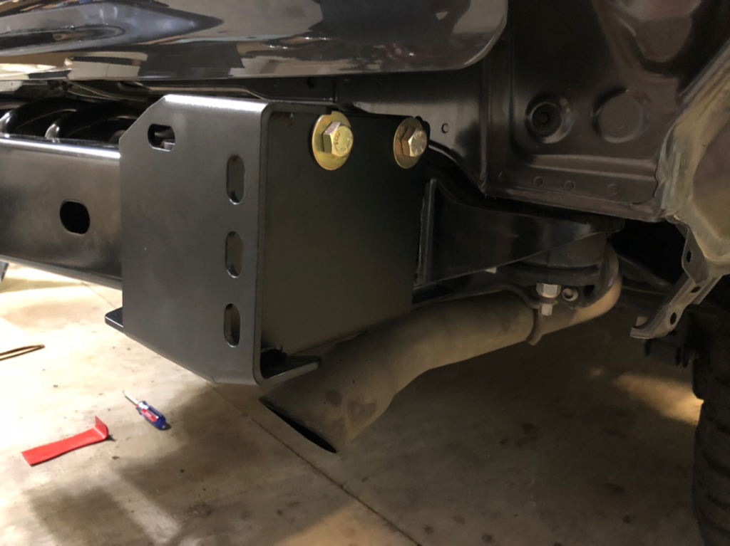

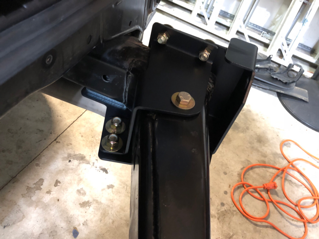

Got the internal brackets installed and hitch plug relocated. I just need to figure if I have enough wiring to do my license plate light. Overall install is simple, the provided directions and pictures are completely useless.

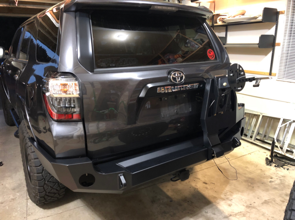

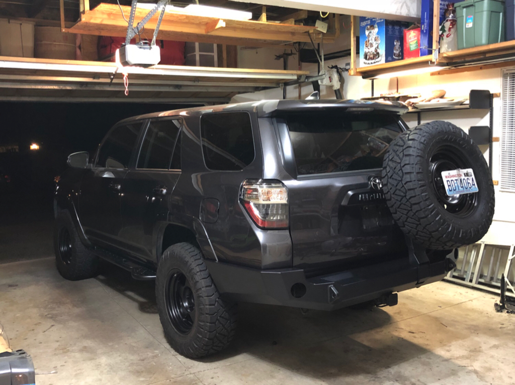

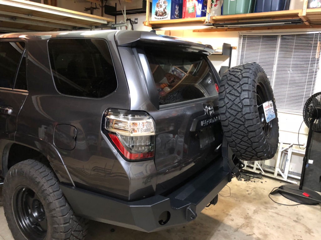

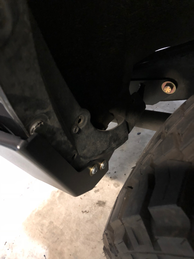

Bumper is on and looking great after some adjusting! I cut and repurposed the rear mud flaps to solve a common rubbing issue on the rear flare.
