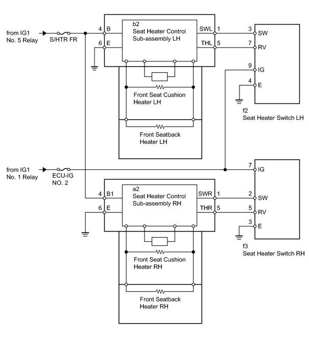

The driver side heated seat is not working in my 2016 SR5 Premium runner. The led light on the seat heater switch does NOT come on either. I pulled that switch hoping to swap with the passenger side to test but of course they are different so I can't test it like that. I have a new one on order because I am assuming it is a bad switch but I just thought I would ask if there is any other good way to test to see if it is indeed the switch that is the problem. I am definitely hoping it is as that is the cheapest option by far. Thanks.
Seen this issue listed on other posts and forums for the 5 and 4 Gen. Common issues people noted:
-fuse
-harness connector near switch or under seat
-relay to fuse
Any other items not working or just the driver seat? Any work done recently that you took the panels off?
