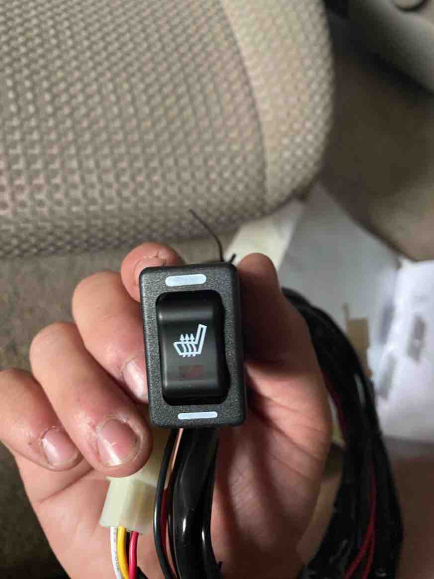

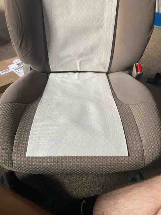

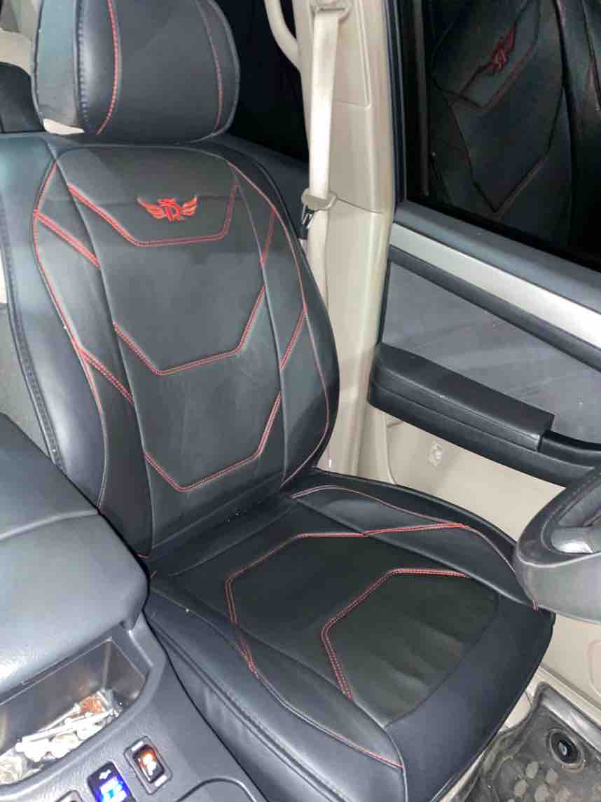

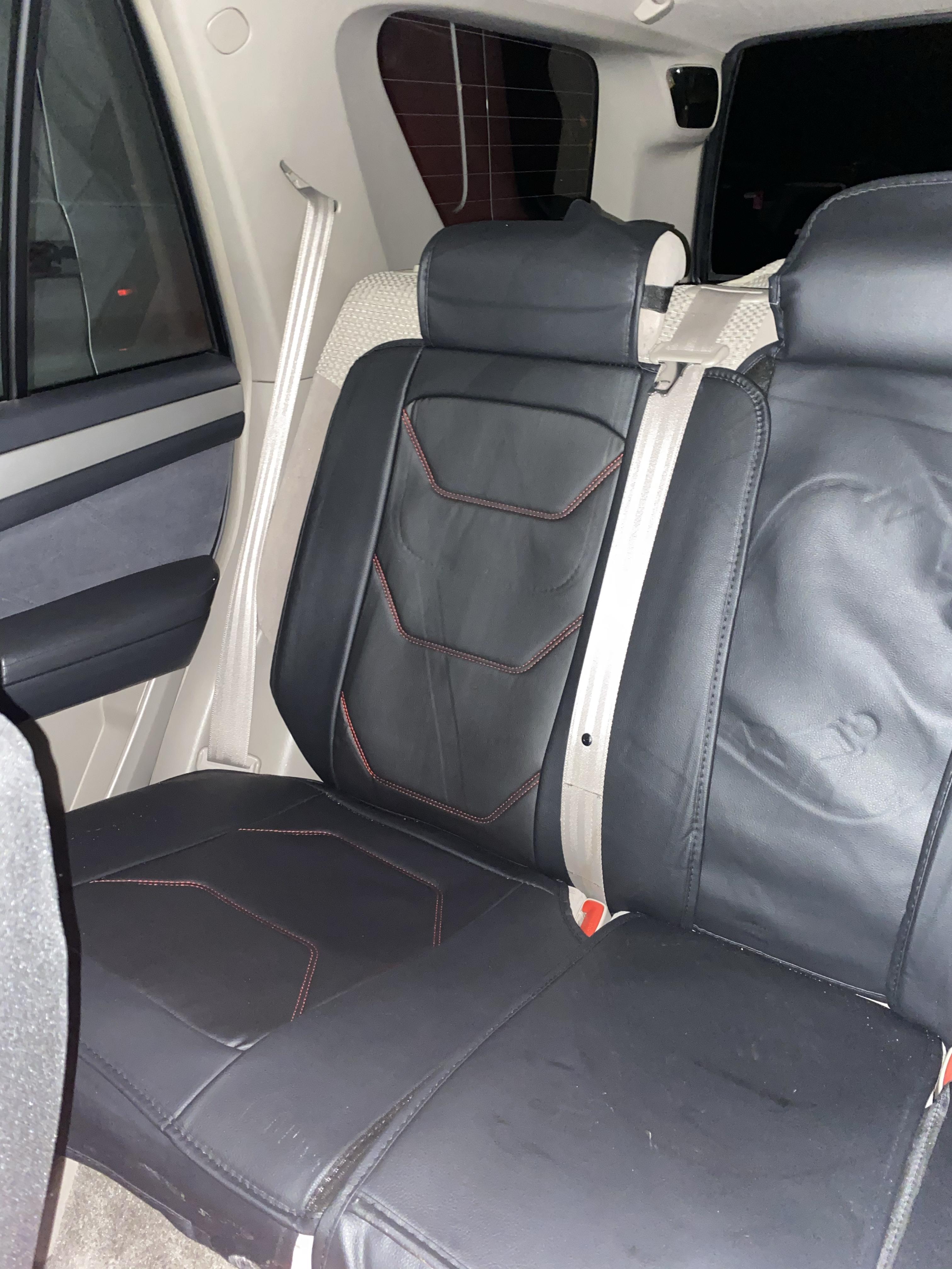

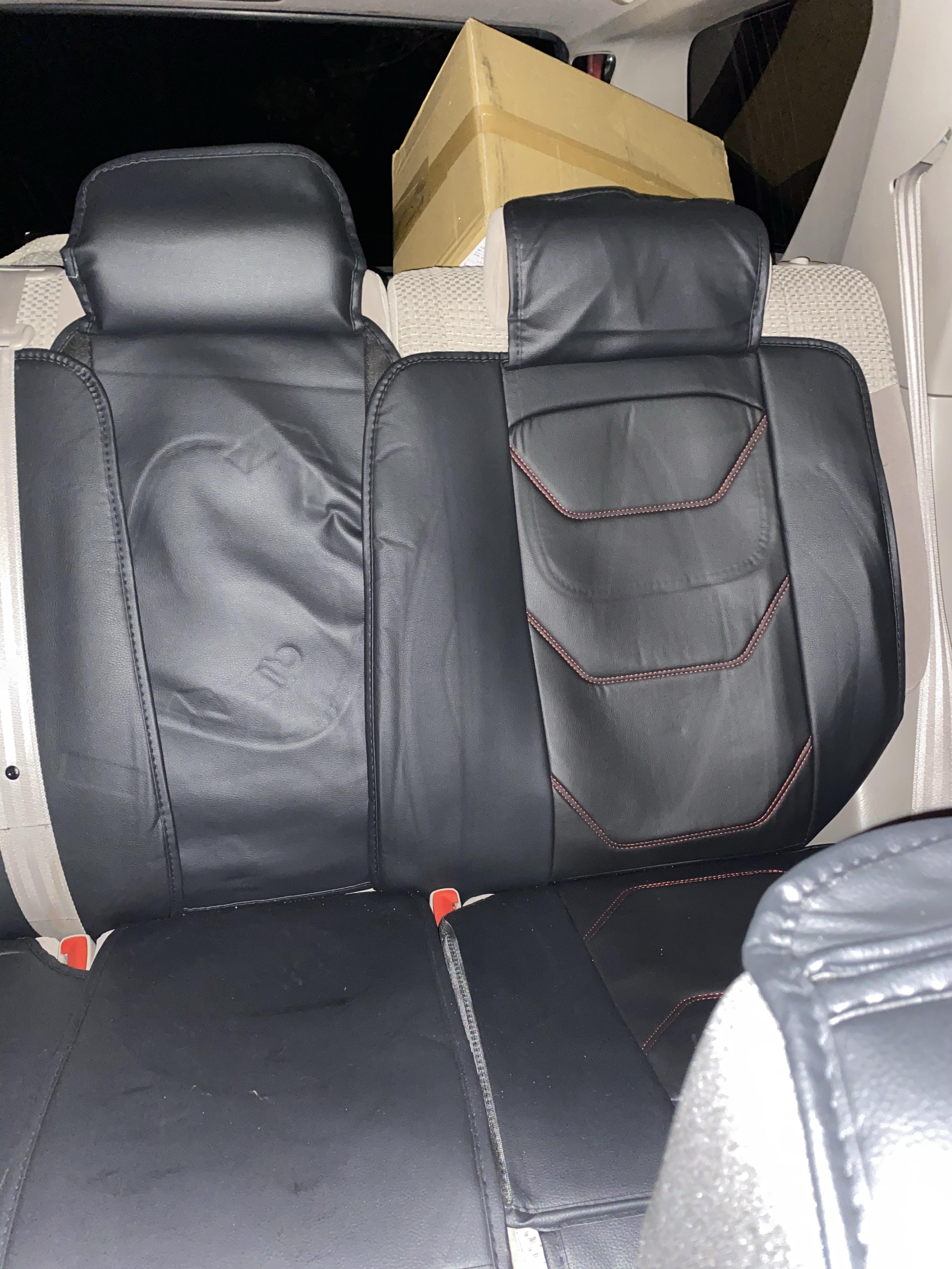

So the first thing I did was remove my seats, took them out, cleaned them up and inspected them to make sure they were nice and clean since why not, gotta keep things clean! Then after that I set up my heated seat pads and they come with double sided adhesive (which is surprisingly very strong and hold great.) lined them up and ran the power lines between the back bottom supports. After that I went ahead and installed my seat covers which are generic. Not made for the 4runner seats and for what they are, how they fit, and the quality them I Highly recommend! and also only 90 dollars for front 2 seats and the whole back row!. After that I went ahead and tapped into 2 new fuses I bought with this connector (used a multi meter to endure these fuses weren’t energized when car is off, but also they are energized when the remote start is engaged which is really nice when winter comes around, just have to switch the heated seat on when I get out of the car for the day, and the next day when I remote start toasty warm seats before I get in the car in the winter!
Advance Auto Parts - Down for Maintenance - Fuse adapter link

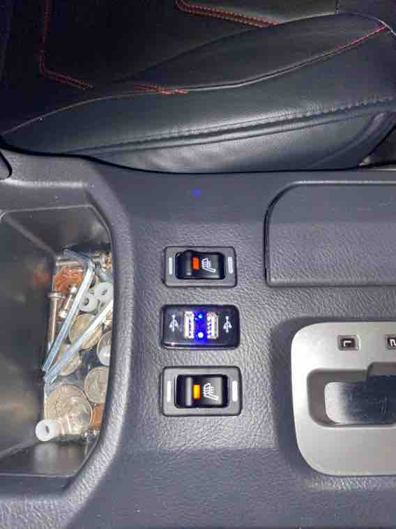

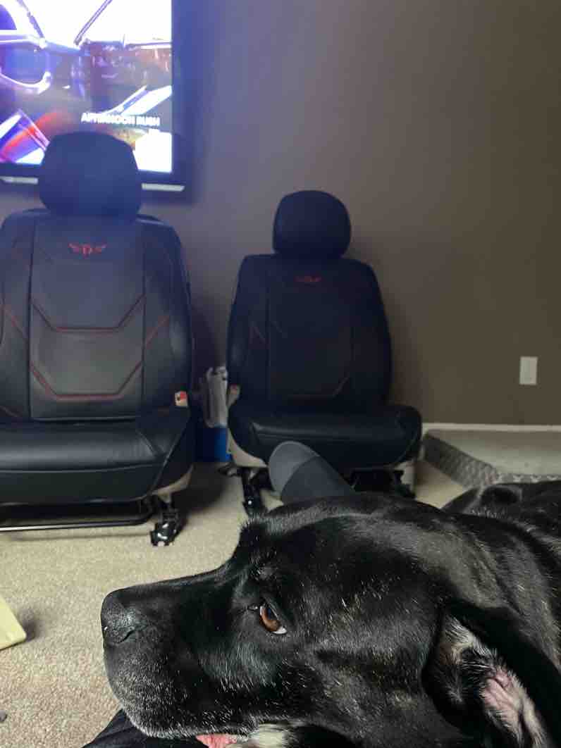

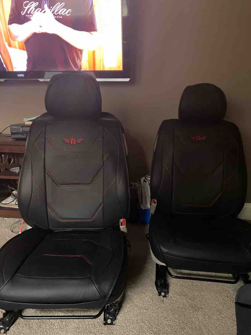

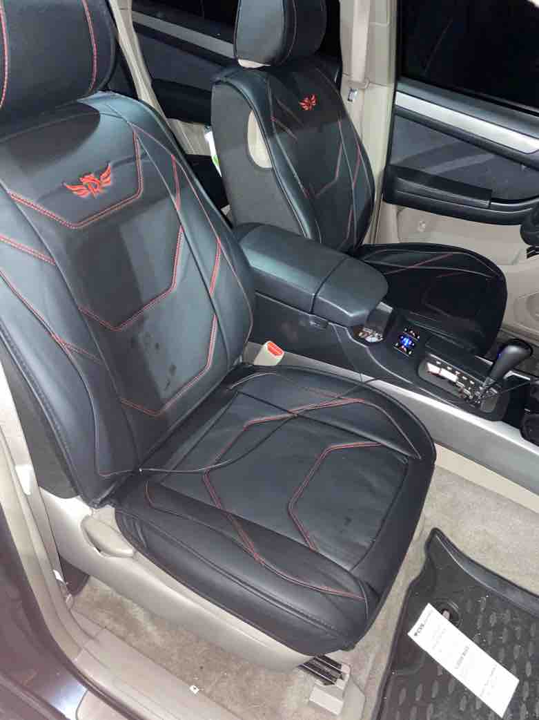

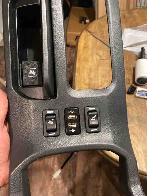

So I ran the 2 hot wires to the fuse box, and tapped into the ground on the cigarette lighter for easy access. Then routed the wires and zip tied so everything was nice and tight, nothing hanging or moving around. And after that we have to just fish the control wires to the bottom of the console to energize the heated seats! And that’s really the whole install, very easy and straight forward just need to take your time, and it also looks factory which I’m very happy about! The only thing I did run into is IF you do have the console with 3 holes and the DAC the switches won’t fit well in the holes. You’ll have to Dremel them wider (have to use a dremel regardless) but the console I’m talking about is the one I have, so the switch does not sit flush in the hole unless you wanna dremel the top leather like material but I chose not to, I chose to use hot glue and made them flush as possible, if I like the way they sit then I’ll use super glue in the future and have them set much stronger. Here are some pics of the install. Thank you!
