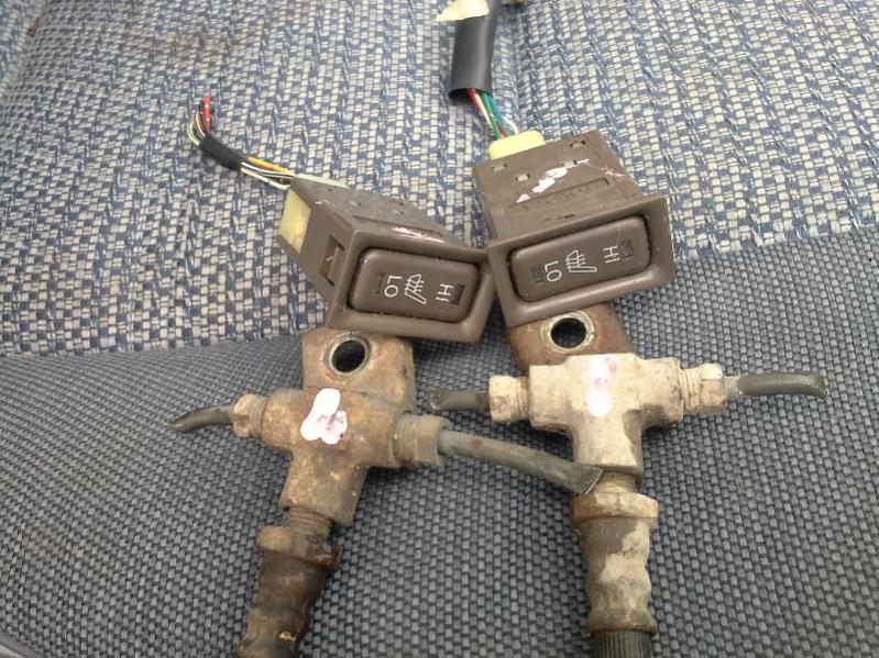

Look around the pick-n-pulls for a pair of Lexus LS400 seat heater switches. I got mine for like $4/each. They are high/off/low 3-way switches. When I recovered my seats I installed some carbon elements. It has been in the teens the last few mornings and I really need to get them wired up. I don't have any factory wiring so I am just wiring them up like any other accessory.
I think you can find them in black and brown. Don't mind the brake line fittings.
[MENTION=49152]jreask[/MENTION] are those both for the drivers side or is one for each seat. And is that the factory placement? Just curious because it seems odd that the passenger switch would be out of reach of the passenger.
Ya, I didn't like that either. I moved my rear window switch down, eliminated the glass breakage sensor, and put mine here.
These are the QX4 switches.
