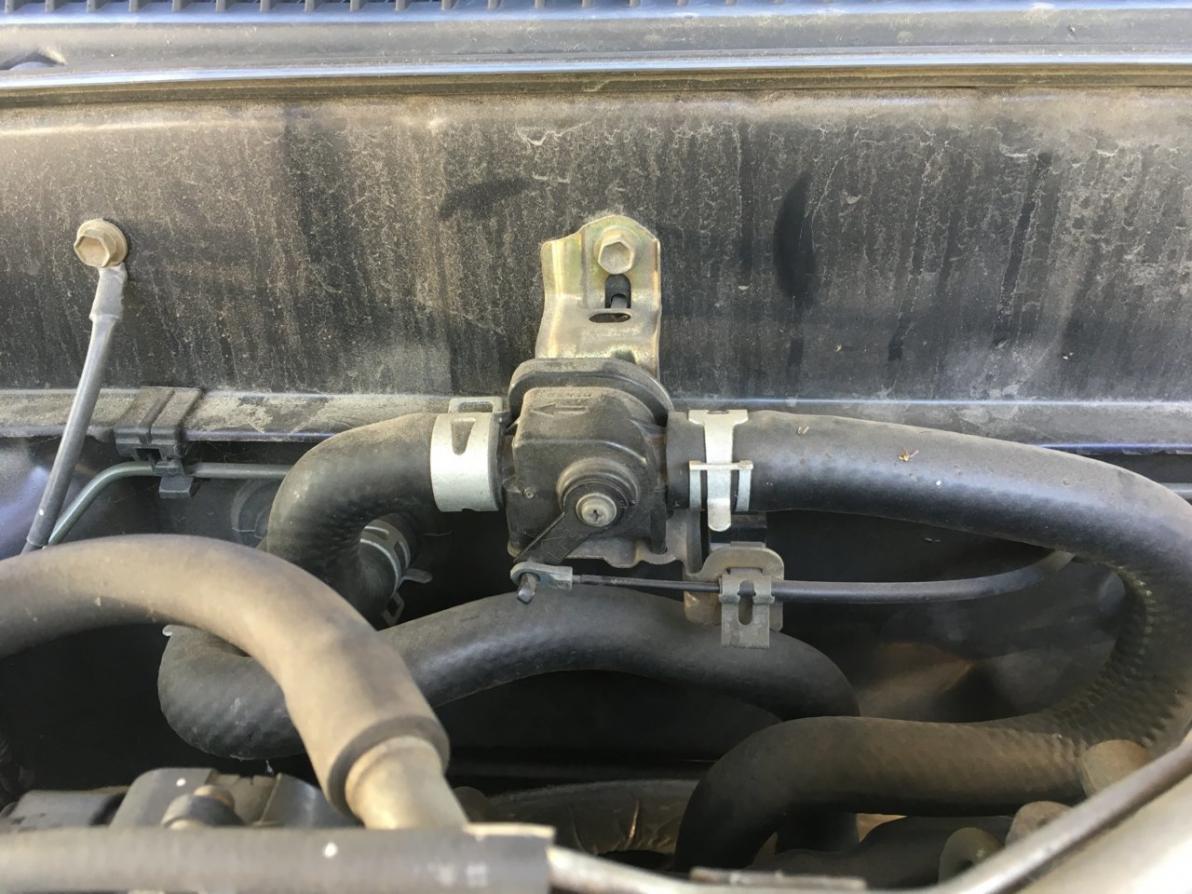

assuming your engine coolant temp is within the normal range i would suspect:
1. control cable to the valvle is loose thus not opening properly. you can tighten it up. i did mine but to over close the valve since it was not fully closes resulting in less efficiency when running ac.
2. heater core may be clogged buy if the valve opens it will unclogge itself eventually.
3. heater core maybe full of dust and dirt. you can check it with endoscope via mobilephone.

Is the heater control valve the valve on the center firewall?

Yes, smack in the upper center firewall.
