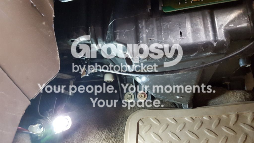

OUTSTANDING! i've been racking my brain for weeks over what this could be! you're awesome! THANK YOU!!! this is the cable that moves the valve and had fallen off of the black clip that holds it place:
